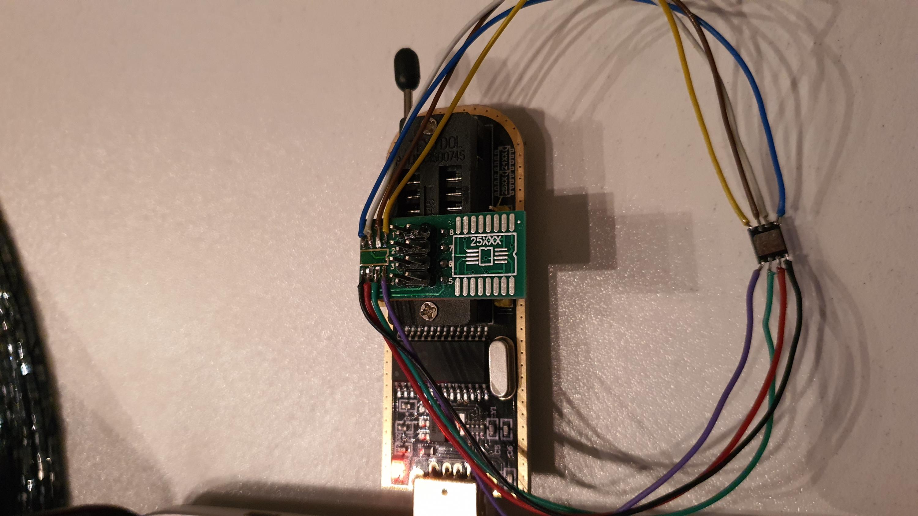

      Unock HP 850 G3
      Hallo,
      i bought a HP Elitebook 850 G3 with EFI Password Set. I have to remove the password.
      a) So I ordered expensive "Brand-New" BIOS Chip from ebay (biosservicecenter) to desolder the old and replace it with the new. Desoldering didn't worked with temperatures 250-350 Celsius. Laptop still worked.
      b) Then I soldered 8 tiny cables near the WSON8 chip, backed up the old BIOS with password and written the new (bought) BIOS to the chip still soldered on the motherbord. I did not erased the old chip content. I just "overwrite" it and confirmed by rereading. Hashes are ok.
      But since then, Laptop doesnt bring display on, fan at 100%, blinking lights. External monitor keeps blank. No HDD activity LED.
      My question to you:
      Is it ok to just rewrite the old chip without wiping/erasing it first?
      Attached the old BIOS with password (original):
      Can u please clean the password, so i can reflash and hopefully screen turn on?

        Re: Unock HP 850 G3
        Post the new dump
        • HP_850_G3
          • Oct 2020
          • 4
          #64
          Re: Unock HP 850 G3
          I was wrong, above u have HP 850 G3_with_password.zip === what i get frome the bios chip seller from ebay
          attached: Original with password

                    #69
                    Re: Unock HP 850 G3
                    HP BIOS unlock tool worked for me.
                    Just drag n drop oldbios.bin to unlocktool.exe to get oldbios_unlocked.bin, then flash to the chip.
                    Thank u!

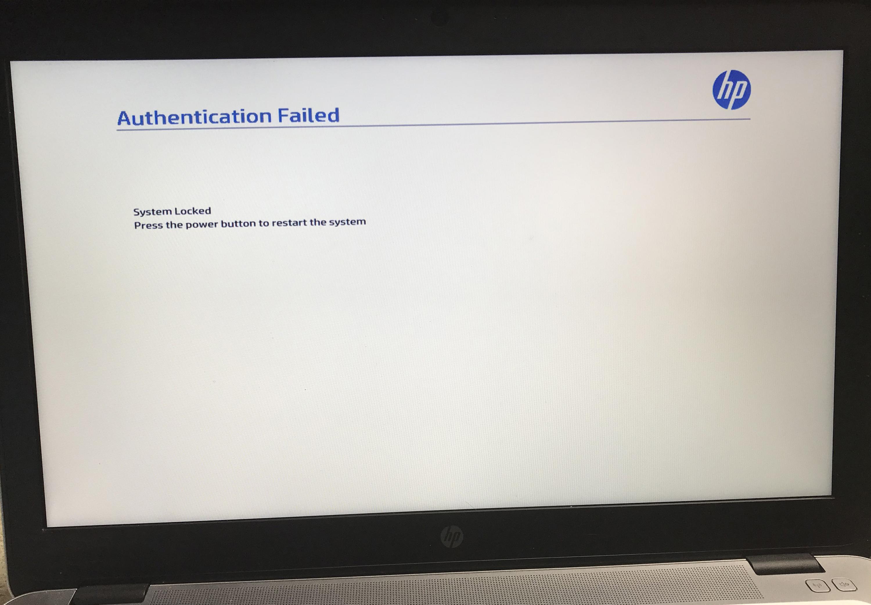

                      #70
                      Re: Bios password remove 850 G3 HP
                      Hello RethoricalCheese sorry for my late reply, but I've been testing and trying. I want to thank you so much for your support. the images worked more than fine. except for one little issue... after installing each image, the bios returned the following error:
                      System Locked
                      Press the power button to restart the system
                      I have unlocked few HP machines in the past, and there was not a big deal. but not these ones. anyway, your files got me to look into the images. and thanks for your work, because I found the string names I was looking for, but could not find any as string, but I did as a hexadecimals: 41 00 64 00 6D 00 69 00 6E 00 50 00 57. credits for this goes to peste, he guided me to download HxD and how to use it. Thank you so much guys. thank you again.

                        #71
                        Were you able to access bios at any point? If so, restore security settings and factory settings to clear rest of the stuff.
                        • 5chematic
                          • Jun 2019
                          • 77
                          #72
                          Yes, I was, thank you again, my respects, I really appreciate your help.

                                #75
                                Re: HP EliteBook 850 G3 Admin PW offset in .bin file
                                Yes, yours did worked, but I did get the: "System Locked Press the power button to restart the system" I talked in my other post. Then I took one of your images into HxD and learned how you did it. then based on your images I was able to remove the System Locked and was able to unlock all the other images. Thanks

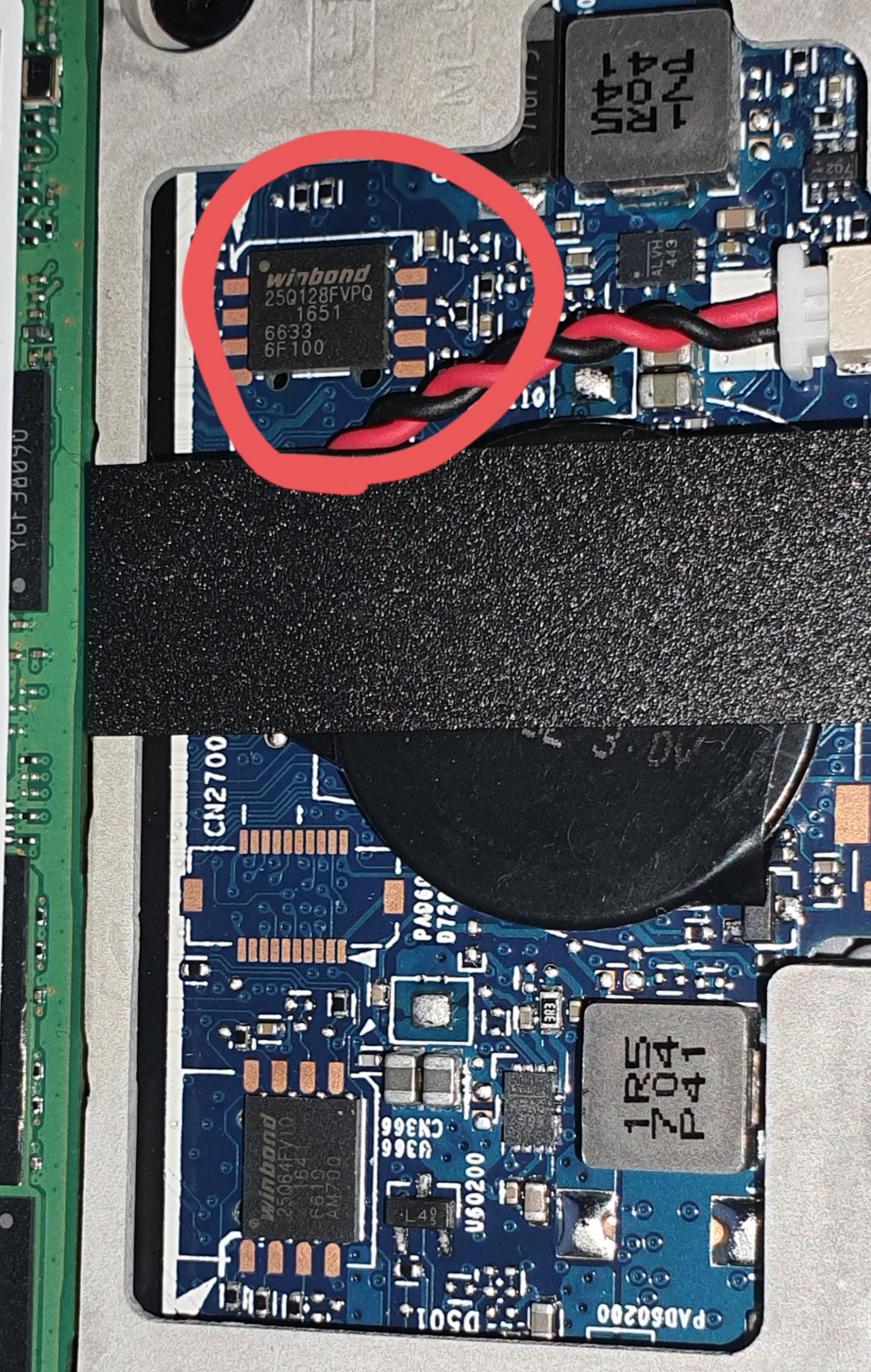

                                  #76
                                  please help with hp 850 G3 board 6050A2892401-MB-A01 windbond 25Q128FVPQ ADMIN PASSWORD PROTECTED i maked dump from the chip with CH341A Programmer v1.4 but i'm not sure of this dump is OK because someone on this forum helped to Unlock but not worked no screen no fan spinning only white orange leds blinking i tried many different bin files for 850 g3 still same results. last time used NeoProgrammer 2.1.0.19 there are some settings SREG but don't know ho to use it these settings.

                                    #77
                                    how are you all reading the BIOS from your 850 G3's? I have multiple different clips, a raspberry Pi, a ch341a...I'm having no luck at all getting a good reading.

                                      #78
                                      You need a power cycle. Remove battery, attach charger. Turn on laptop, go to F10 at the password screen. Turn off laptop using power button but do not remove charger. Connect programmer to chip and read, modify, write. After finished, remove programmer and charger. Connect battery and charger. Turn on laptop. Go to bios and reset security settings to factory default.
