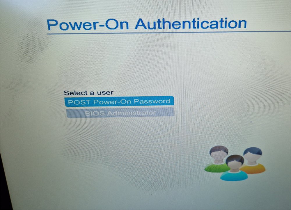

          HP Elitebook 850 G3 Power-On password
          I have a HP Elitebook 850 G3 laptop, that gives me a Power-On Authentication message when starting the laptop (see the picture for details).
          The owner of the laptop doesn't know the password anymore (I'm certain the laptop is not stolen!).
          I have read the content of the W25Q128FVPQ chip and uploaded it also.
          Can somebody remove these passwords, I have tried it with the instructions, but did not succeed (lucky I have a backup file).

            Here's your Unlocked BIOS, when the laptop start go to BIOS menu and disable security options (Default).
            If the Password still present, look for another 16MB chip and upload it's content here.

              Go to security tab and restore factory settings.
              Try than replay

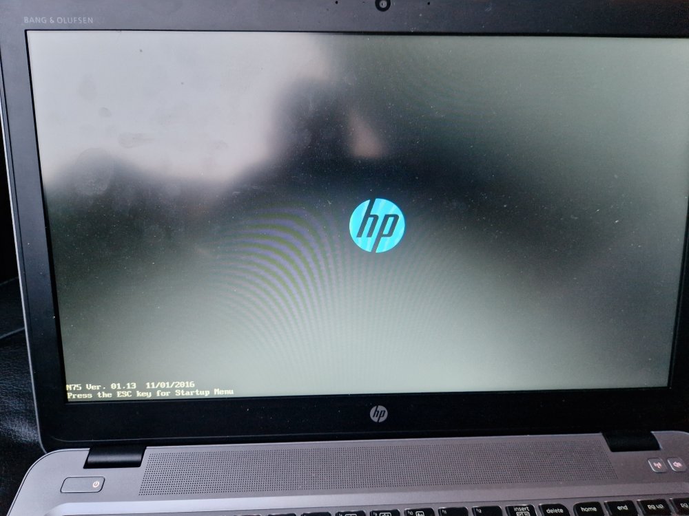

                I have used your unlocked file, but the system does not respond when pressing on F2 or F10 (this should be the key to enter the bios).
                External keyboard and onboard keyboard the same behavior.

                  Try this one. You need to press F10 key to enter the BIOS Menu for HP devices.
                  If the problem still exist, try to disconnect any peripherals and use only an external keyboard.

                    Unfortunately, still the same issue (posting).
                    I have removed the board from the laptop, and it's only the board with the LCD attached and the power button pcb with external keyboard.
