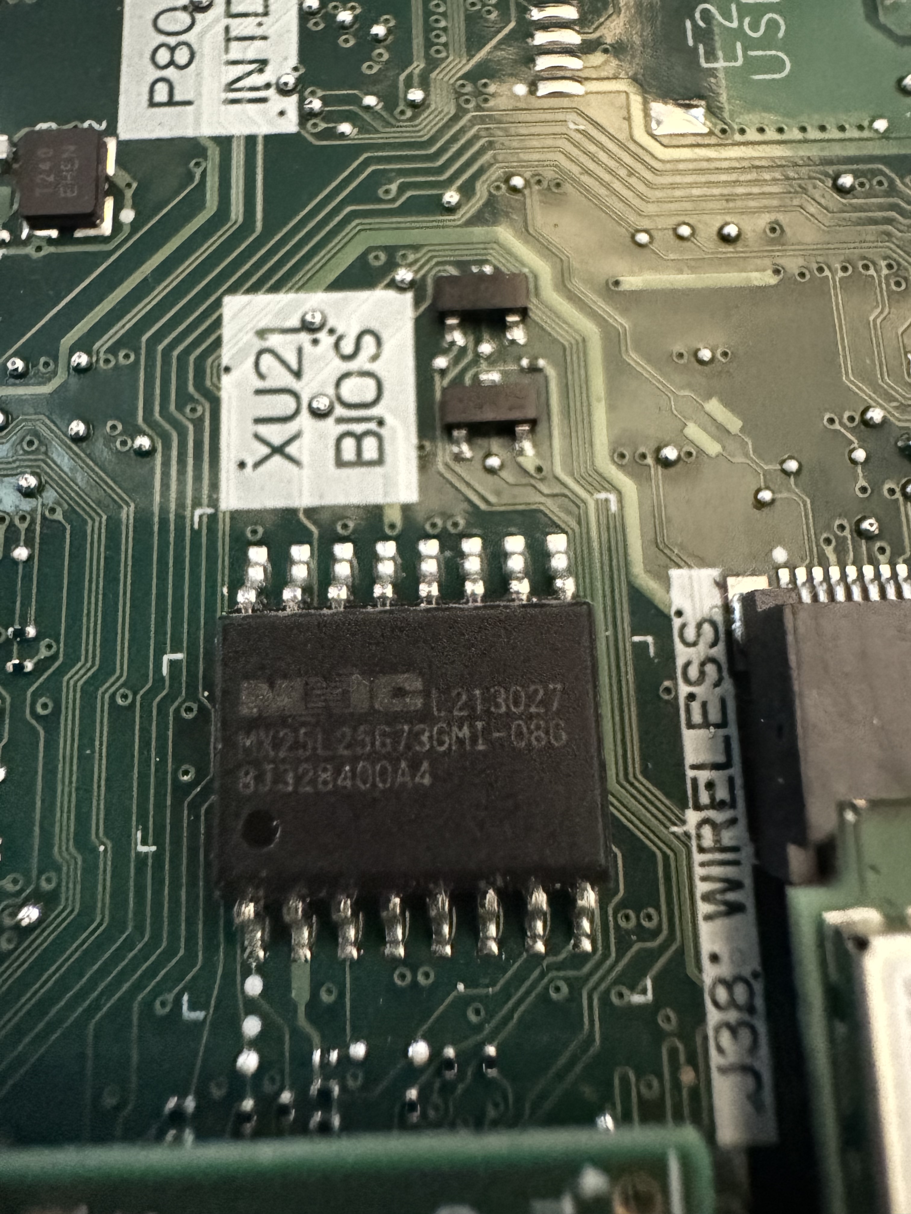

    I am trying to remove a BIOS password from this machine:
    HP ProDesk 400 G6 Mini
    but so far I still have no success.
    I bought CH341 programmer and decided to give it a try.
    The programmer came with 8 pin cables and connectors or whatever everything else is called so I had to buy a new 16 pin cable because the chip which I think is the BIOS is with 16 pins..

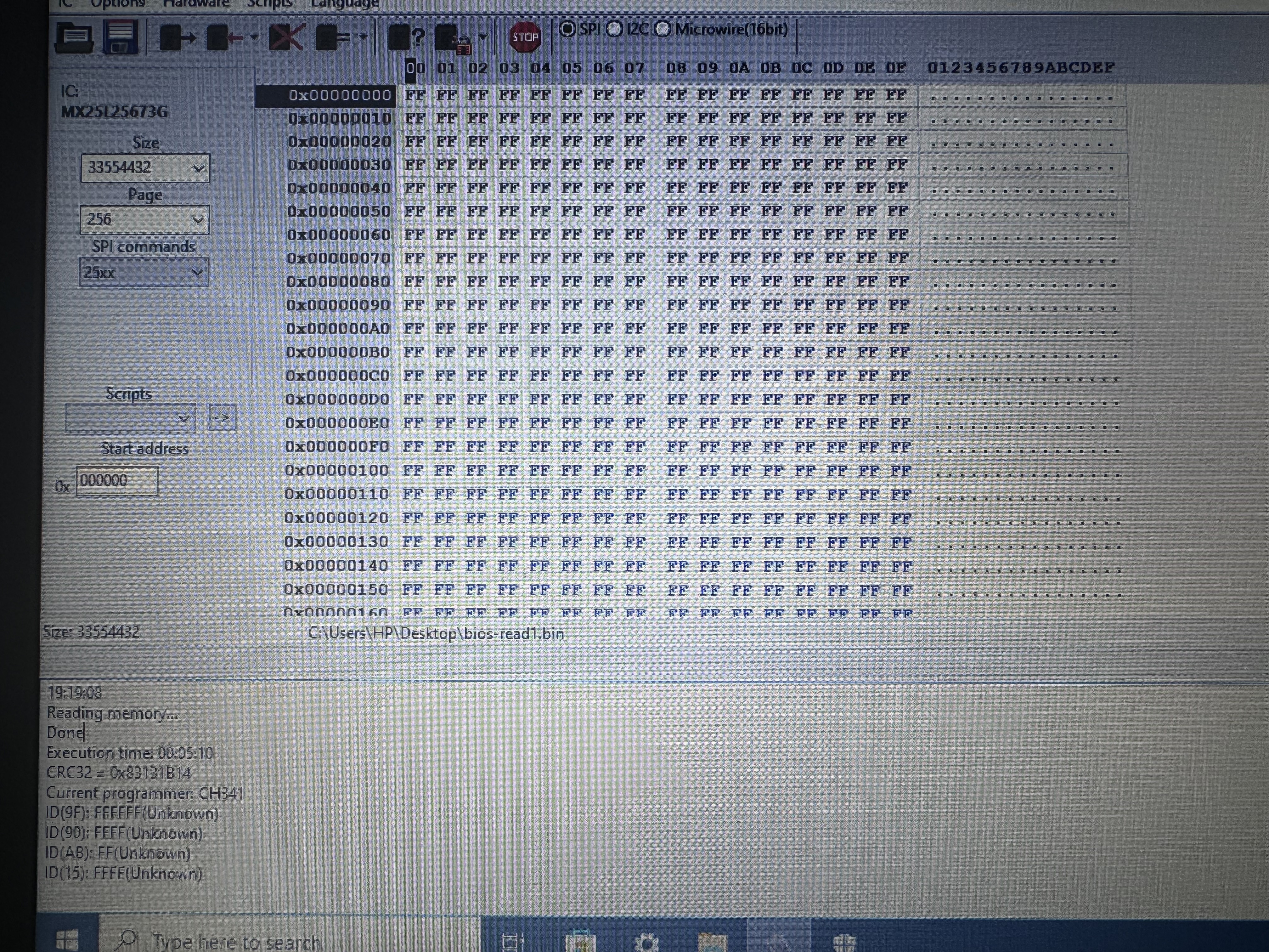

    I connected everything and downloaded AsProgrammer and NeoProgrammer then installed drivers for them. Tried both and still couldn't read the BIOS.
    My first try was without the cmos battery both software were showing no connection. I put the battery and no difference.
    Then I started to change the cable positions, to rotate ch341 sides then the side of the bios chip, played around thinking maybe doesn't do a good connection even if it looked solid, so tried multiple times.
    Tried different usb ports. And the last thing I tried was to try different drivers for the AsProgrammer “pak” version.
    Now there is hopefully a step in the right direction because doesn't show no connection error anymore but it's stuck on “check settings “ and few lines showing ID(9f)(unknown).
    What I assume with my lack of knowledge is that it reads the chip but doesn't recognise it?
    The last thing I did i was happy for about a minute that I did it was to manually select the chip, then clicked to read it and after it read the chip, everything was empty "FFFFFF"

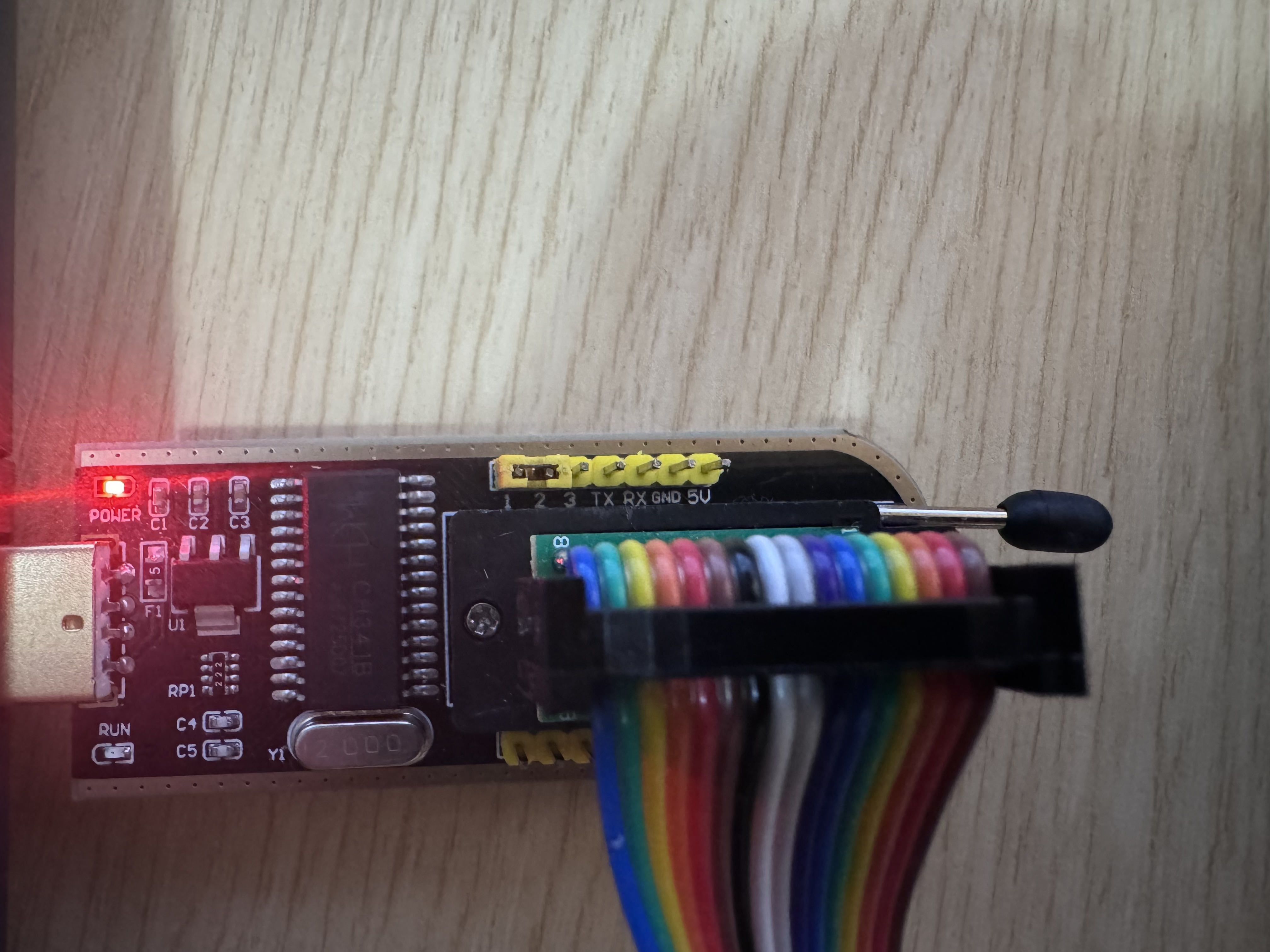

    Also should I do any modifications to the ch341 programmer? I see there are few pins and a jumper on 1&2 ?

      First : do not rotate cable and/or connections to the programmer´s socket, or you may burn the chip, the programmer or boty. Check the pinouts, and see if things are connected correctly.
      Then try with any other bios chip, to determine if your setup is working correctly. If with a chip out of the board ( connected only to the programmer ) things work, then maybe you will need to dessolder the chip from the notebook board to flash it.

          File is corrupted , read chip again.

            Hmm. Is it possible to be corrupted because of the archive?
            Also I don't have in the list of IC the same chip: GD25B256DFIG
            I am reading it as:
            GD25LQ256C-1.8v with AsProgrammer 3.15 -> 32.0 MB
            GD25LQ256C-1.8v with AsProgrammer 2.0.4 -> 32.0 MB
            GD25Q256 with NeoProgrammer 2.2.0.10 -> 32.0 MB
            GD25B512ME with NeoProgrammer 2.2.0.10 ->64.0 MB

              The files in your archive are all crap.
              Please look up the Datasheet to see how many vol your chip has.

                    Okay quick update, I rewired the cables with the Ch341A and the chip so should be okay or at least no the same results as the previous because now the positions are different.
                    • BIOS Chip Pin 2 (VCC) -> CH341a Programmer Pin 8 (VCC)
                    • BIOS Chip Pin 10 (VSS) -> CH341a Programmer Pin 4 (VSS)
                    • BIOS Chip Pin 7 (CS#) -> CH341a Programmer Pin 1 (CS)
                    • BIOS Chip Pin 8 (SO / IO1) -> CH341a Programmer Pin 2 (MISO)
                    • BIOS Chip Pin 15 (SI / IO0) -> CH341a Programmer Pin 5 (MOSI)
                    • BIOS Chip Pin 16 (SCLK) -> CH341a Programmer Pin 6 (SCK)
                    • BIOS Chip Pin 9 (IO2) -> CH341a Programmer Pin 3 (WP)
                    • BIOS Chip Pin 1 (IO3) -> CH341a Programmer Pin 7 (HOLD)
                    I will upload only the GD25Q256 because is the closes one in NeoProgrammer. I hope this one works.
                    Will attach an archive and a link just to make sure my archiver doesn't corrupt the file.
                    Serial No: 8CC1270DH6
                    Product No: 47L40EA#ABZ
                    Thanks in advanced and hope this time I am a bit closer...

                                All 3 files are not ok. Click image for larger version  Name:	2024-07-17 09_20_22-Settings.png Views:	0 Size:	394.1 KB ID:	3310604 Click image for larger version  Name:	2024-07-17 09_25_21-Settings.png Views:	0 Size:	309.2 KB ID:	3310605
