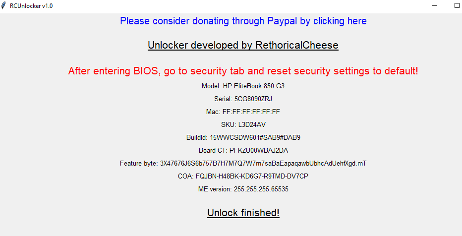

                      Hello friends
                      Im here to ask help to clean ME and remove password from a working bios.
                      My only problem is i cant Enter setup bios cause have password.
                      HP Eliteboot 850 g3
                      chip: 25q128 (16mb)
                      sn: 5cg8090 zrj
                      SYSTEM BIOS N75 VER 01.24 01/30/2018
                      thanks

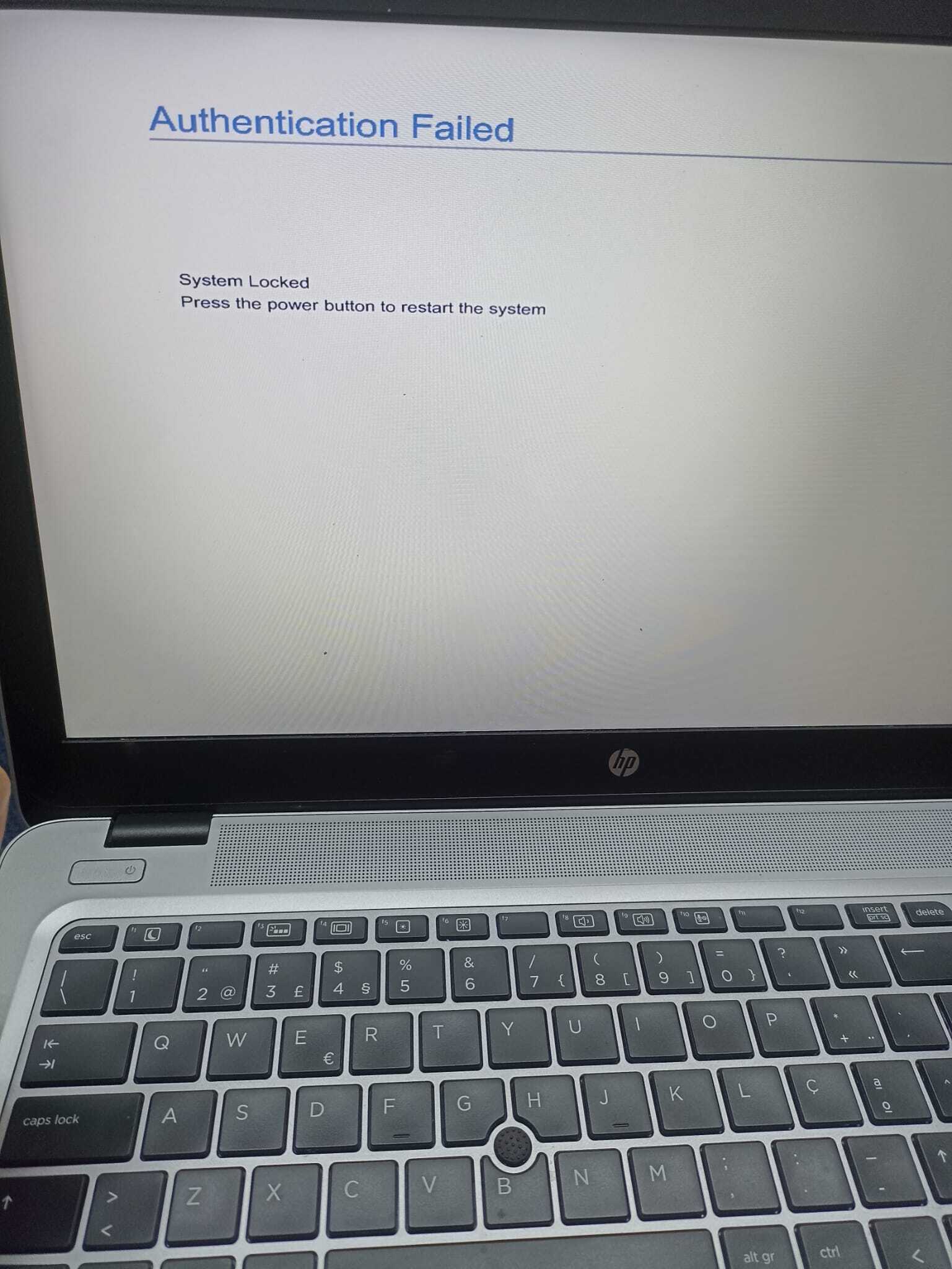

                      So. i did it.
                      1st USED DRAG DROP this file for rcunlocker.
                      file gerated:
                      850_g3_n75_unlocked (attached)
                      2nd programmed with ezp2019+
                      3th soldering
                      ​4th pc powers on with error: Authentication Failed.
                      cant do f1 ou f2 or f11 or del.
                      any help please? i user 25q128 (16mb flash)
                      All Help apreciated.

                        Try

                          hoaca388​ thanks for that bios but unfortunately power on, bakligcth keyboard light, fan runing at maximo and no video.
                          • hoaca388
                            Badcaps
                            • Jan 2022
                            • 11840
                            #136
                            You load the original bios to see if the old symptoms still appear.

                                  so. i solve my problem without use you bios (thanks anyway). my problem was my programmer. i used ezp2019+ to read and flash. but after you bios also my old bios none working. no video.
                                  so i try using another programmer (MiniPro Programmer) and work perfect. thanks anyway.
                                  so, RCUnlocker_v_1_0 work perfect for unlock bios
