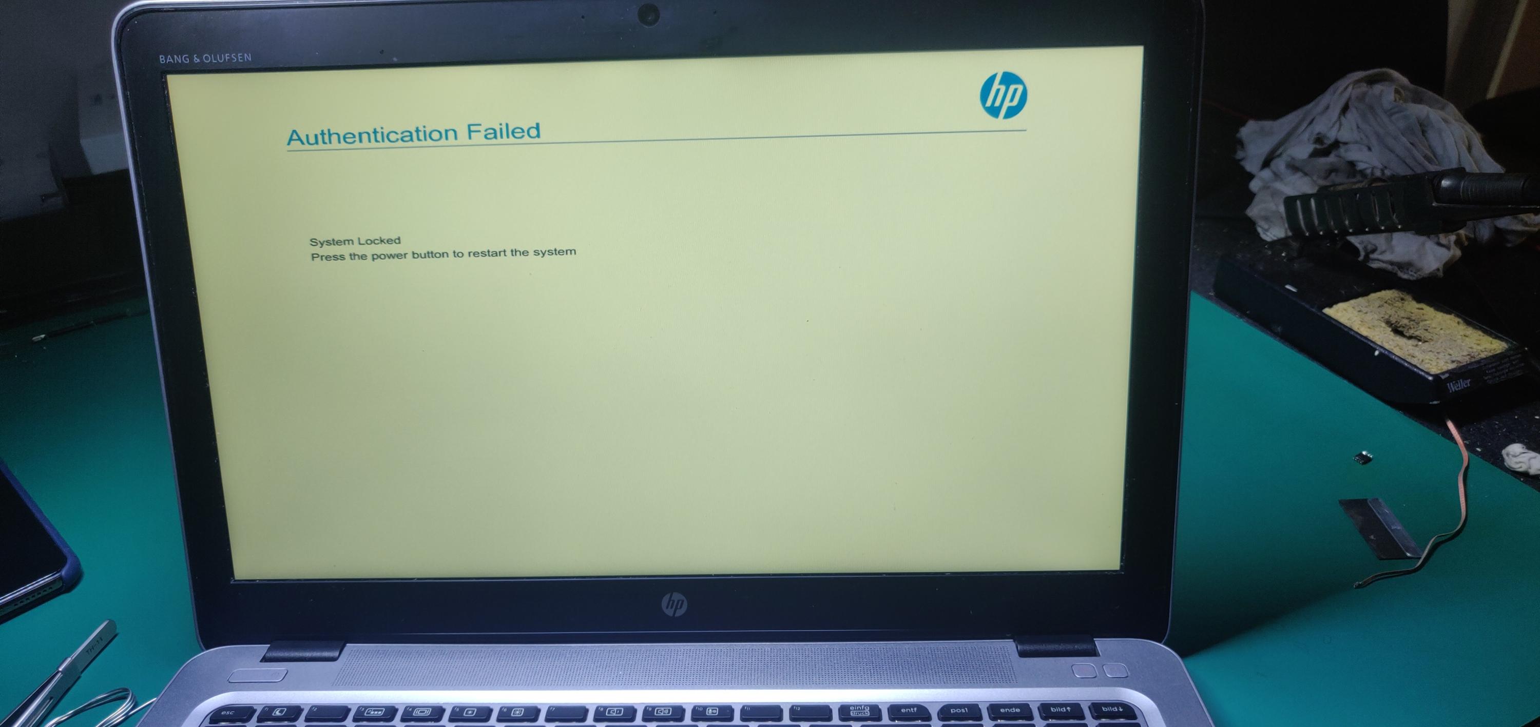

      Can you pls help me?...i need to reset the bios password...
        try this...

              Originally posted by eikspaj
              try this...
              Thank you ,I tried it but it's not working 😭😭

                    #29
                    Re: Bios password remove 850 G3 HP
                    try another.....
                        try another.....
                        Thanks you so much man!!! It's working perfectly naw!!!
                        Sry for the delayed response but today i made it.
                        THANKS FOR ALL OF YOU THAT TRIED TO HELP ME!
