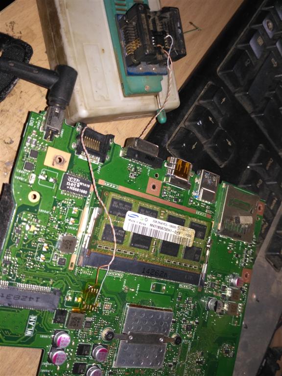

    Xeltek superpro 500p is 3.3v. You will need a 1.8v adapter to program it. Just search in google ,you can get it. If you dont have the adapter, i can give you a temporary workaround. Remove the bios chip from mb and put it in the socket of your superpro programmer. Now solder Pin4(GND) of eeprom from motherboard to Pin4 of programmer socket, similarly solder a wire on PIN1 of eeprom on mb to pin1 of programmer socket. Now connect the programmer with your PC and program as usual.
    Attaching the image which may help you.

      Re: Hp 14-AM065TU 6050A2823301-mb-ao1 BIOS NEED URGENT
      I use ch341a cheap programmer and never ever used such adapter, everything works fine
        fainal y is don
        i change my programmer thank you
          amazed to know it works with 1.8v chip. I thinked it works only with3v chips. Will order one today itself though i have Rt809f and xeltek 500p programmer.
