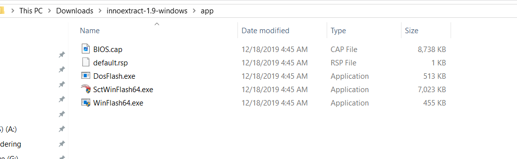

    I'm trying to extract a flashable bios file(ch341a) from the lenovo bios executable download. I have tried the instructions from this site https://starkeblog.com/lenovo/uefi/2...pdate-exe.html, which are not working. According to those instructions, after issuing the command
    Code:

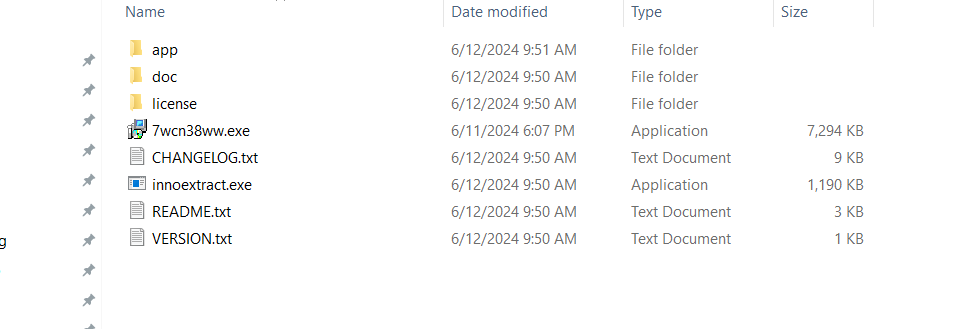

    "innoextract 7wcn38ww.exe"
    it should create an \app folder, inside which, I should find a newly created "7wcn38ww.exe" file. I should then be able to extract that using 7zip and find my .FD file.
    The trouble I'm having is that I'm not getting the newly created executable. It does seem to extract a "BIOS.cap" file, but I don't believe that's what I'm looking for, and that's also not in accordance with the instructions. Can anyone help walk me through this?
    • 21615
    The bios.cap is the bios update. It needs editing with a hex editor to remove the capsule header,then editing to the right size.

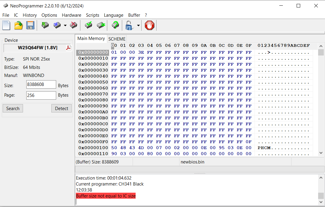

                Ughh... The dread "File size larger than IC size". This is a Lenovo IdeaPad 330S-15ARR​, board part# 431204725060. Pretty small board, and the only chip on it appearing as a bios chip is W25Q64FW. I'm trying to correct a problem where the device will power up, I get fans and all, but no display, no caps lock or anything like that. Really feels like a corrupt BIOS. I got the idea from this post: https://www.badcaps.net/forum/troubl...pad-330s-15arr
                  • 21615
                  Read the part number off the top of the chip and post it. There`s a number of different reasons for that dreaded message.If you`re using the original ch341a software use NeoProgrammer instead.Sometimes with the original software the Auto-detect will choose the wrong chip. Whichever software you use choose the chip manually from the supported list. If the chip marking is W25Q64FW the voltage is 1.8V so use a 1.8V adapter.

                    The number off the chip is 25Q64FWSIQ. I was using ASprogrammer. I'll go look for and download neoprogrammer. I'll go ahead and try the 1.8v adapter. Dor some reason I had it in my head that the CH341a would automatically step the voltage down but now I remember otherwise.
