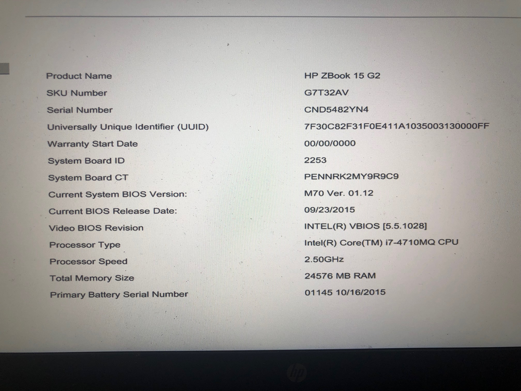

    Hi
    I tried exporting the BIOS with a "Universal BIOS Backup Tool". Not sure if this is the right way of doing it, but if it is:
    Could someone please help me clean out the password from the file?
    I have attached the info about the laptop as well in a jpg
    Best regards
    Jo

      have you tried bios from the previous posts? if none works put the original bios here.

        Hi, thanks for replying.
        Yes, I've tried them using Win-key + b when booting, but the caps-lock light is flashing, the screen is black, and nthe fan eventuallyvstarts going really fast, but nothing happens. I uploaded my backed up bios in the previous post (but not sure if it is the right way of doing it with the tool, or if I have to use a chip reader)

          Has anyone had anyluck with this
          I've tried using the posted .bin files several different ways loading onto a USB key via the HP USB Bios updater tool
          Have the same issue as tronsdal
          If I use the M71_130.bin HP provides, the USB bios restore loads and works, but of course doesn't clear the bios password.
          Are these .bin's being posted only working if you flash the bios chip with an external flash programmer?
          HP sucks so hard for bricking their systems with the bios passwords being totally locked out

            Yes, you need an external programmer.

                    Thanks for the answer. I tested them both. The second bios works perfectly. Thanks, saved my day.

                          Wonderful!! Thanks!!! It is work. Maybe you knew this password? I lock my home server files with the same password. I forgot it.
                          Very thanks

                            It was password deletion, not decryption.
                            There might be a way to decrypt it but since it's bruteforcing, it might take years
