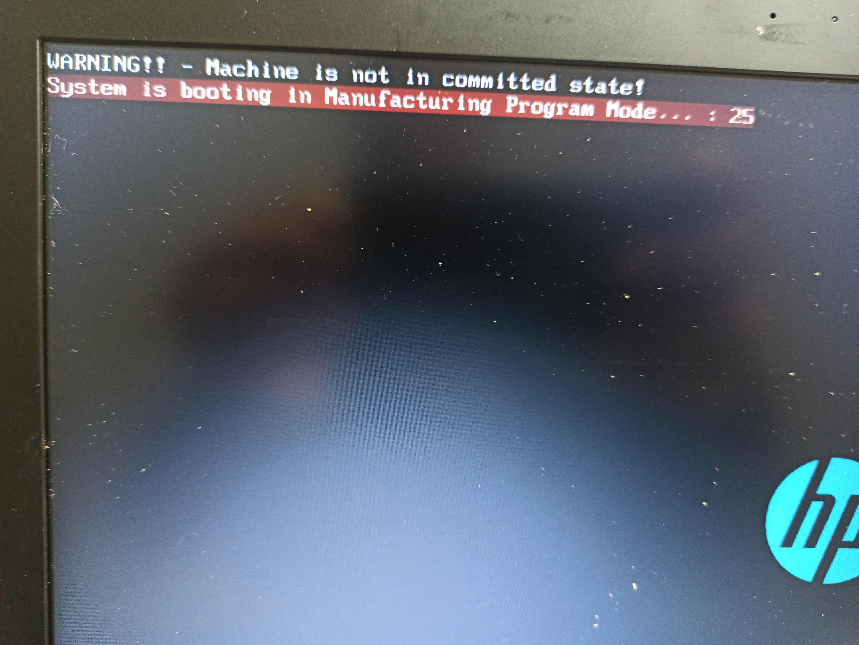

            #145
            Re: HP ProBook 650 G2 6050a2723701-mb-a02
            @SMDFlea,
            I tried N76 without any succes but when i reduced the speed to 2000 mhz, i get the screen again.
            Apparently, the speed is crucial.
            Now i get this messages, i search for solutions in other threads.
            But if you have fast solution, is welcome!
            Thank you!

              Try

                #147
                @hoaca388,
                It seems not working with this model.
