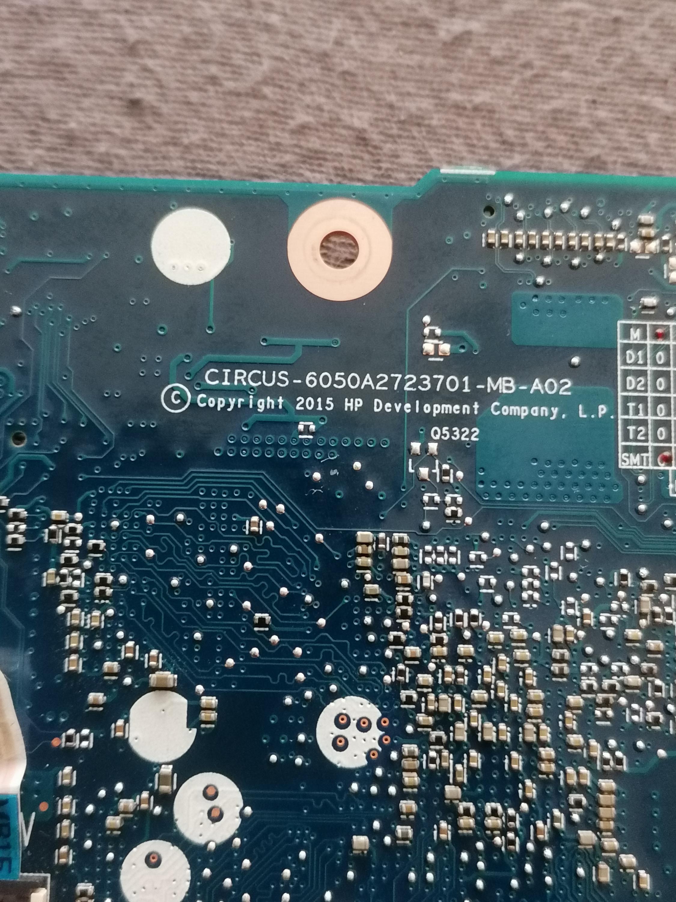

                                  CIRCUS-6050A2723701-MB-A02 bios
                                  hi please i need bios hp probook 640 g2
                                  mainboard : CIRCUS-6050A2723701-MB-A02
                                  THE LAPTOP WORKS WITH THIS DUMP BUT IT GOES VERY SLOW SSD NEW NEW RAM BUT IT GOES SLOW SO I WANT TO TRY ANOTHER DUMP TO SEE IF THAT IS SOLVED TAKNK YOU
                                  THIS IS MY BACKUP
                                  i have tried to download it from the hp official page but I get 9.216kb and mine is 16.384kb
                                    • 22275
                                    #77
                                    Re: CIRCUS-6050A2723701-MB-A02 bios
                                    THIS IS MY BACKUP
                                    The 9.216kb is a 9MB update, not the full bios. If its only running slow try cleaning the ME region. ME cleaning guide https://www.badcaps.net/forum/showthread.php?t=88533

                                      #78
                                      Re: HP ProBook 650 G2 6050a2723701-mb-a02
                                      thank you smdflea for your reply after cleaning me region now i have no image i did it with MEinject.exe
                                        • 22275
                                        #79
                                        MEInject isn`t recommended for anything above version 6/7 FW. Use the win-raid guide.Give it a go,if you can`t do it let us know .
