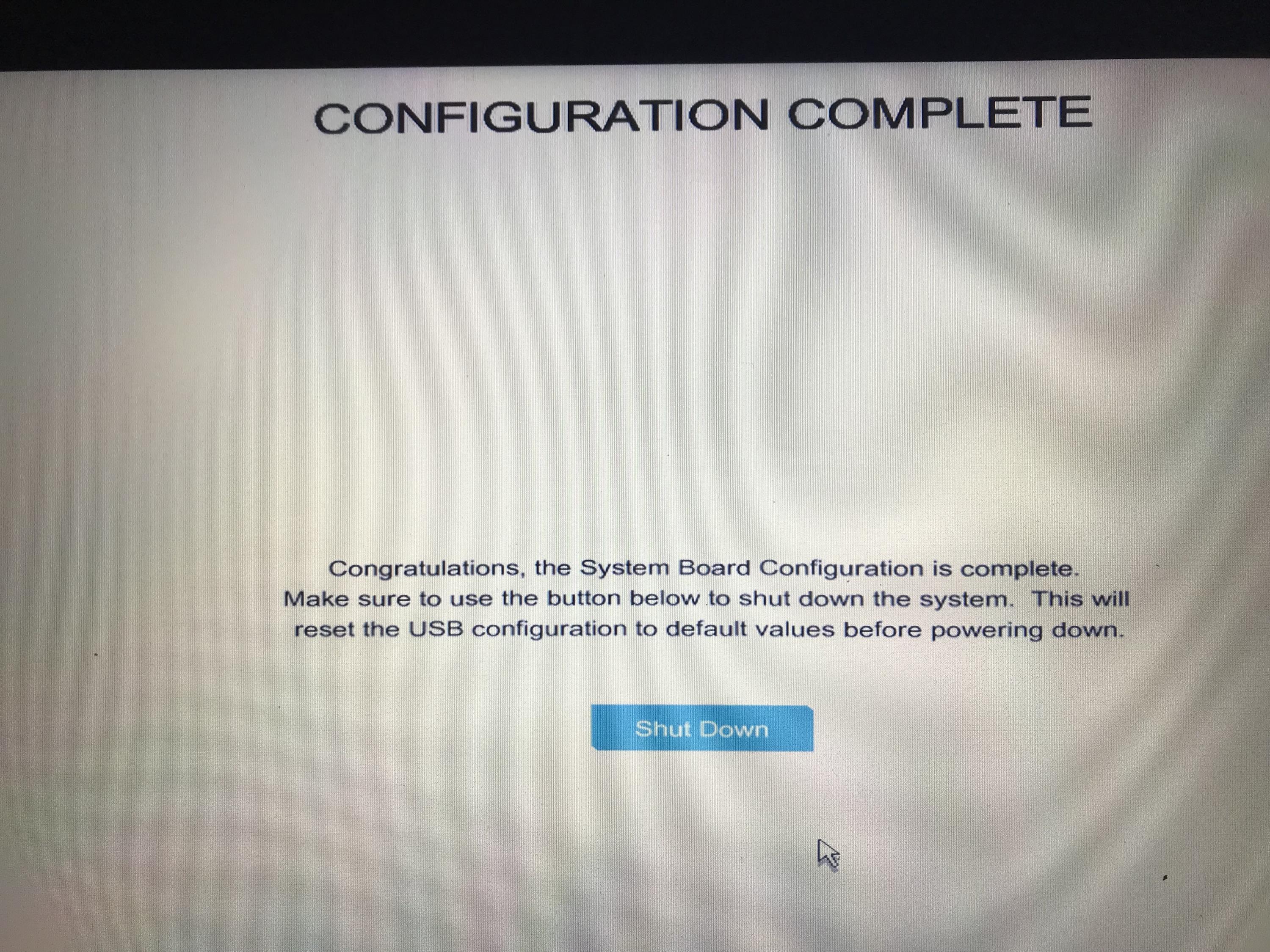

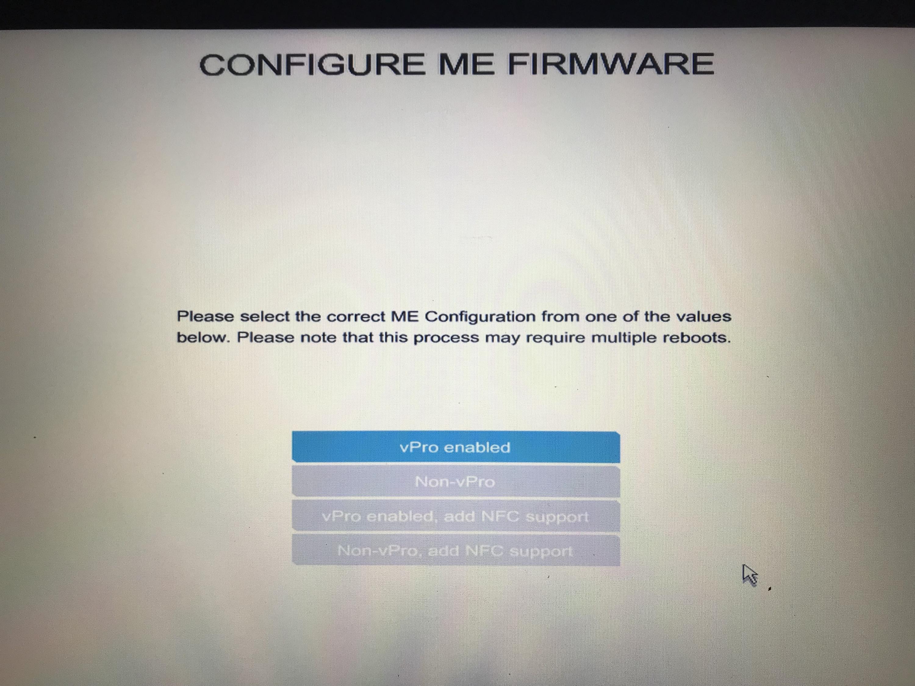

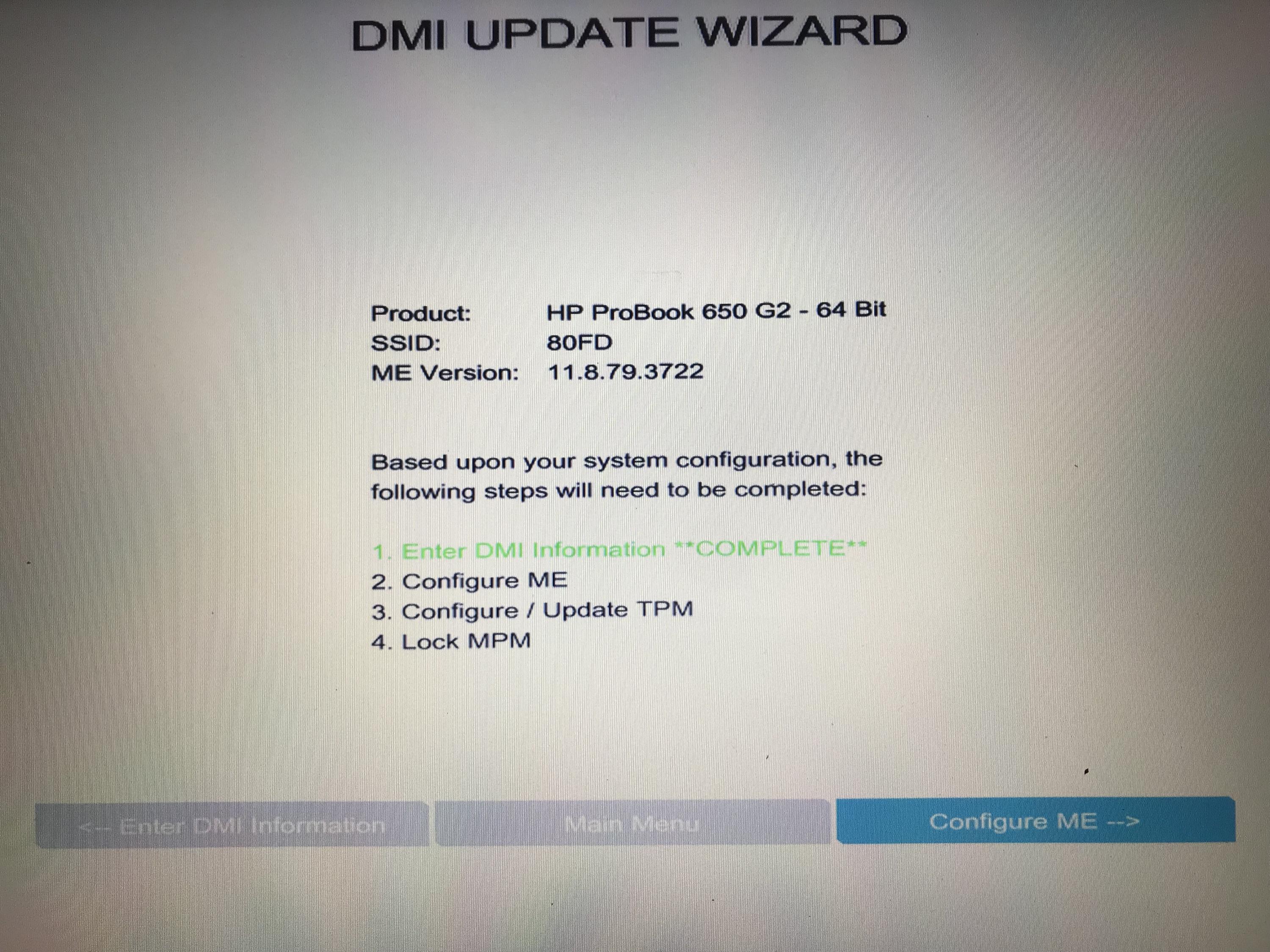

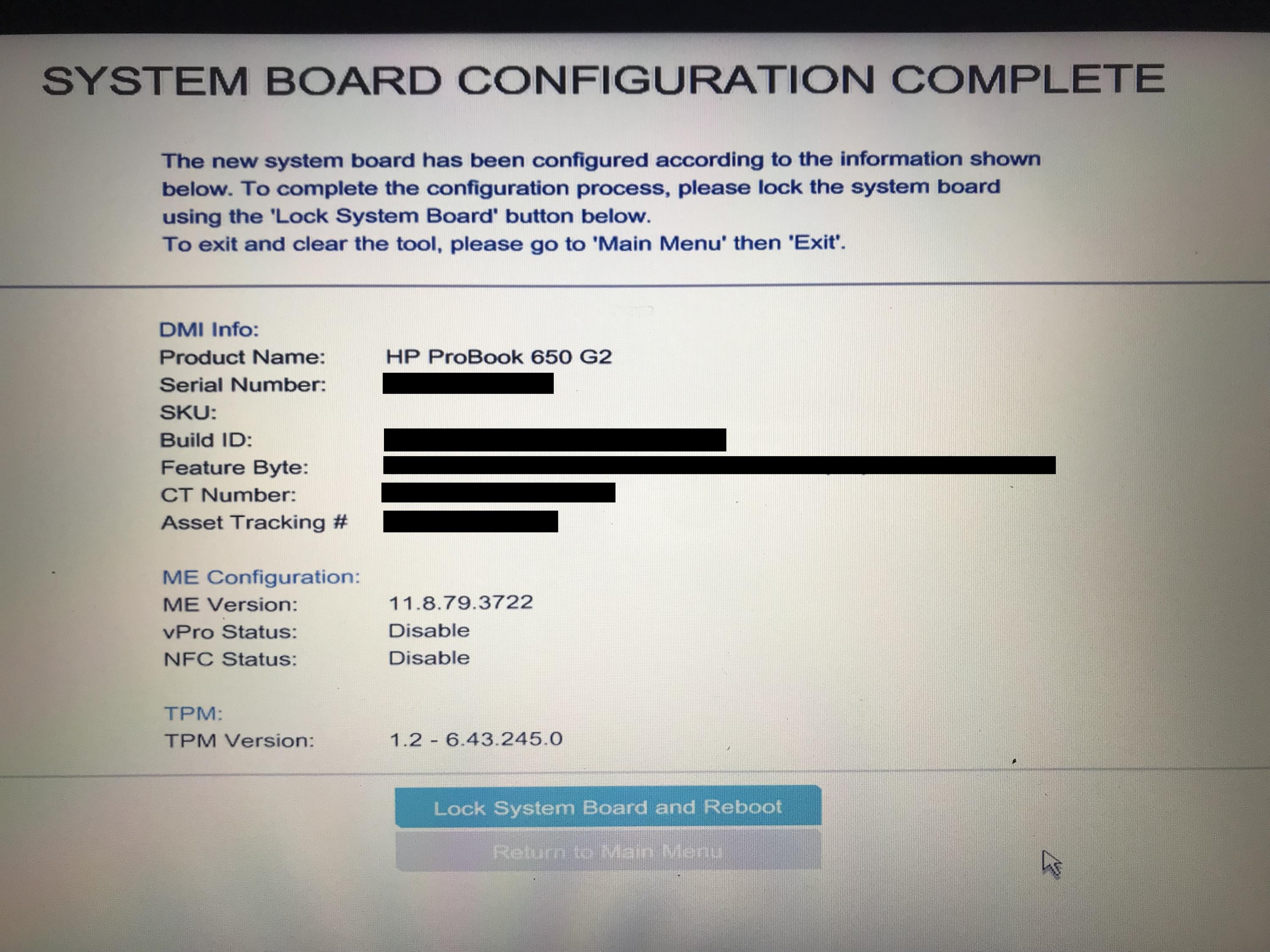

    Re: HP ProBook 650 G2 6050a2723701-mb-a02
    I forgot to add the attachments. Screenshots are for Probook 650 G2. The process for Probook 650 G1 was the same, although for some reason the DMI tools were started within Windows 10, while for Probook 650 G2 were started at startup level (before loading the OS), as you can see in the screenshots.
    Additional tools that you might want to experiment are (although they didn't help in my case):

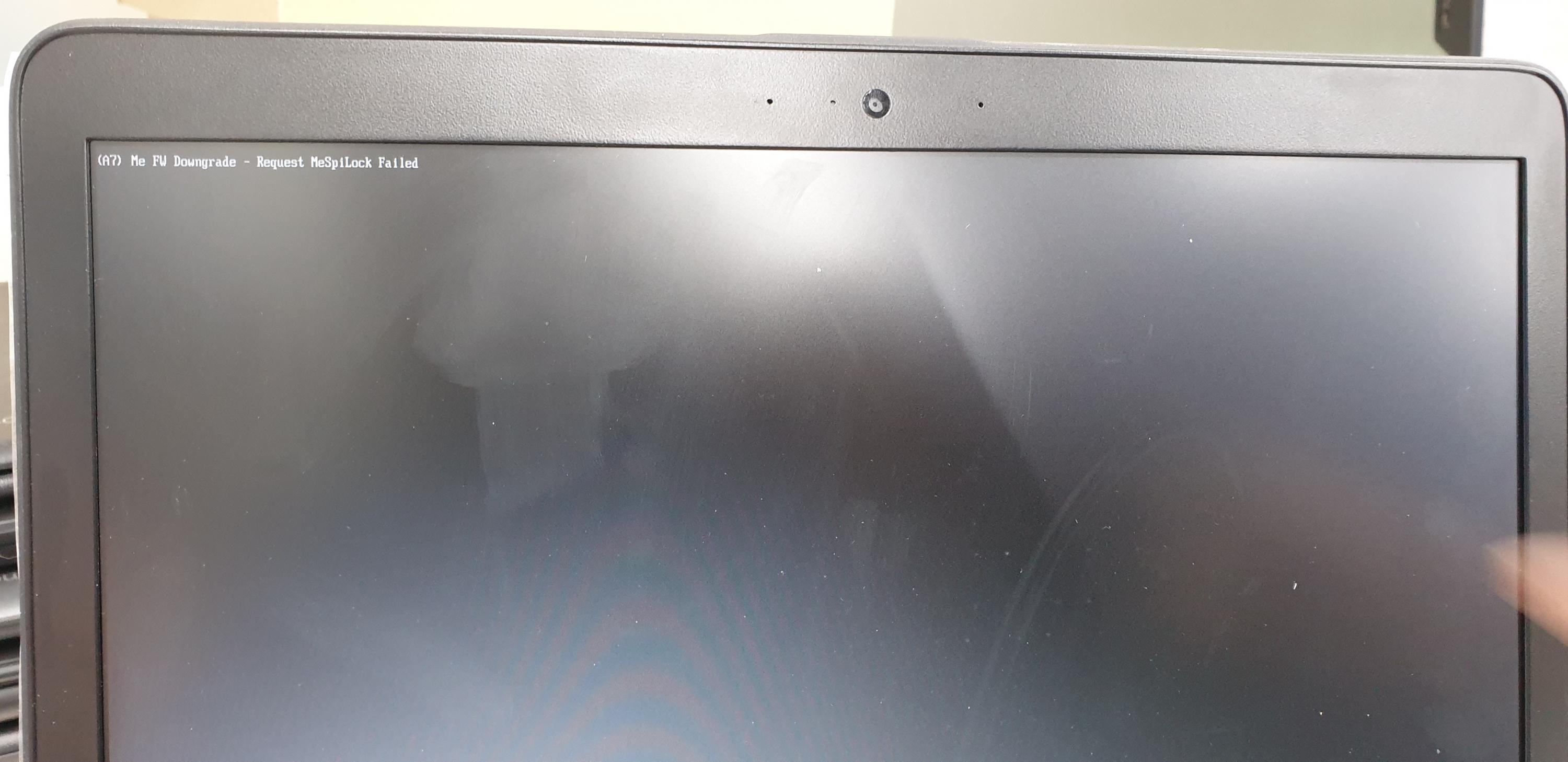

                              Can you help me I have HP 640 G2 ME FW error in bios startup,
                              Picture & Original Bios are attached.
                              Thanks in advance.

                                It powers on and nothing on display, and makes 2 long beels then 2 short ones

                                    • Ateequeahmed7
                                      • Nov 2018
                                      • 29
                                      • Switzerland
                                      #138
                                      Originally posted by hoaca388
                                      Yes it's working dear.
                                      Error is gone.
                                      Thank you so much.
