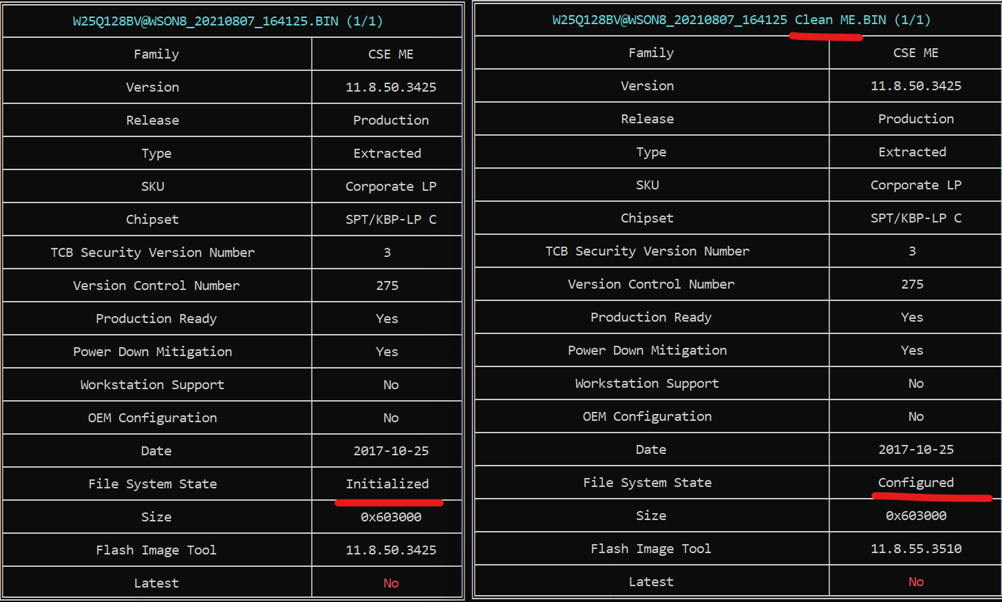

    Originally posted by ismaelstepheno
    ok thanks for the info i used the win-raid guide but still the same no image
    Become a Badcaps supporter
    Thanks to all supporters.​

      Re: HP ProBook 650 G2 6050a2723701-mb-a02
      Thank you vesko356 this one give me the image even it has a password but the laptop still going slowly
          THIS IS MY BACKUP
          Cleaning ME firmware doesn't add or remove password if any exist.
          This file uploaded in your post already had a password, if you don't know it (I wonder why after you said that this is a backup of your BIOS, or it's a file that you just downloaded from somewhere) you just had to say so. I could remove the password easily. However, I suspect that you don't know exactly what you want.
          Which shows that the problem is not in the ME firmware, and most likely not even related to the BIOS, and probably is just a hardware faullt.
            This computer belongs to a friend when I see that it was slow, I thought it could be the bios, so I wanted to clean the me region to see if that would solve it, I didn’t know that my backup had a bios password until you told me now I’m so sorry I thought that the one you uploaded was a backup from another computer .I know that the password is easy to remove i think it can be a problem of graphics or the bios chip
            Im so sorry again and thank you for your help
              No, why should I give you backup from another computer, when you wanted your to be cleaned.
              Of course not, this is your bios dump with a clean ME firmware, just the way you wanted it, so I deliberately left the original file name and added "Clean ME" at the end.

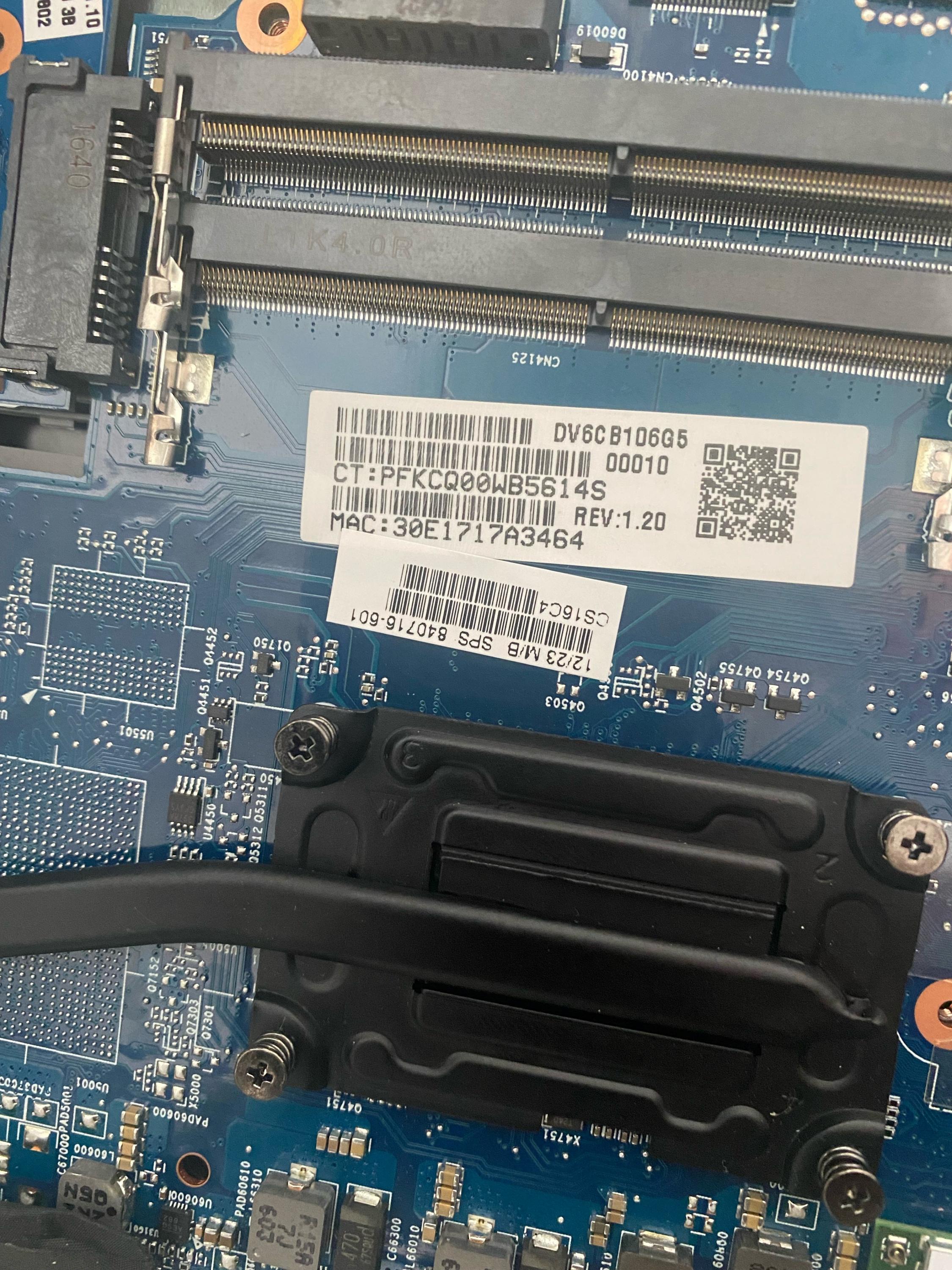

                      Hallo, I have one ProBook 650 G2, With orig Bios does not start at All. I tryed All Bios version that i found Here, But Doesn Work. With some It start FAN on 100% but Without Screen. This is Original BACKUP ( Does not start at all ). Can you please check it or clean It. Thanks in Advance. Regards. Branko

                                #95
                                Originally posted by peste
                                what model is the motherboard ??
                                Motherboard:
                                • peste
                                  Originally posted by brackovic
                                  Motherboard:
                                  look for something in this form(6050a2723701-mb-a02), written in white paint on the motherboard.
                                  • brackovic
                                    • Sep 2021
                                    • 12
                                    #97
                                    Oh Sorry, I have Found:
                                    CIRCUS-6050A2723701-MB-A02
