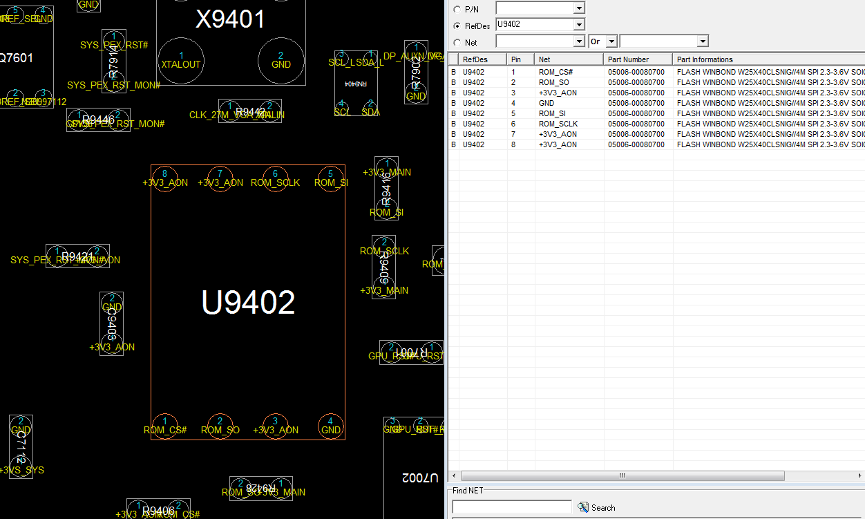

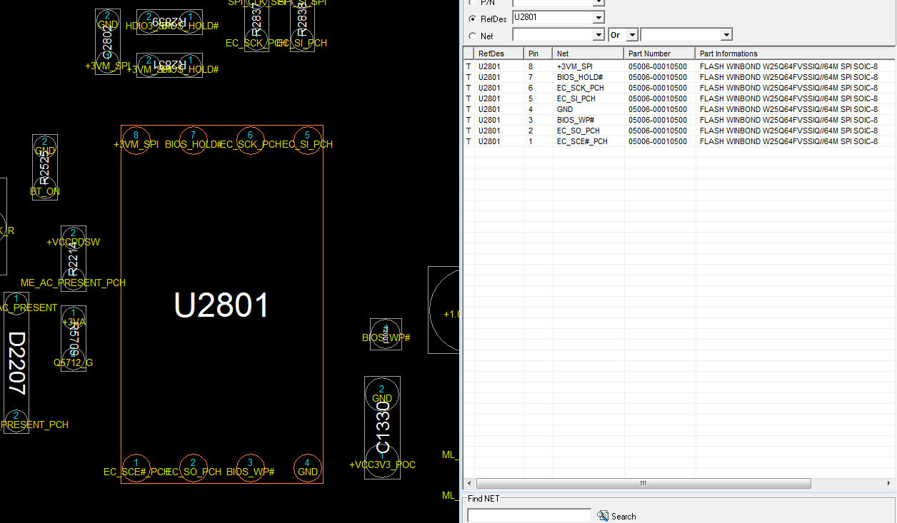

      OK i attached for asus g751 boardview and i zoomed those two bios chips on boardviewer. Can you please tell me what is their function on the board? I believe that U2801 should be main bios...but what is then U9402? please explanation...

          Tell me the chip number of two different EEPROM. I'll tell you the the main BIOS number and EC BIOS number. Usually EC ROM number is like 25x20, 25x40, 25x80 etc. And main one like 25x16, 25x32, 25x64 etc. You may now differentiate between EX and Main BIOS.

            As you can see in the images attached, in the right corner, first chip is winbond W25Q64FVSSIQ and second is winbond W25X40CLSNIG. so the first one would be main and second EC ROM?

              W25Q64FVSSIQ - main
              W25X40CLSNIG.- ec
