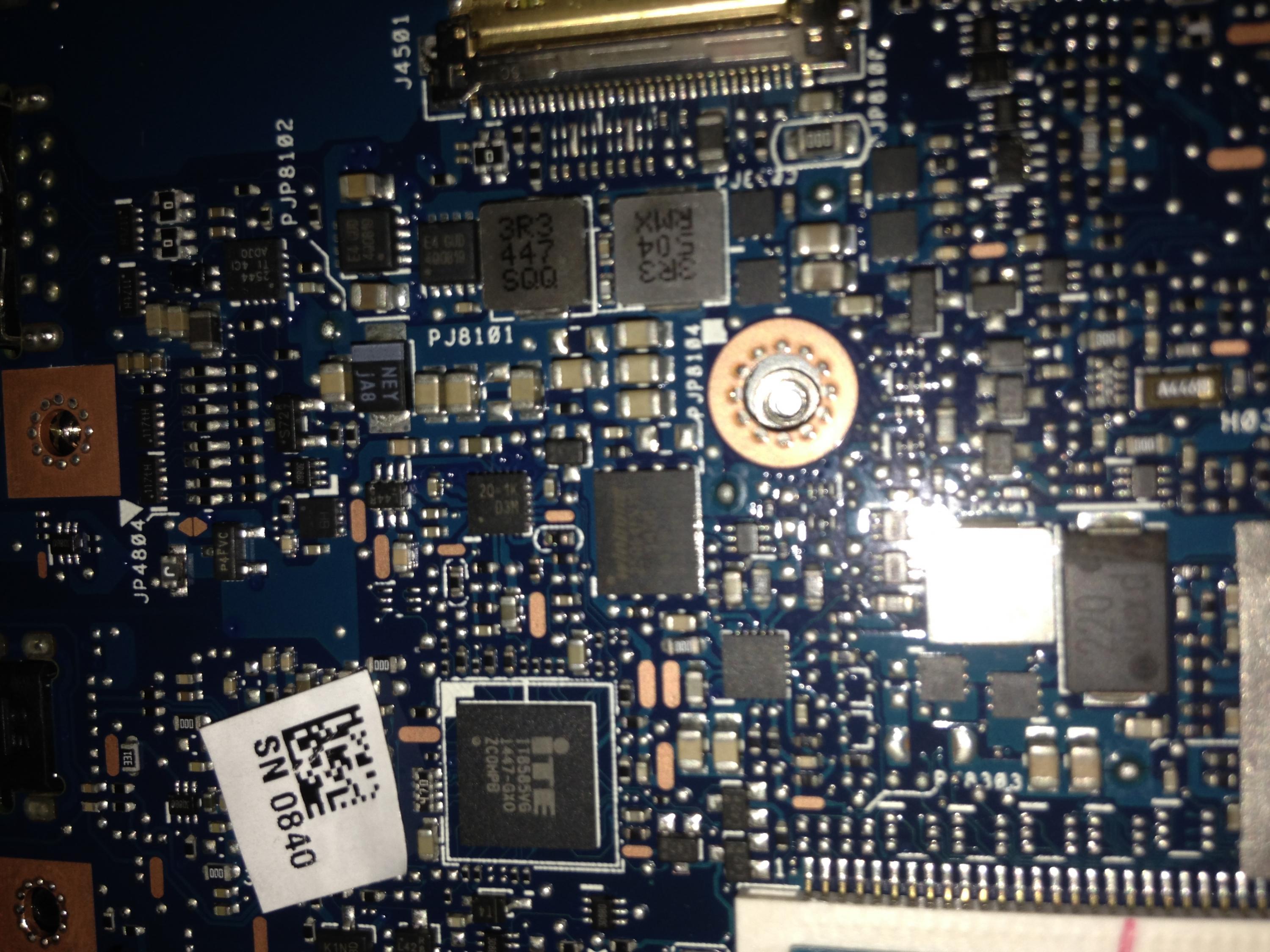

    Hi everyone i need a working bios dump file for this model laptop turns on led light steady and fan but there is no display all voltages are present.please anyone share the bios please thanks in advance

    Anyone has a working bios for this please power light and capslock steady but there is no display

      Re: Asus zenbook ux305 bios needed
      post bios backup
        Thanks for the reply ala borbe i cannot read the bios because it uses different chip and i dont have adapter for this what kind of winbond chip is this attached?
          Also laptop turns on sometimes but when i shutdown and turn again still no display
              Update:i rest the laptop overnight and when i turn on it boots fine but when i shuts down the same issue again turns on with power led light and capslock and blink once the f2 on the keyboard.what is the culprit on this?please help
                  do inspection of all ic's Legs,looking for ic legs corrosion, if you find one perform cleaning....
                    Thanks for the response ill try to inspect if there is corrosion i cannot flash bios i dont know what type of chip winbond w26q64fviq.the problem is if i rest overnight and turn on on morning it wrks fine but when i shut down turn on with only power led light capslock and f2 blink once.i noticed also cpu is hot
                        Ill tried update the bios on windows it updates but once restarted same issue
                                      At first solved the problem when i rest the laptop for 2days the il try again switch on the it boots fine thw i flashed and update the bios using winflash successfully update problem solved but after a week of using came back the same issue nw laptop turns on but only capslock and f2 and power led light present but no display. I cannot flashed with external programmer because bios chip is different i dont have an adapter for this
                                        i have bought a adapter for this chip WSON8 i successfully read the chip dump i need help to fix this dump can please help me ALA BORBE or TECHMAN to fix this dump file please.problem turn on only capslock and led light steady. attached i upload the original dump . thanks in advance
