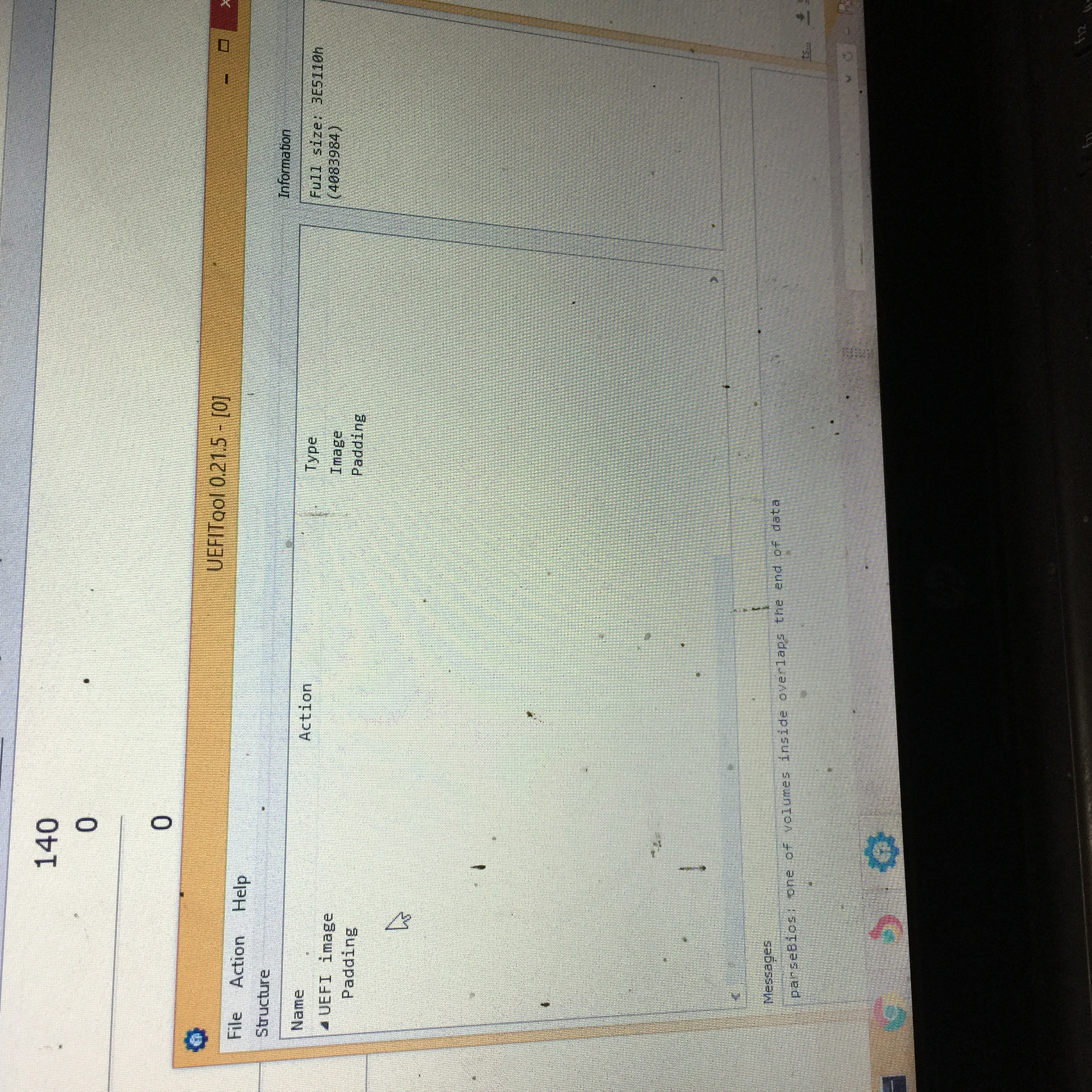

    Originally posted by Esse
    This is picture
    [0] file open with uefitool, now you will get bios region... compare with your backup...

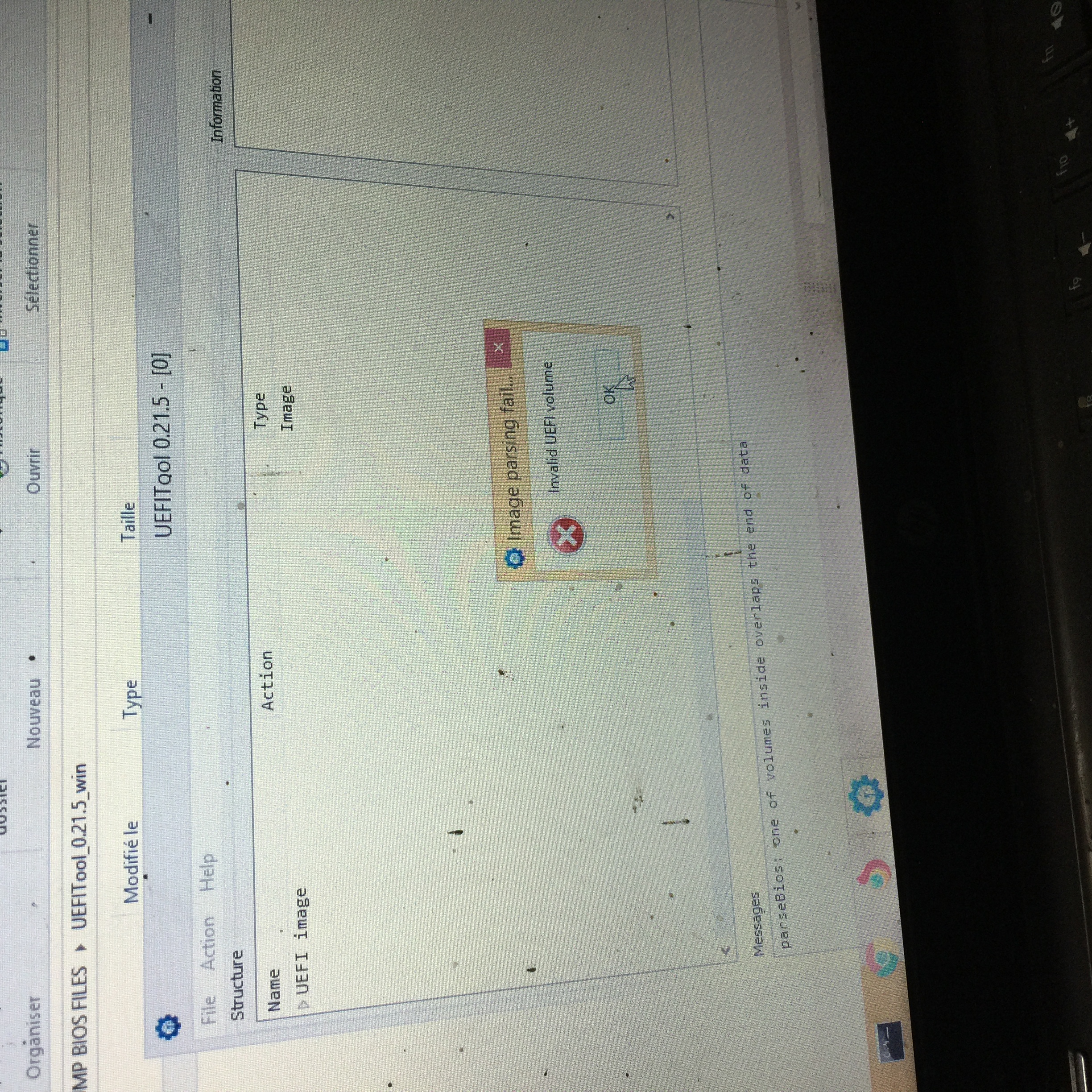

      Re: SONY VGN Z11VN bios needed please
      Please sir,look at what i get opening [0] file with uefitool and tell me if i did something wrong

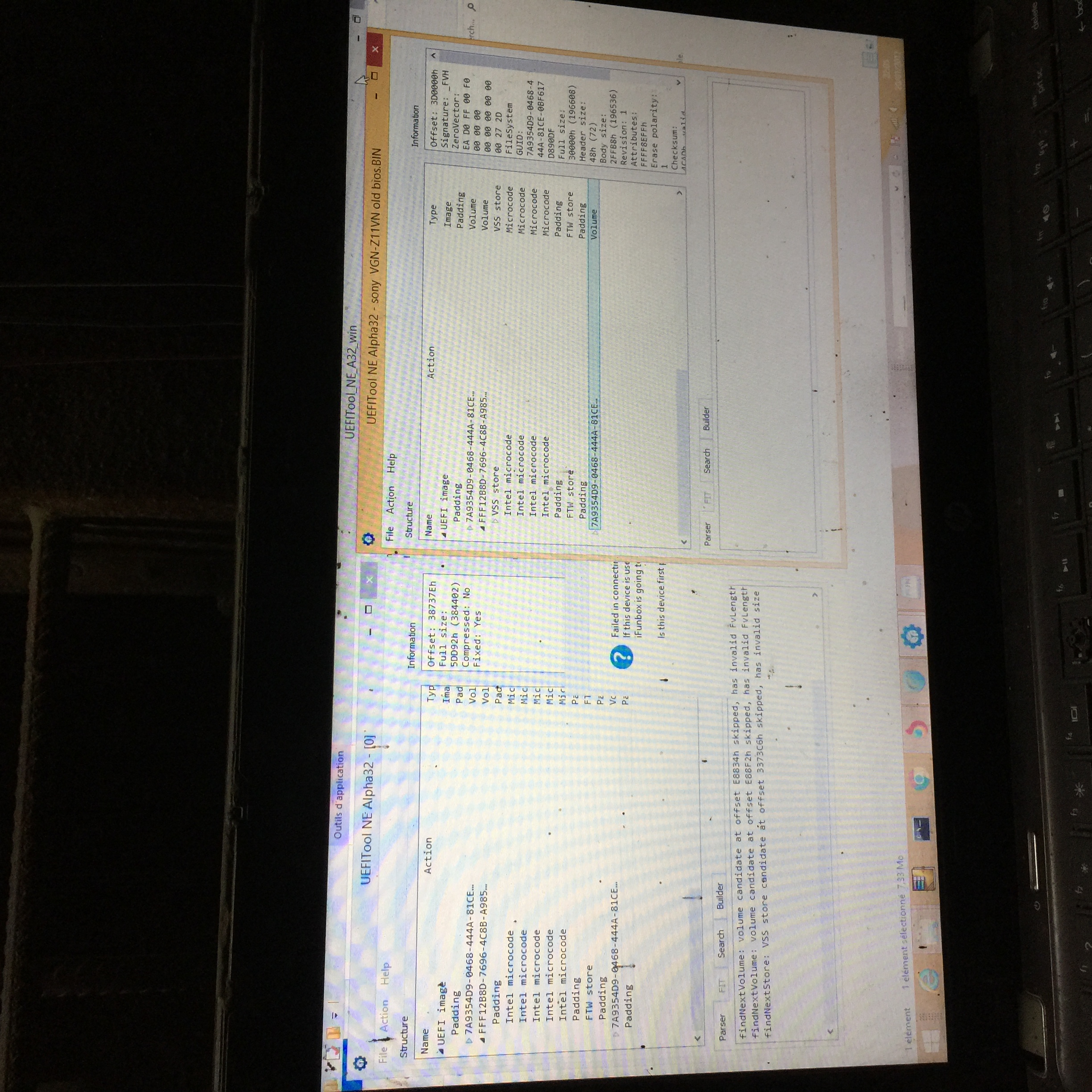

        these are the images:
        • Esse
          • Apr 2014
          • 317
          • TOGO

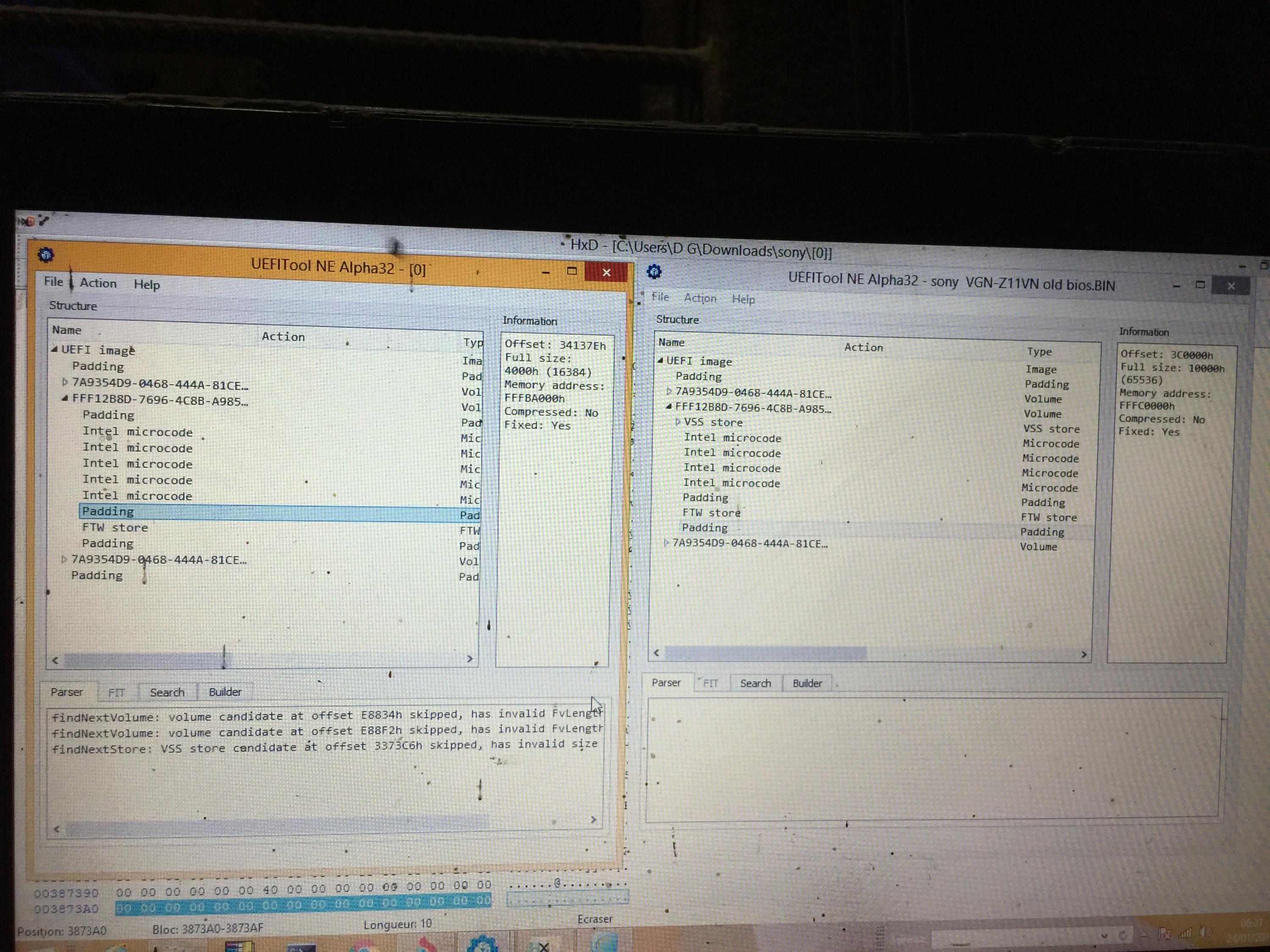

          Ok rioreno I compare the my old bios which is at the right side in the picture and the [0]file at the left.so I'm seeing some VSS store in my locked bios which is not in the update bios.is that comparison correct?if yes what to do next to get the bios without the password?
            1. At [0] file use hexeditor to cut all padding...with help uefitool to gain size and offset..
            2. At old bios file extract padding only.
            3. With hexeditor again you merger padding from old bios file and rest of [0] file(after cut allpadding)...for the structure refer to your old bios...
            Now you get your new file without password...
                  Please sir rioreno,I want to know why the file [0] is chosen in the updated bios not the others files?
                  • Esse

                    #29
                    Please, why the choice of the [0] file between the others of decompressed update file?

                      #30
                      the biggest one

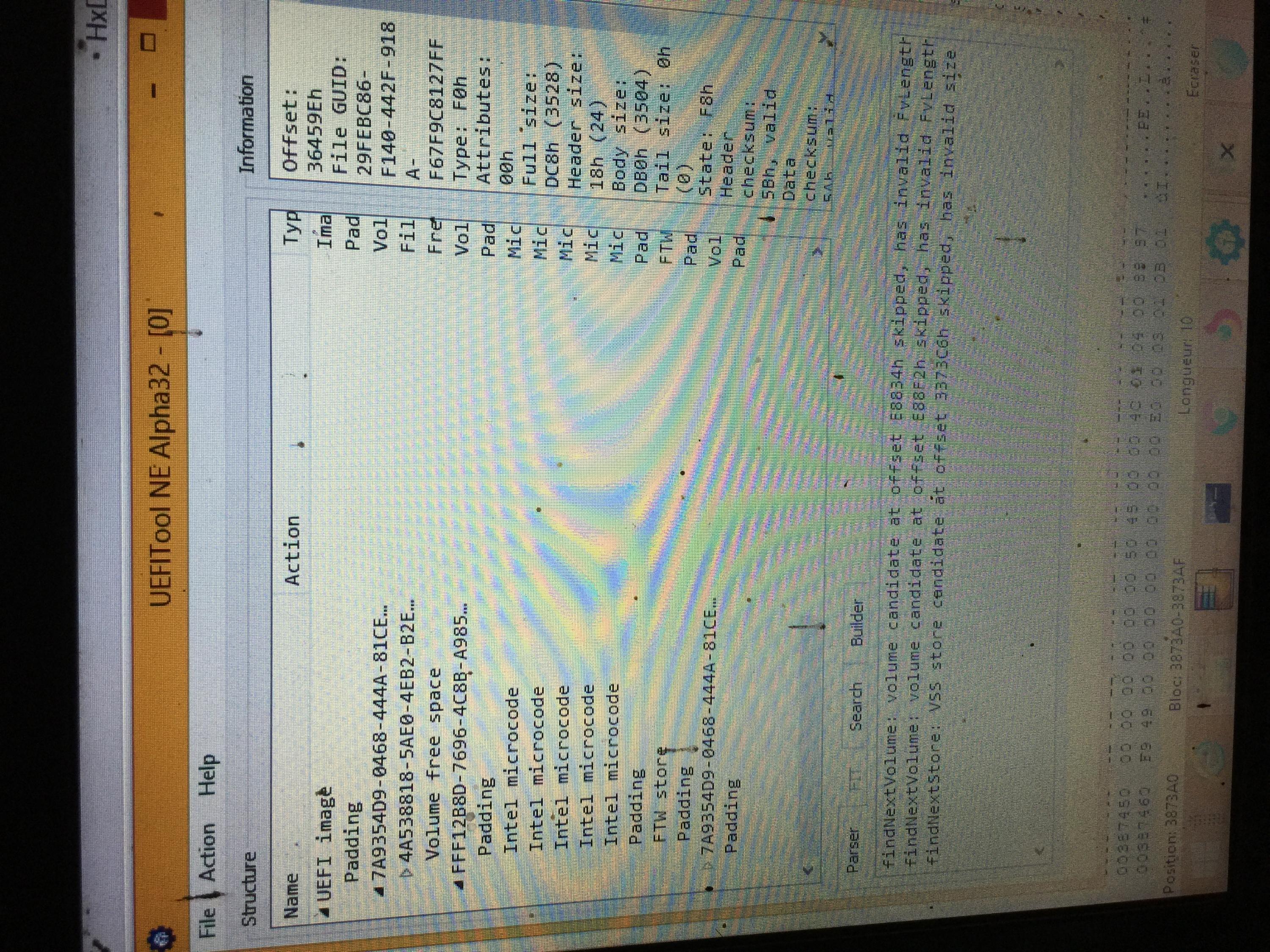

                        #31
                        Thanks for the answer.please looking at the file [0] with uefitool,i am seeing 5paddings.is it all these 5 paddings I should cut?

                          #32
                          no... only 2 padding, 1st and last padding,
                          why? refer to your old bios.. 1st padding [0] different size with old bios.. last padding not in the list in the old bios..

                            #33
                            Ok.but comparing the third (3) padding of the two bios,are thy not different in size looking at the image I post ?

                              #34
                              Please rioreno,when you said in post #25 ,that i should merge the padding file from old bios and the rest of [0] file after cutting paddings, is that mean I should put the rest of [0] file at the end of padding from old bios in hex editor?
                              If it's so,I'm not getting even the size with old bios.

                                  #36
                                  i said only 1st paddng and last padding, dont touch others padding.. post #33
