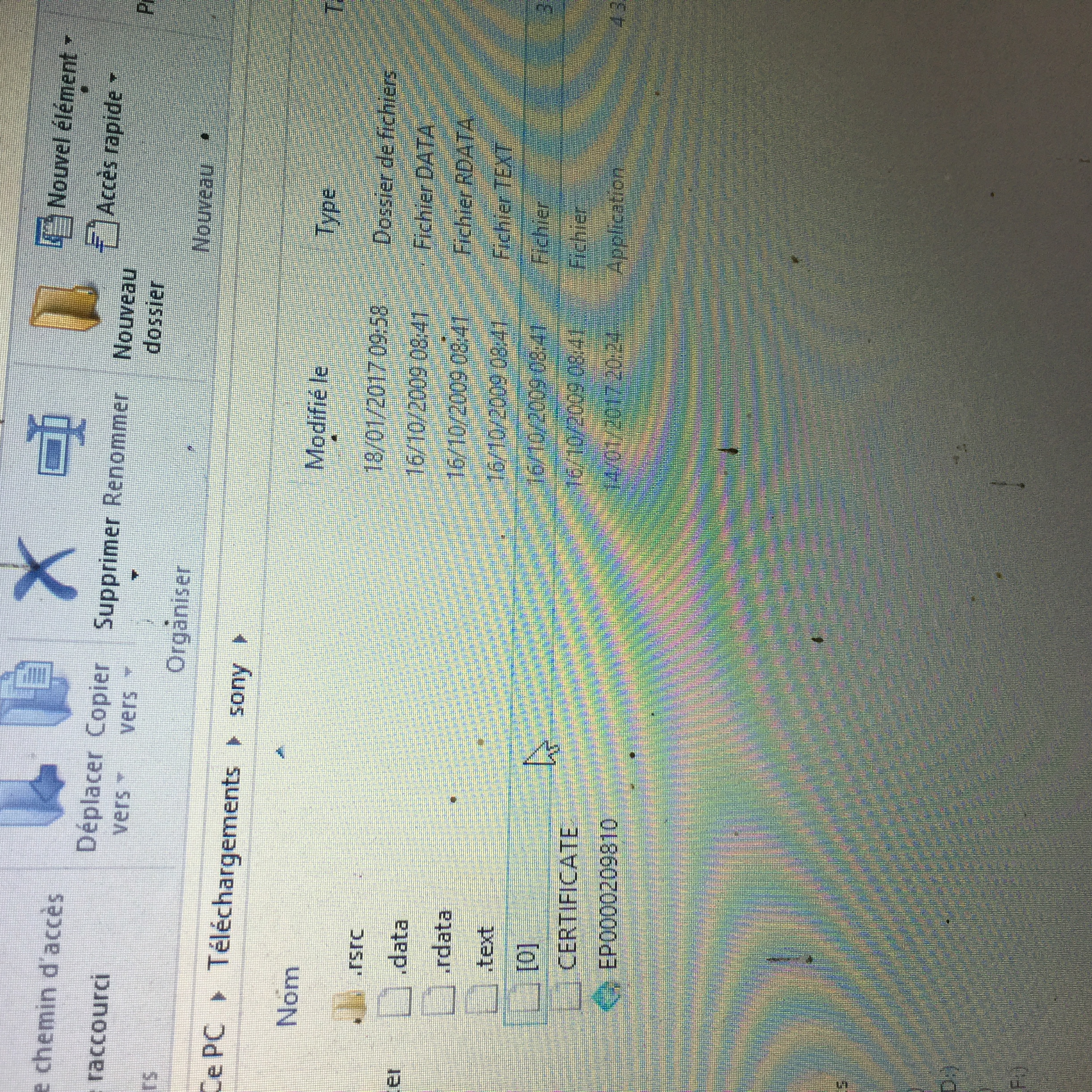

                                  uniextract OR running update.exe, find c://user/appdata/local/temp/ latest folder

                                    Re: SONY VGN Z11VN bios needed please
                                    Please i am not getting it.can you give me more details
                                    i get the update file ;so should i use the uniextrac to extract this file?
                                      Please rioreno,I use uniextract to extract the update bios.and this what I get in the picture.please what should i do next to get the .bin file R169ME.BIN
                                        This is picture
