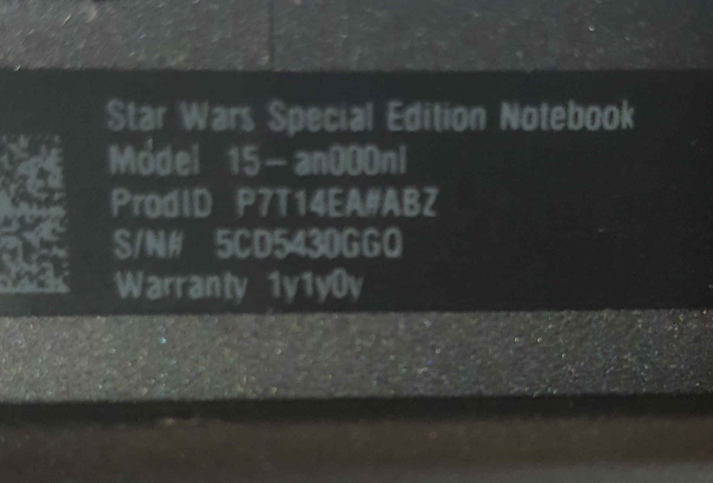

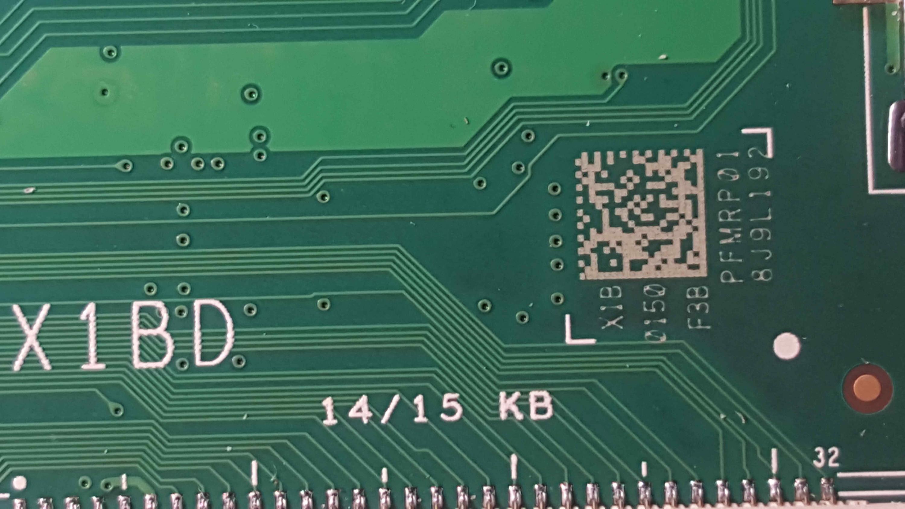

                        Re: hp 15-an050nr bios
                        Help to identify correct bios
                        Hp star war edition DAX1BDMB6F0 REV:F
                        080A0 fan spin but cpu cold
                        080A9 fan reapeatly stop and go but cpu cold
                        0809B fan not spin cpu cold
                        08092 fan spin but cpu cold

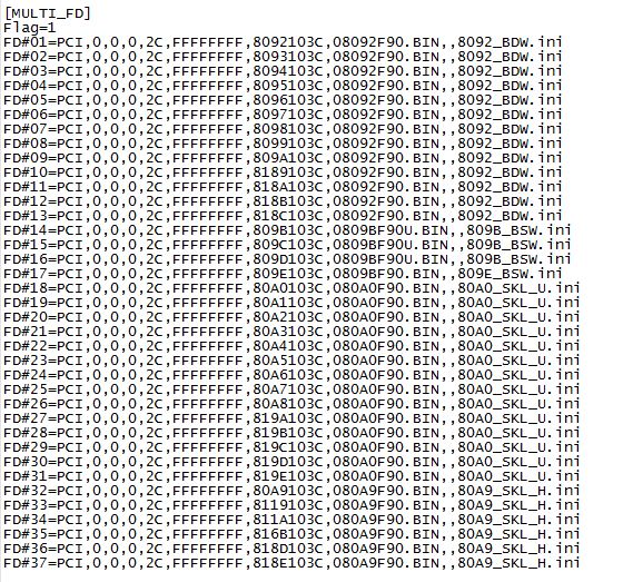

                                intel i7-6500u SR2EZ
                                I would like to be sure of the bios before starting a search for a hardware problem
                                  • 22084
                                  Yes, 080A0 is the right one.Ive added a screenshot of the platform.ini file from the bios update.
