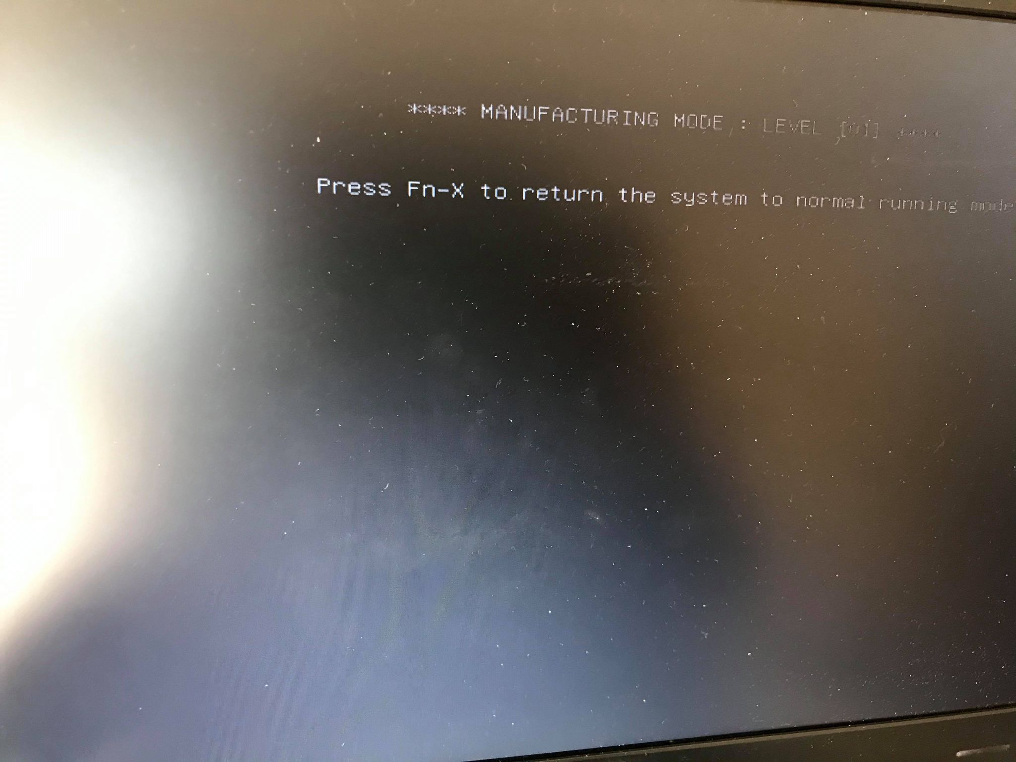

        HELLO all ,
        Need dump file bios version A12 .
        My battery is Dead ,I cannot update with windows
        i need to put w10 otherwise blackscreen after drivers
        Can someone extract me the dump from the original exe DELL
          • 22285
          Re: Dell Vostro 3550 bios
          HELLO all ,
          Extract it using the the command line,as admin.Change to the directory where you have the exe then type the command,and enter
          3550A12.EXE /writeromfile
              What is missing Service tag SN?
              edit :ok good just put Service tag
              it's ok like that??
                • 22285
                Press FN + x it should make the message go away.

                    good day every one, only charge battery and dont power up
                    Model: Vostro 3550
                    servTag: JRKG9S1
                    MoBo: 10245-1
                    48.4IE01.011 DQ15
                    DP/N: XYW0CBR-0XYW0C-10819-1AP-00EX-A01
                      SMDFlea commented
                      Editing a comment
                      Thread merged.
                  • the Benninger
                    • Nov 2022
                    • 189
                    • venezulan
                    something is going wrong, I programmed it twice.., at the first start it generates the black screen where it asks to continue pressing fn+x, nothing is done, everything restarts, it only enters the bios screen and it doesn't let me set the time, I can only hear the Keyboard bbeps does not fill in the time or date fields, I press the power button for 5 seconds. to turn off then it only beeps as if it had a Ram Memory problemfan spinning and black screen after second reboot, and I used the file named 3550a12.rar that was provided at some point to Maxpower3 and it is not working for me
                    • the Benninger
                      • Nov 2022
                      • 189
                      • venezulan
                      You can forget my post I solved with the 3550a12.rar file, it was just that the Tsop8 (MXIC 25L3206E) would be defective, I replaced it with a (WinBond 25Q32FV) and the old warrior is now working again, thank you very much for those who took interest
