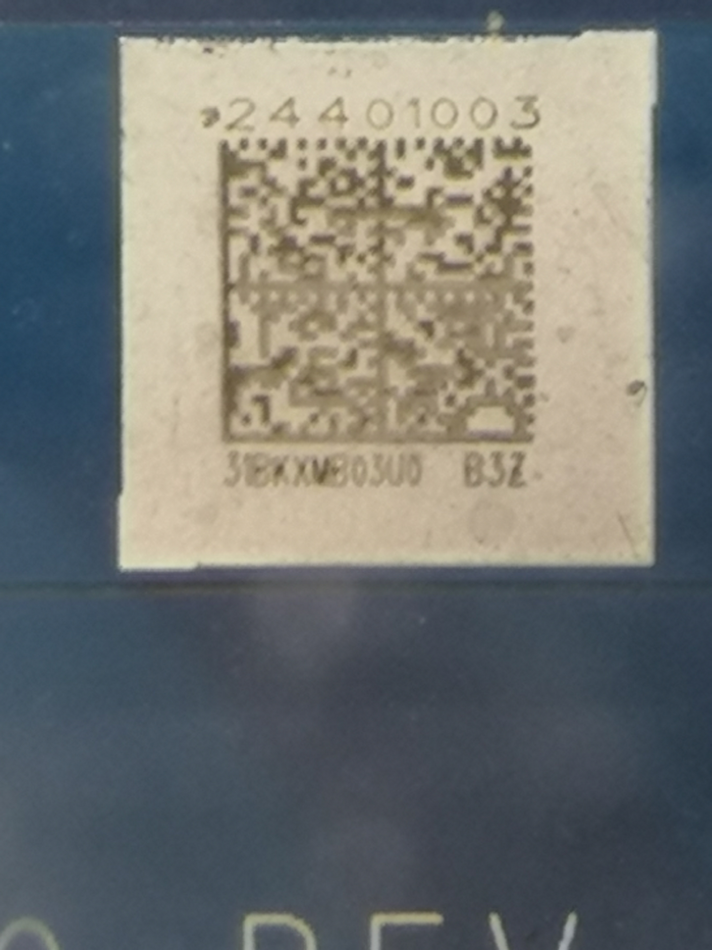

    Hi. I bought a damaged Asus motherboard, model dabkxmb18b0 rev.b. The problem with the motherboard was a faulty processor.
    I replaced the processor, but it arrived without a BIOS chip. I found one post on the forum, but my problem is
    I don't know which chip to program, and I don't have a schematic. Does anyone know which BIOS chip models are compatible with this motherboard? If so, please let me know. Thanks.

    Thread moved to laptop bios requests forum. Please type s text the laptop serial number and full laptop model number. Post a picture of the long barcode sticker or square QR code on the motherboard, or scan the QR code yourself and post what it says.

      QCCBKX3UZ24401003,NB44NRCX0001SVMB,FX506LHB,60NR03U0-MB2000,100,A036BC3317B7.
      This is my qr code read. This is all i have.

        Try, BIOS chips listed
        Flash chips in VSCC table:
        EF4018 (Winbond W25Q128)
        C22018 (Macronix MX25L128)
        20BA18 (Micron N25Q128)
        C84018 (GigaDevice GD25x128)
        W25Q128JV should work
        FX506LHB

          Thank You so much!
