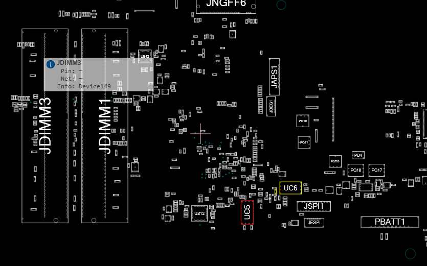

      try UC5 or UC6 both Click image for larger version

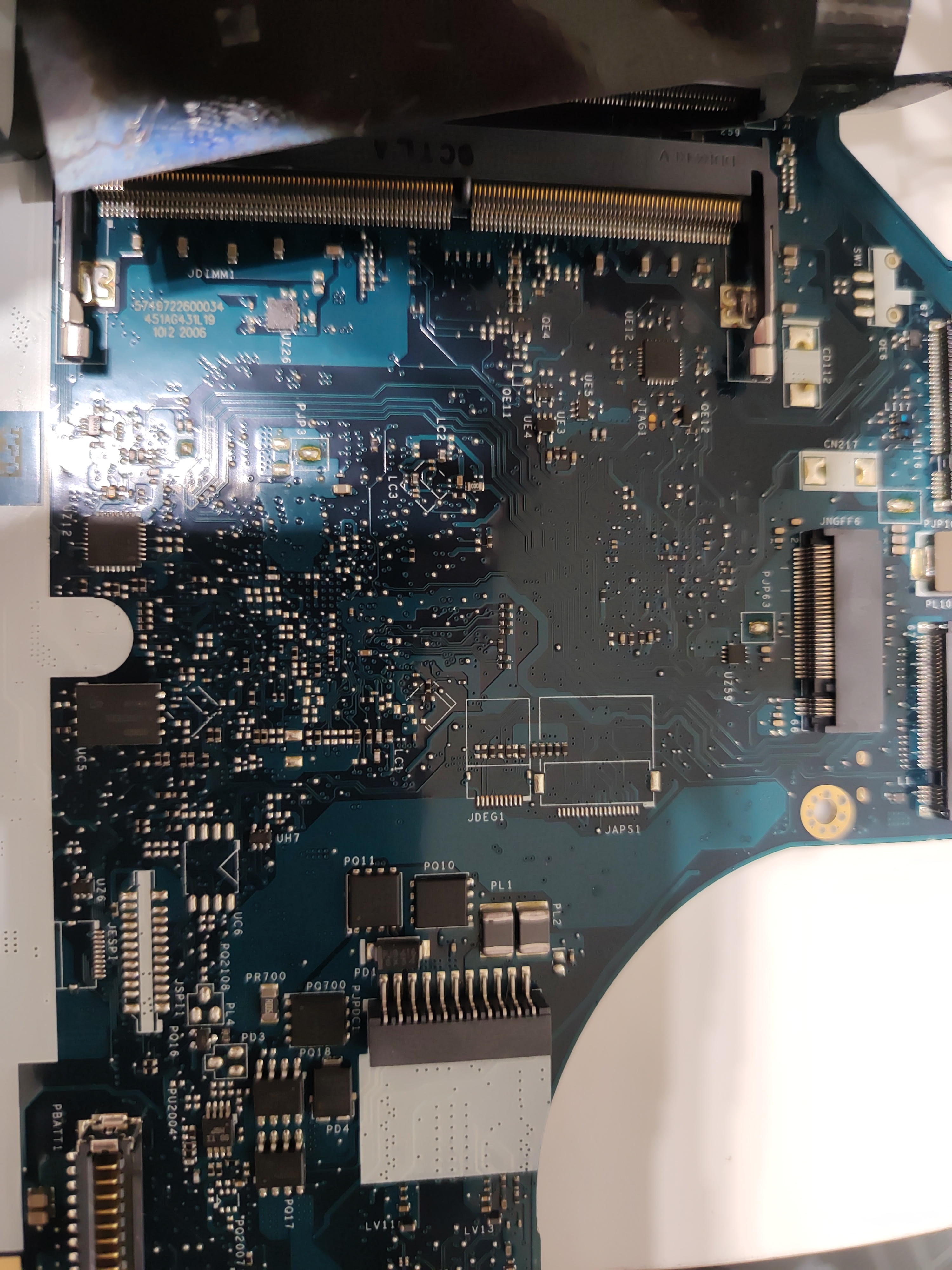

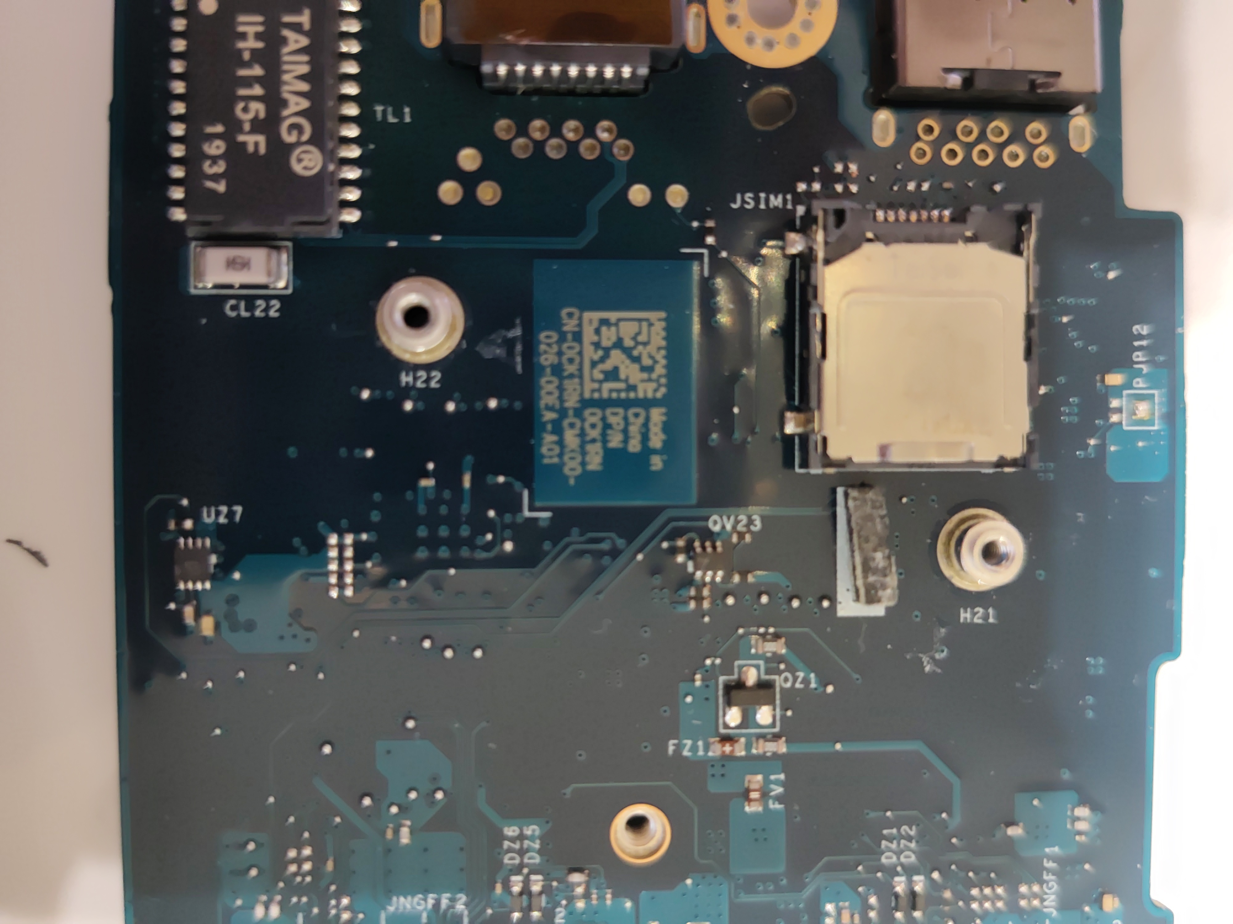

        Thank you, I am attaching the motherboard pic for the same part can you know which one because uc6 is missing.
        • lapfix
          • Mar 2020
          • 2765
          • my workshop
          UC5 capacity !
          Is it written at the chip 256 !!
          • dr_crx
            • Jun 2025
            • 17
            • usa

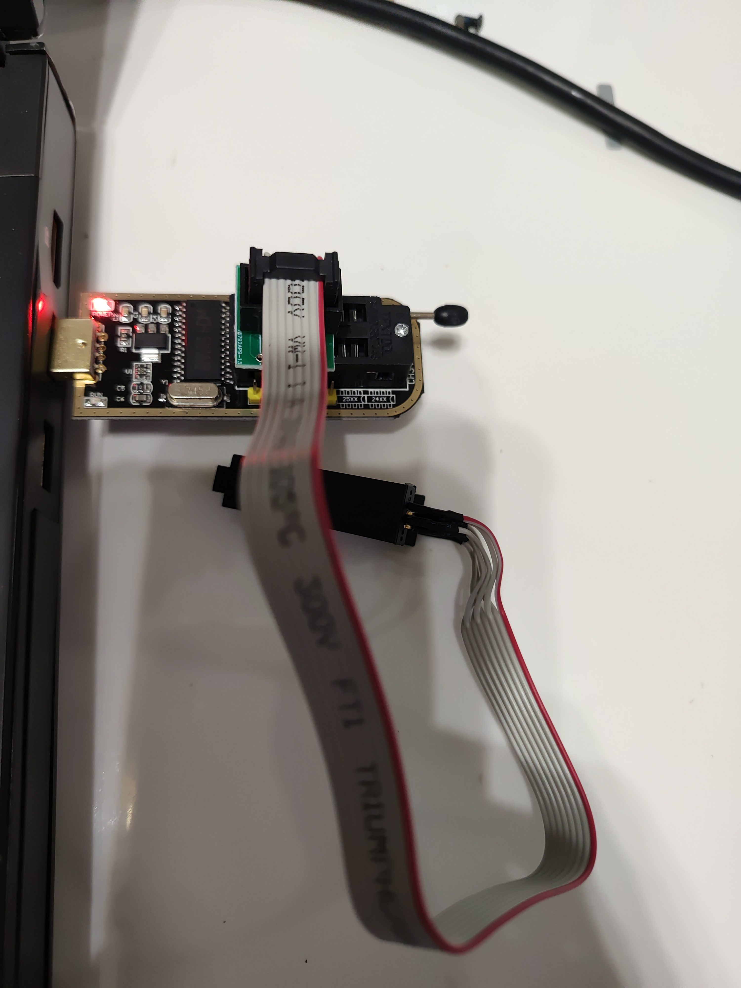

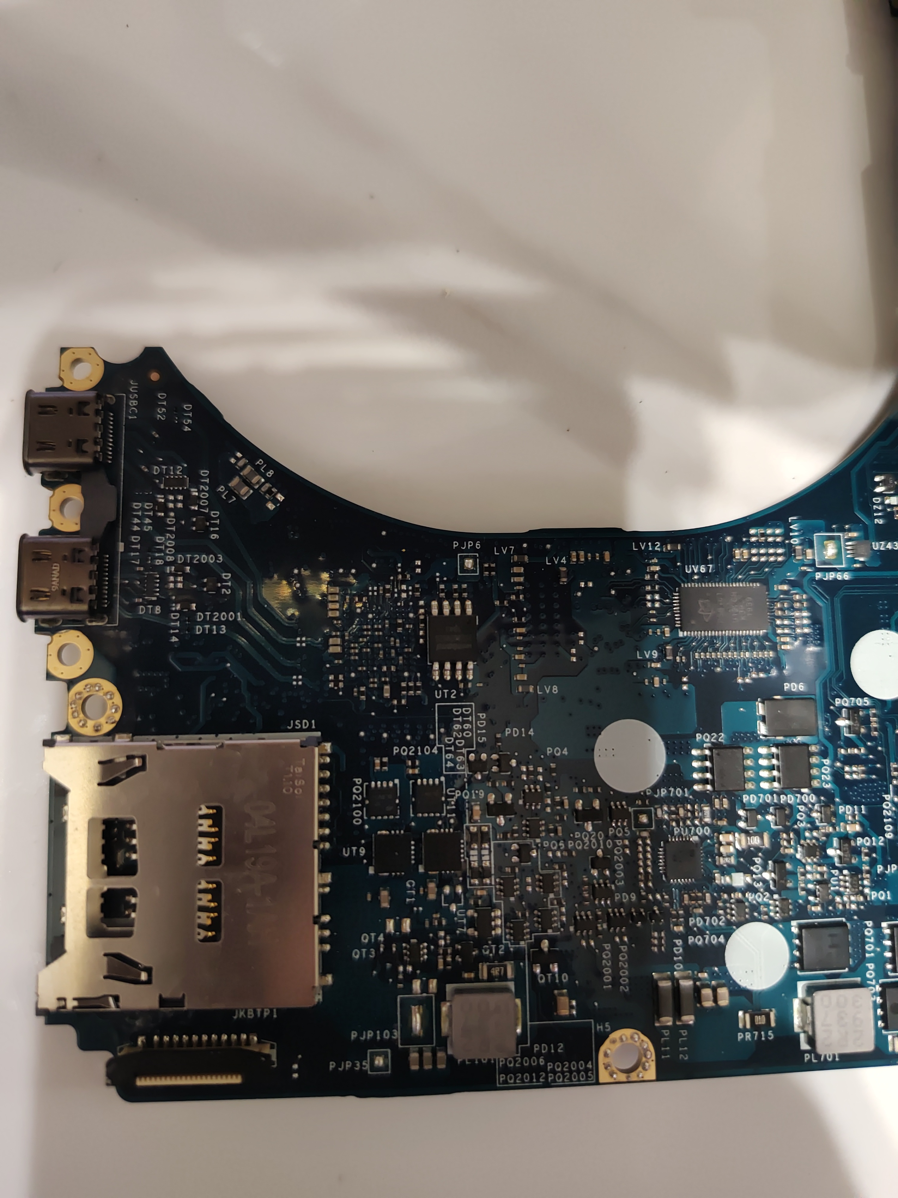

            Is this the BIOS, because when I read it it shows data like dell model number and ports configuration, but the bin file size is only 1024k
            And this is my programmer device.

              Originally posted by lapfix
              UC5 capacity !
              How to read it, the clips can't connect to it.
              • lapfix
                • Mar 2020
                • 2765
                • my workshop
                motherboard model
                Please don't use this clip
                second picture it's not your bios
                • dr_crx
                  motherboard model
                  Thank you for the help,

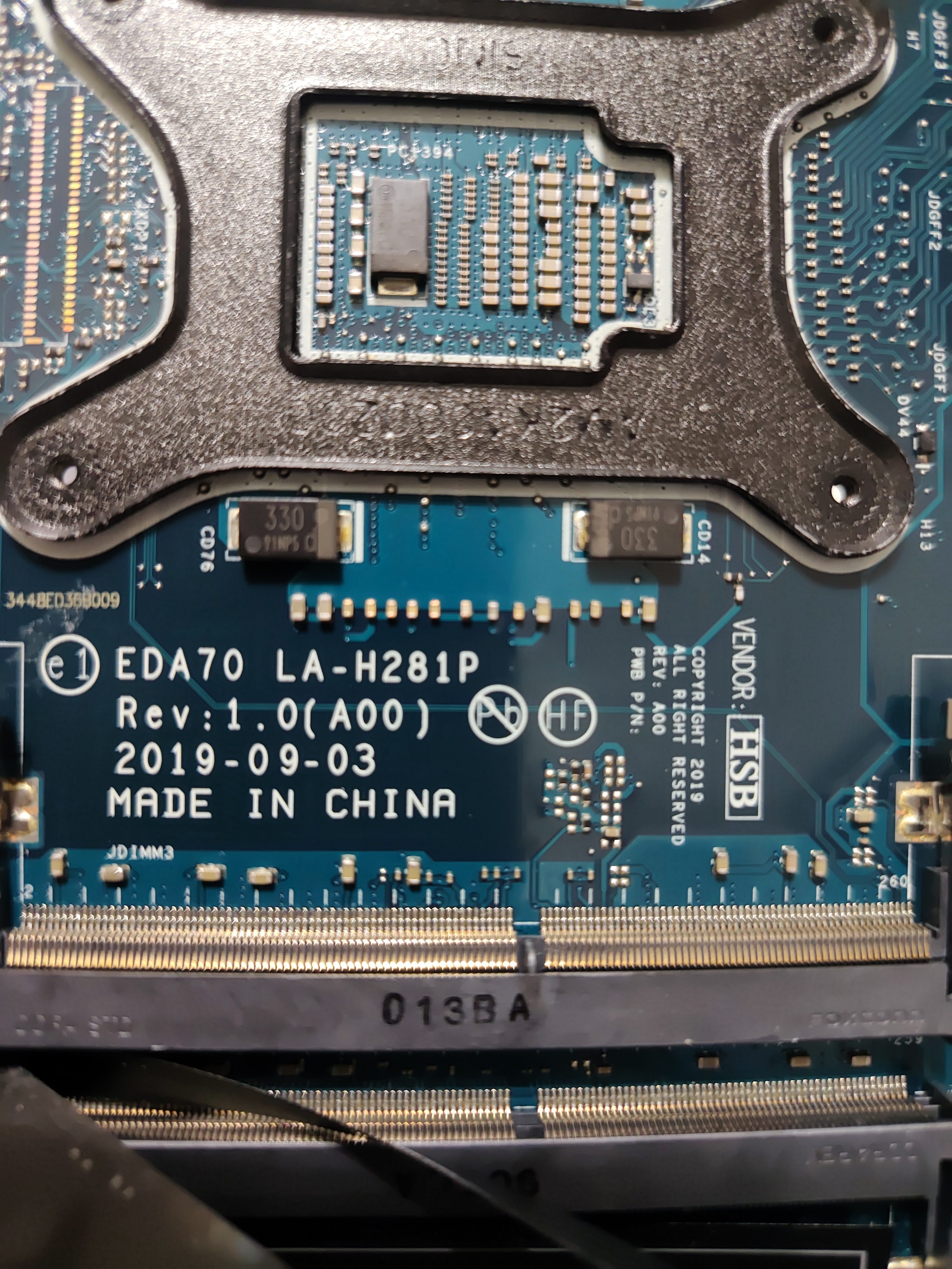

                  This is the pic of the motherboard model.

                    • dr_crx
                      • Jun 2025
                      • 17
                      • usa
                      I found the motherboard model number.
                      I attached the photo.

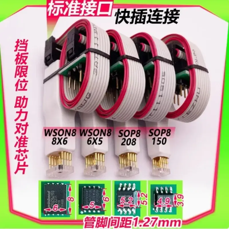

                      • lapfix
                        • Mar 2020
                        • 2765
                        • my workshop
                        UC5 is your bios = W25Q256JVEIQ
                        It's a WSON8_8X6 , you can't read it with clip...you must desoldered from motherboard and read it with programmer
                        Yes UC6 isn't populateted at your motherboard

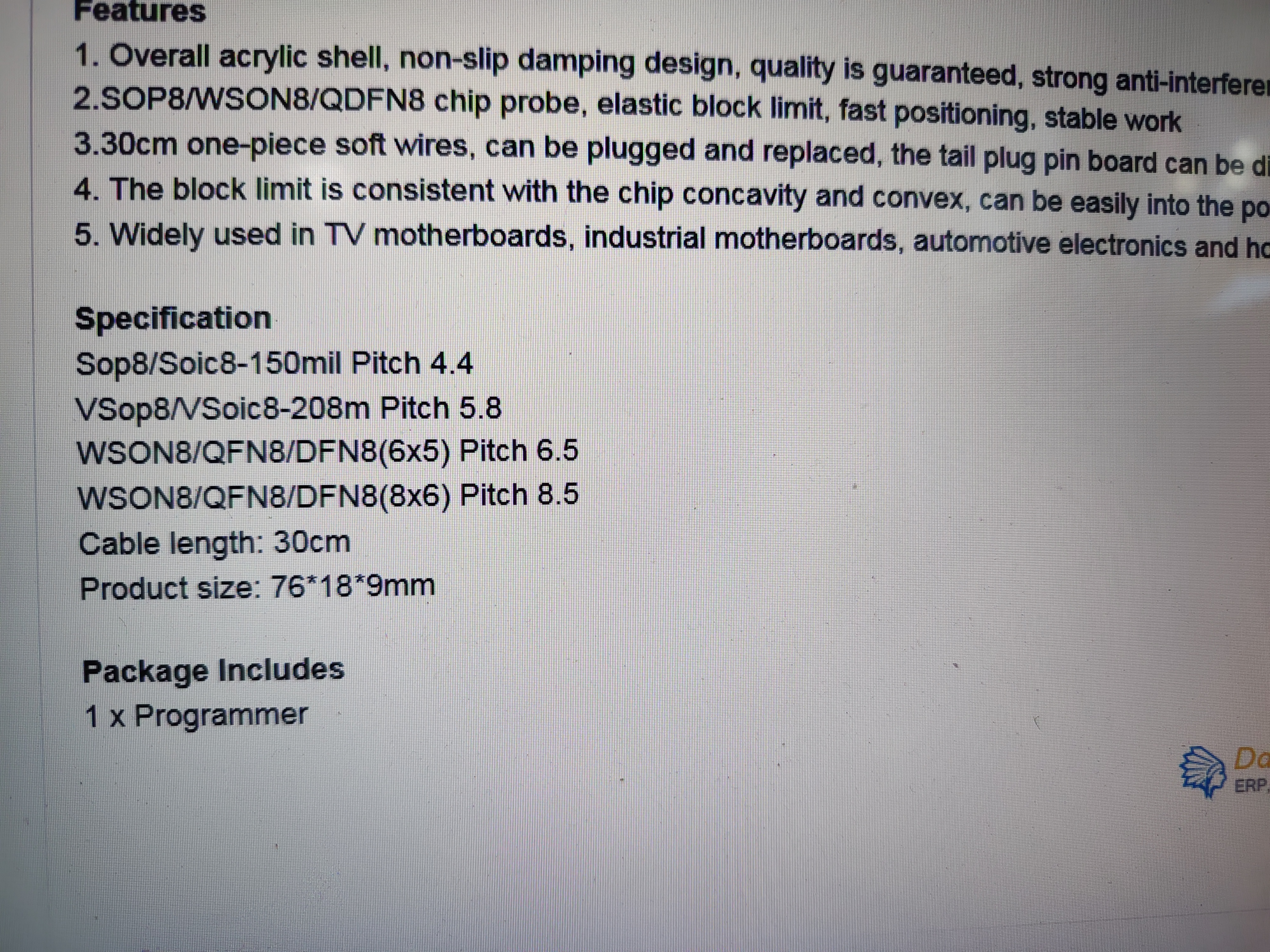

                        You can read it using this clip
                        Wson8 8x6 and wson8 6x5
                              Thank you so much.
                              Which one I should buy?
                              • lapfix
                                • Mar 2020
                                • 2765
                                • my workshop
                                For the new laptop that use generally a QFN bios chip , the 2 models ...wson8 for bios chip with 8x6 millimetres dimensions and the second for 6x5 millimetres.
                                For the laptop that use a soc bios chip i think sop8 208 millimteres is OK
