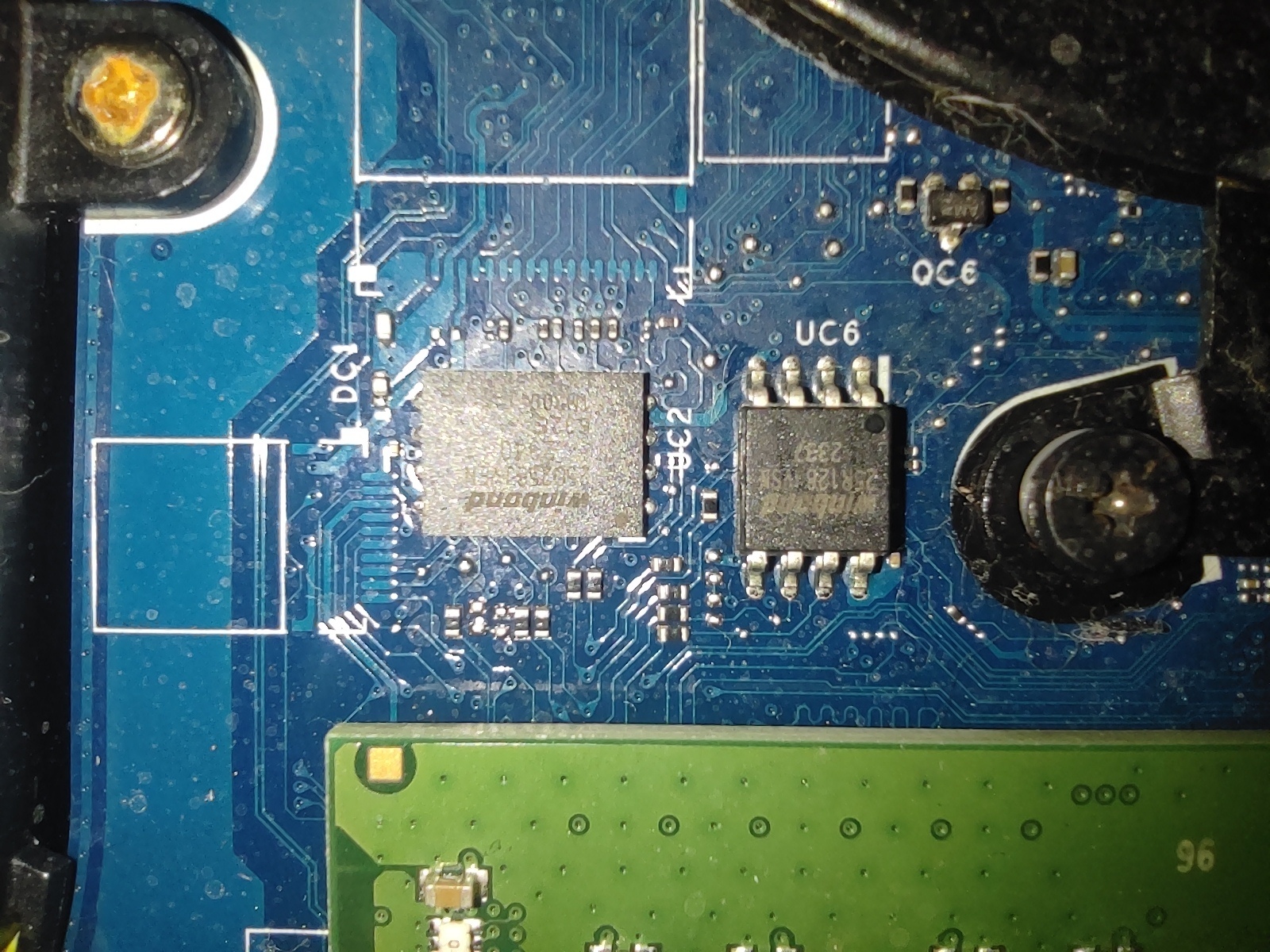

              • Darren Hibbert
                • 102
                Hi.
                Am about to use the patcher software on my Dell 5440. I opened it up to use my CH-341A on the bios chip but noticed it had 2. My CH-341A only has the connector size Click image for larger version
ID:	3610785 for 1 of the chips. Which chip in the picture do I use to read and write to?
                Many thanks.
                  • 20781
                  Originally posted by Darren Hibbert
                  Hi.
                  Am about to use the patcher software on my Dell 5440. I opened it up to use my CH-341A on the bios chip but noticed it had 2. My CH-341A only has the connector size for 1 of the chips. Which chip in the picture do I use to read and write to?
                  Many thanks.
                  If the suffix is 8FC8 it will be in the SOP8 chip.
                  • Darren Hibbert
                    • 102
                    #29
                    All done. The patcher worked perfectly 😊😊
