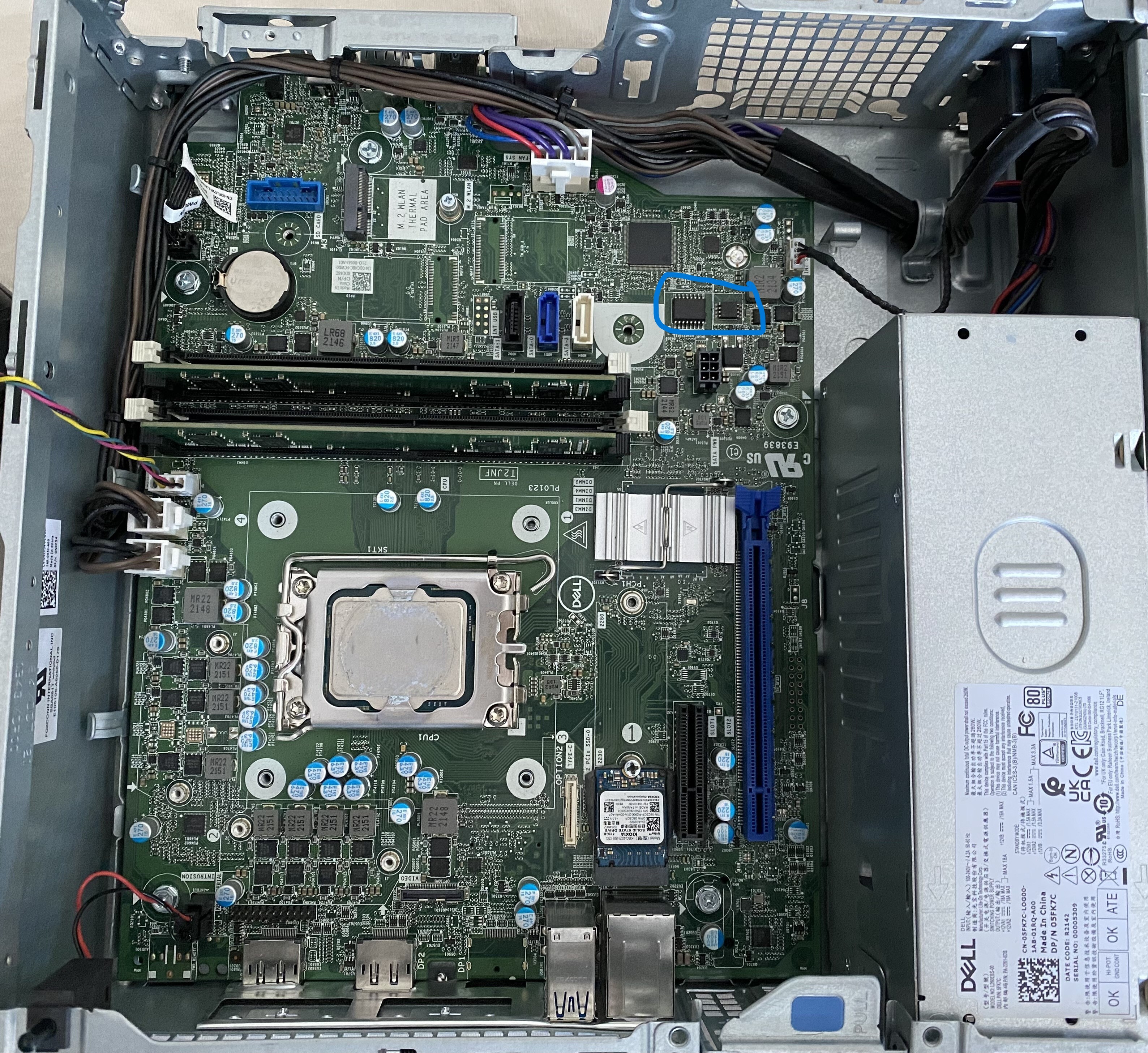

    Hey, i bought a Dell Optiplex 5000 8fc8 with chip W25Q128JVSN.
    I also used the CH341A programmer but my usb cable (i didnt attach it directly into the pc, i used a cable between) was corrupted. So i made a dump. Then i removed the password but unfortunately the dump had a loose contact so it was corrupted. And i've also overwrited the chip and now i dont have any dump anymore.
    Can someone help me? I am stuck since hours and i cannot find any bin file anywhere.
    I tried to extract the EXE for BIOS installation from dell and also the rcv file but i didn't manage to do that.
    Thank you very much!

    Service Tag is 2MMYPP3-8FC8

      In case u need the old BIOS. I also bought a BIOS dump but i tried to write it, it starts the cooler to the max and no screen. With my old bios that doesn't happen, but it's just black screen. Mainboard is E93839
      Thank you guys
        Thank you guys
        need one more 16MB or 32mb on your mainboard
          Hey, I only have one chip on my mainboard and the „my_old_bios.rar“ contains the 16mb dump of it.
          its a 5000sff and as I know they only have 16mb or am I wrong?
            have 2 BIOS chip, maybe one 16mb (SOP8) and 32mb (SOP16)

              I can’t find it only one
                here
