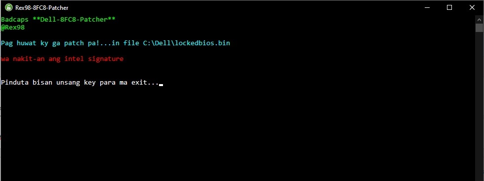

              I'm trying to run the patch, but it returns an error saying "wa nakit-an ang intel signature."
              I don't know where the error is. I'll tell you what I'm doing in case anyone can help.
              The computer is a Dell D15U, OptiPlex Micro Plus 7020. It's functional, but has a BIOS password (8FC8). I read the 25R256 chip (32MB) with an SVOD4. When I run the patch, I get the error mentioned above.
              Thank you very much for your help.

                Software looked for 5AA5F00F03 in your dump, and didn't find it.
                Are you sure, you picked the right chip.

                  Better you post your bios

                    Did you download recently the newest version (from first post), that one is in English.

                      I've already found the error. There were actually two errors.
                      The first was that I was using the wrong BIOS. I had to work with the smaller one, the 16MB one.
                      And the second error was that the first dump of that BIOS I used was with tweezers without desoldering it. And it seems the binary file was incorrect.
                      Everything's fine now. Thank you all very much.
