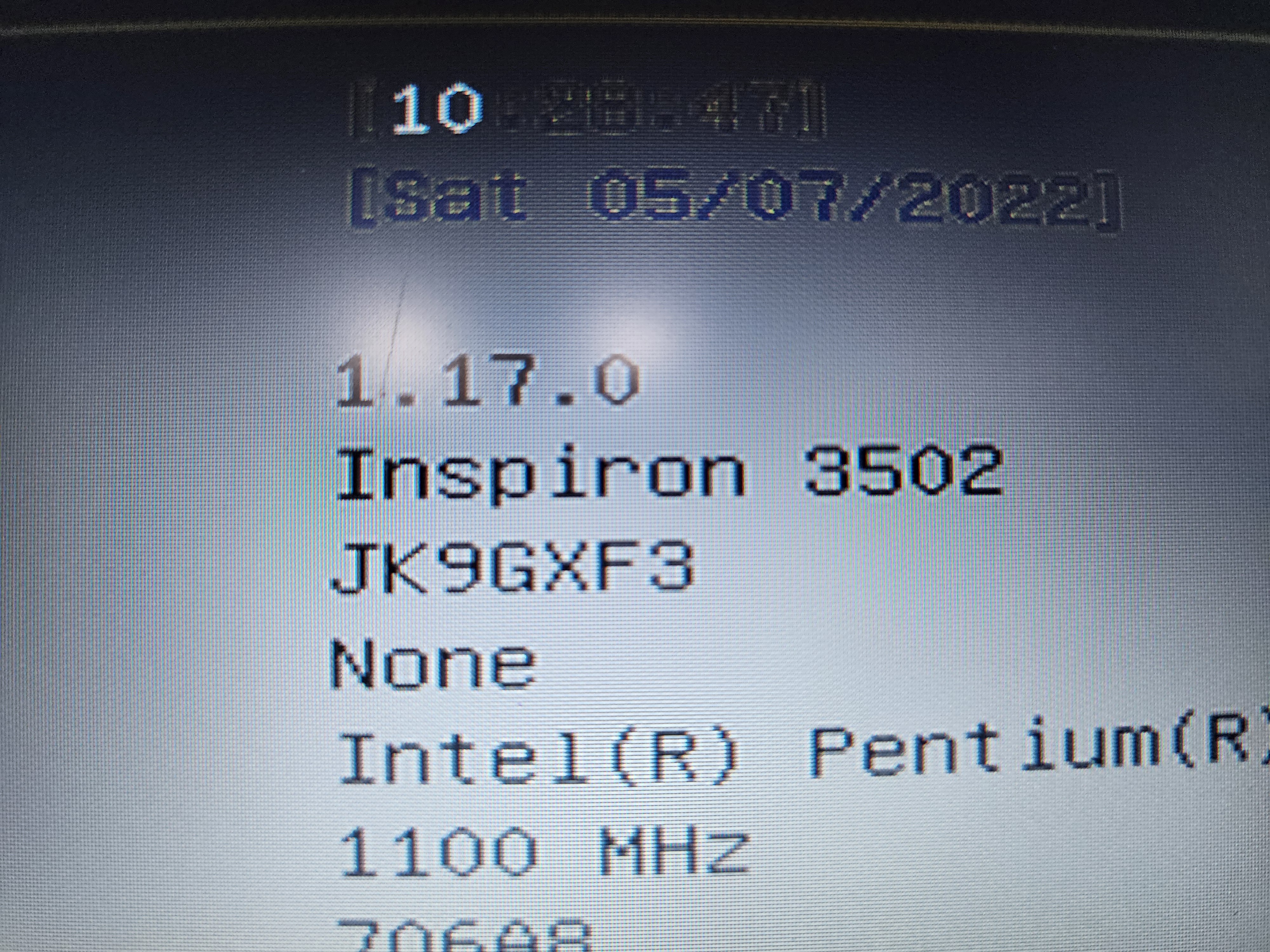

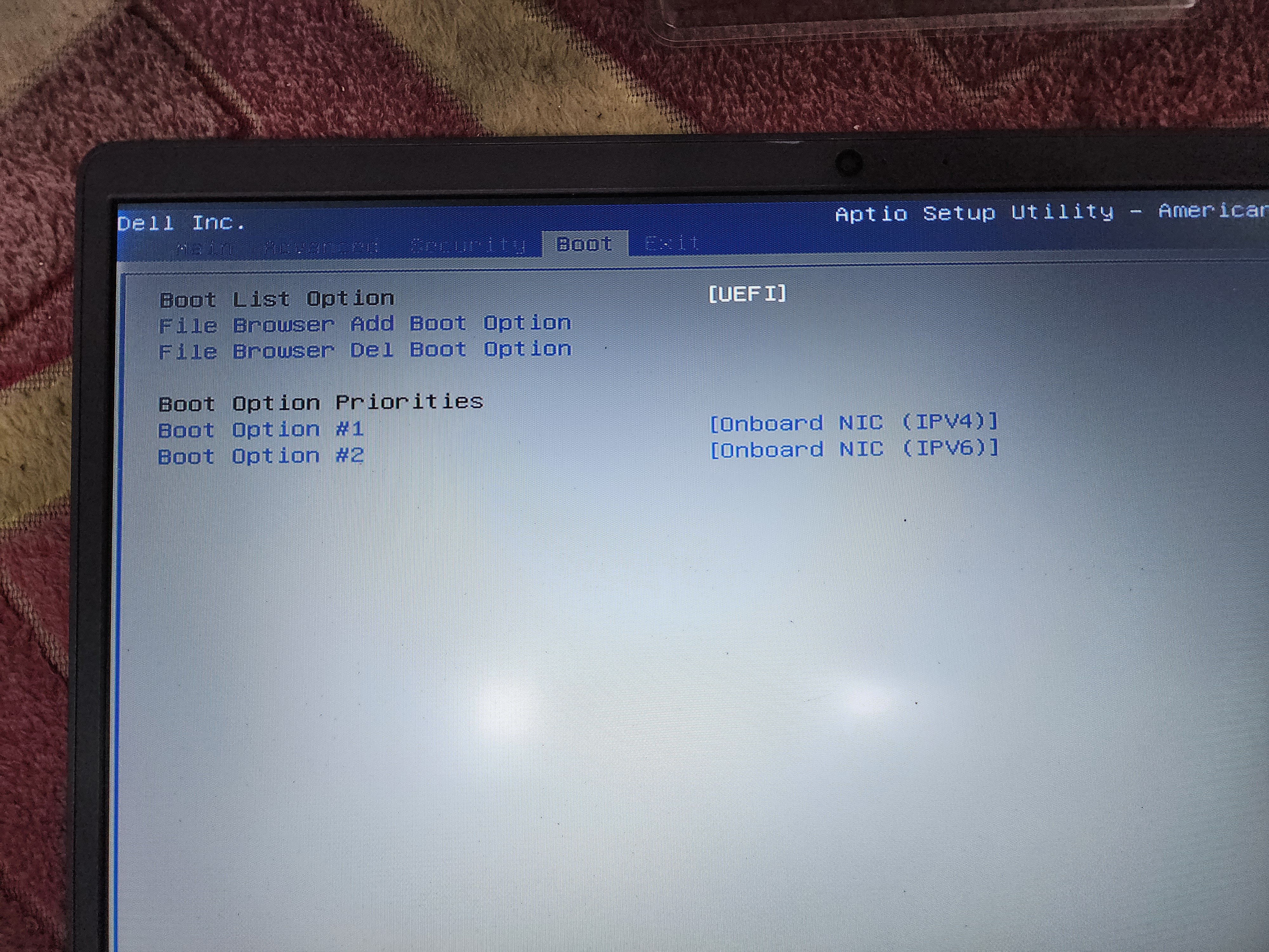

    This laptop came to upgrade primary storage to a nvme and hinge repair. Once we disassemble and reassemble it, startup screen shows no bootable device.
    When F12 pressed it shows UEFI bootable devices such as USB flash and nvme but didn't boot to either devices.
    Then I tried to change boot mode but it only shows legacy option and cannot be changed.
    I uploaded the original BIOS backup .
    Update:
    I tried few BIOS from the internet and all of them shows CPU error blinks once turn on the laptop. I think all of those for compatible with this CPU. this one has Pentium Silver. (Intel(R) Pentium(R) Silver N5030 Processor). There are two models (3502 and 3582) came with same motherboard.

    Post the service tag.... https://www.badcaps.net/forum/troubl...before-posting

      Originally posted by SMDFlea
      Sorry.
      Service tag: JK9GXF3

          Originally posted by kandyan
          I think all of those for "NOT" compatible with this CPU. There was a small typo. caps lock blink error for CPU showed when I flashed this BIOS to this motherboard
          Inspiron 3502
          Service Tag: JK9GXF3​

            Originally posted by hoaca388
            Inspiron 3502
            Thank you. This file worked and can be accessed to the UEFI boot mode now.
