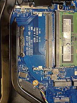

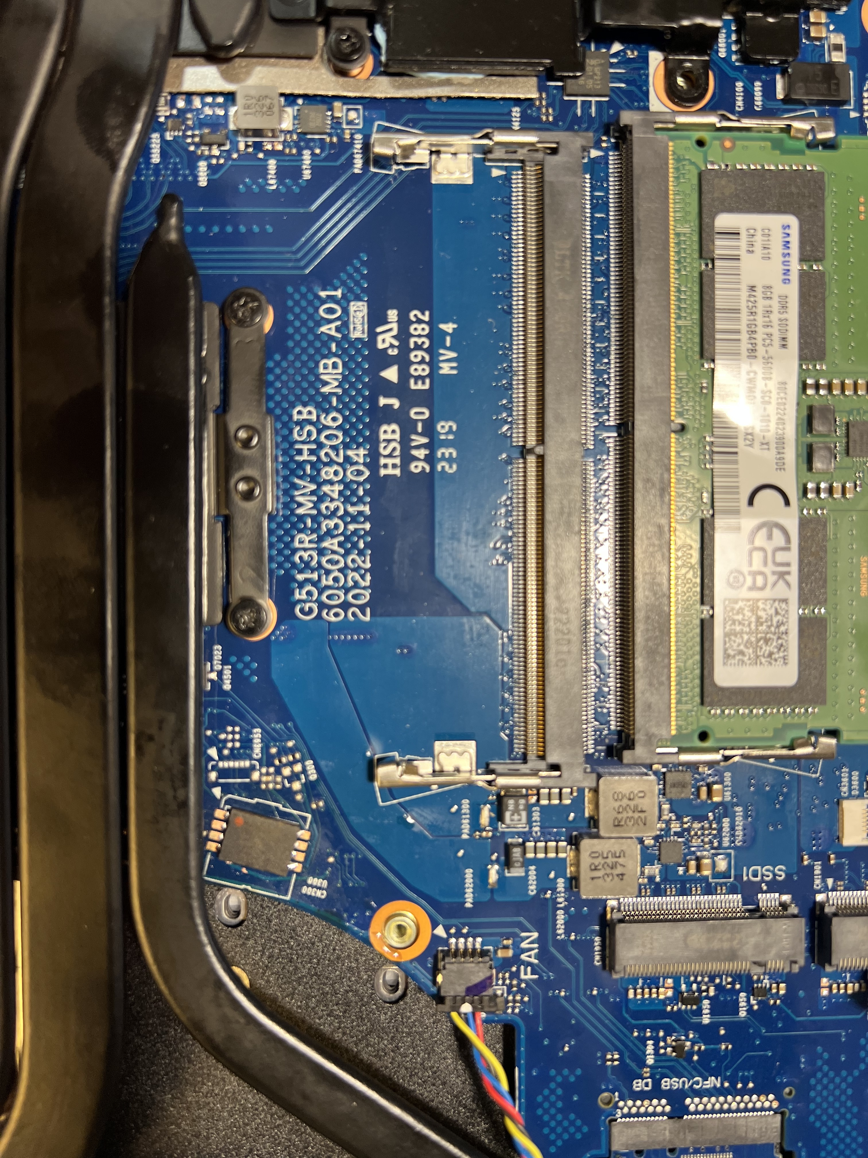

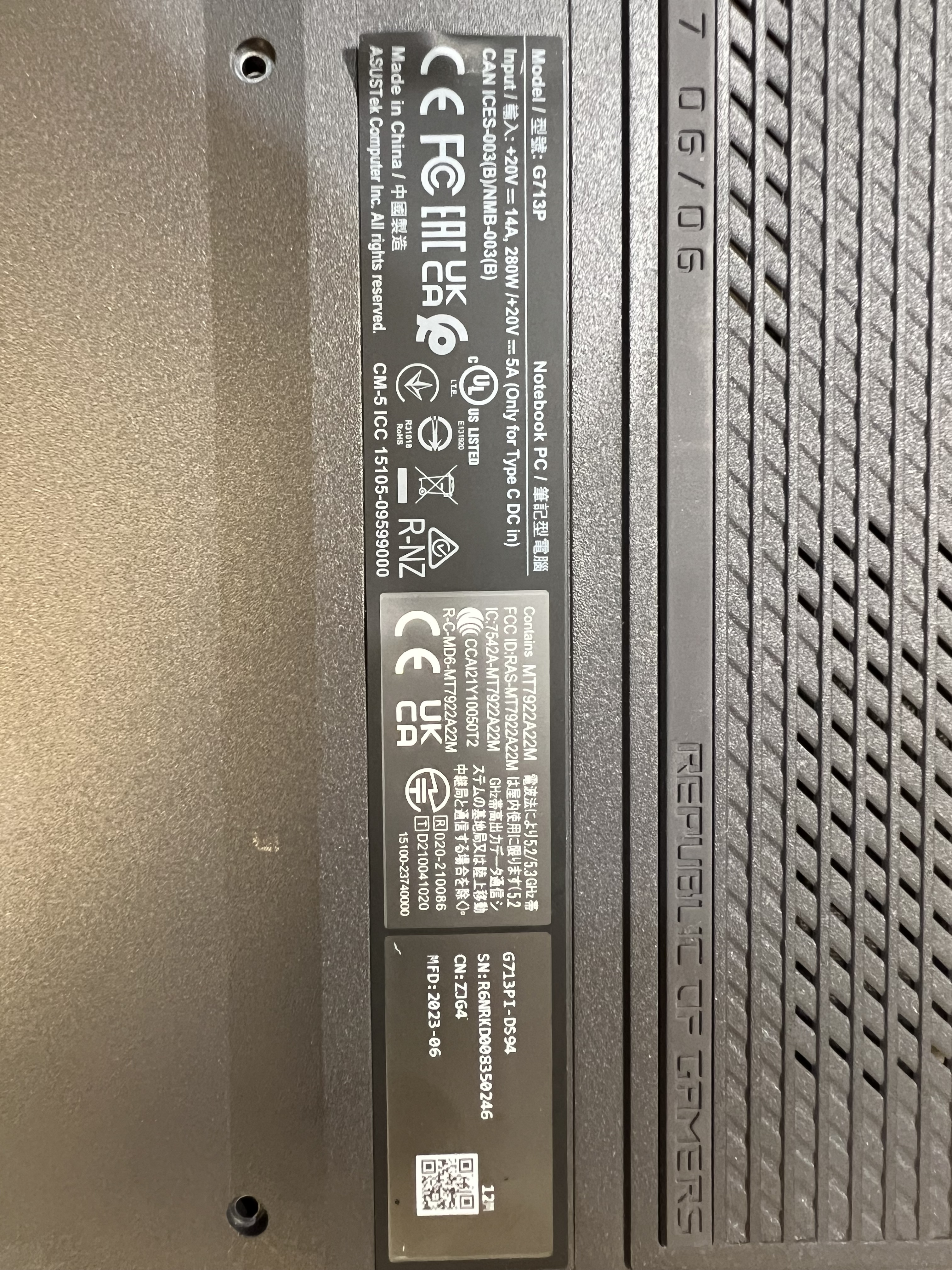

                  Hi, please help me. I got a laptop for repair -
                  Asus G713PI-DS94
                  CN:ZJG4
                  G513R-MV-HSB
                  6050A3348206-MB-A01
                  The BIOS was flashed with a non-original one, and there is no start. I found and downloaded the original BIOS from the official site by serial number. - cut off the part for the bootloader - no luck. Found and downloaded several BIOSes from Vinafix - on one there was a reaction to the button. The voltage on the board increased - but the screen was black, USB detection was not carried out by the board.
                  Maybe someone has or had such a laptop in work and you can share the dump. Thanks.

                    • Kim_555
                      PRO.
                      • Jan 2014
                      • 7
                      • Now I'm in Chicago
                      Click image for larger version  Name:	IMG_6319.jpg Views:	0 Size:	3.42 MB ID:	3718100 Click image for larger version  Name:	IMG_6318.jpg Views:	0 Size:	2.88 MB ID:	3718099
                      Originally posted by shiyab
                      post backup bios and snid
                      Thanks for reply,
                      R6NRKD008350246
                      Unfortunately, there is no original BIOS. It is lost, the laptop came into my hands after another repairman
                      I tried searching by serial number on the Asus website, cut off the excess (what is for the flasher utility) - there is no reaction to the button, the power does not rise, the battery does not charge.
                      I attached the file that starts the laptop, but in it, the search only finds the model 513

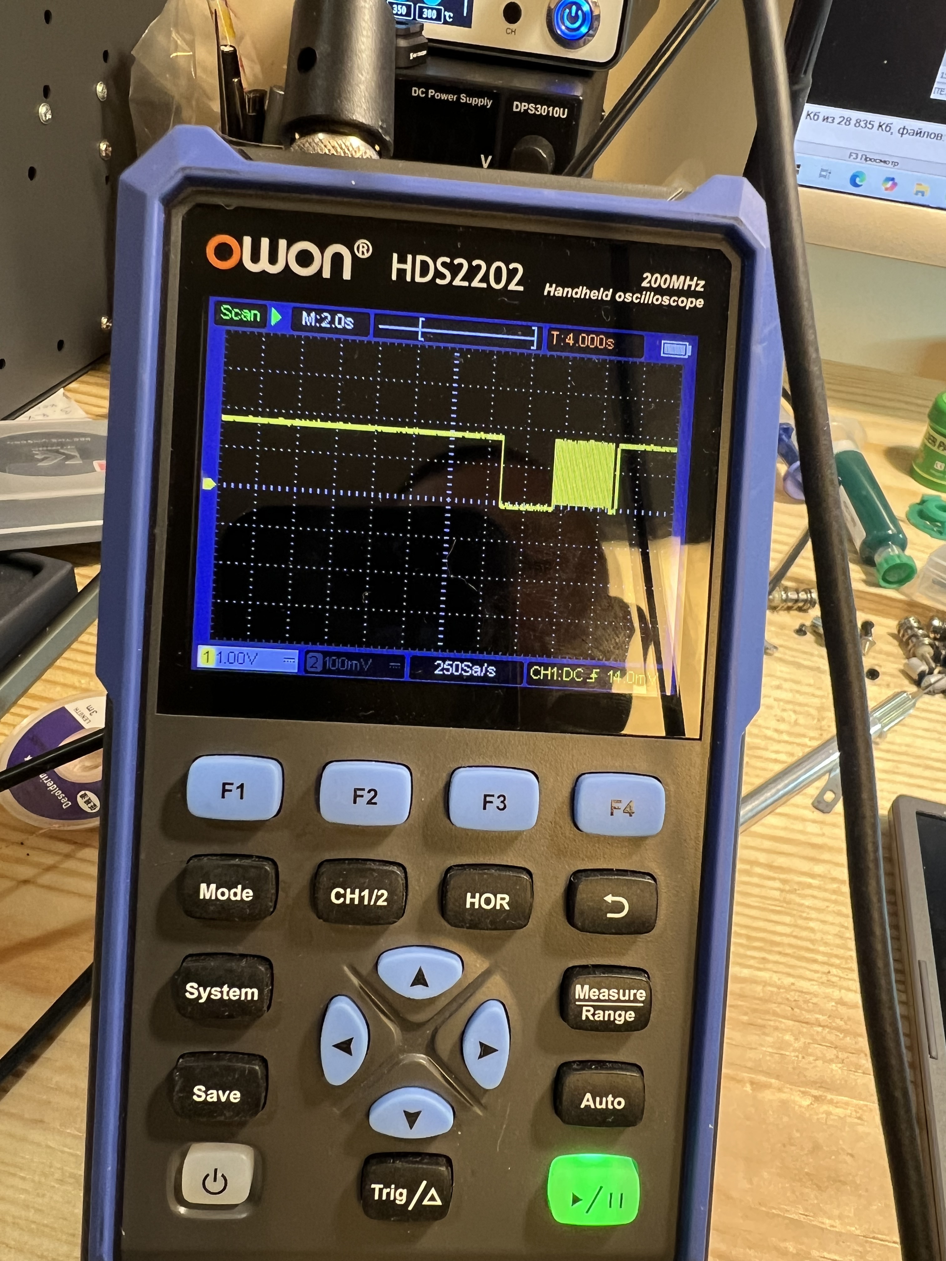

                        • Kim_555
                          PRO.
                          • Jan 2014
                          • 7
                          Hello, thank you very much, but unfortunately there is no result.
                          There were difficulties with flashing the multicontroller, I had to unsolder it and flash it forcibly through the qfp128 socket
                          after connecting the power supply - with this BIOS autostart, the data packet is read and then - black screen. memory power supply (for example) does not rise.

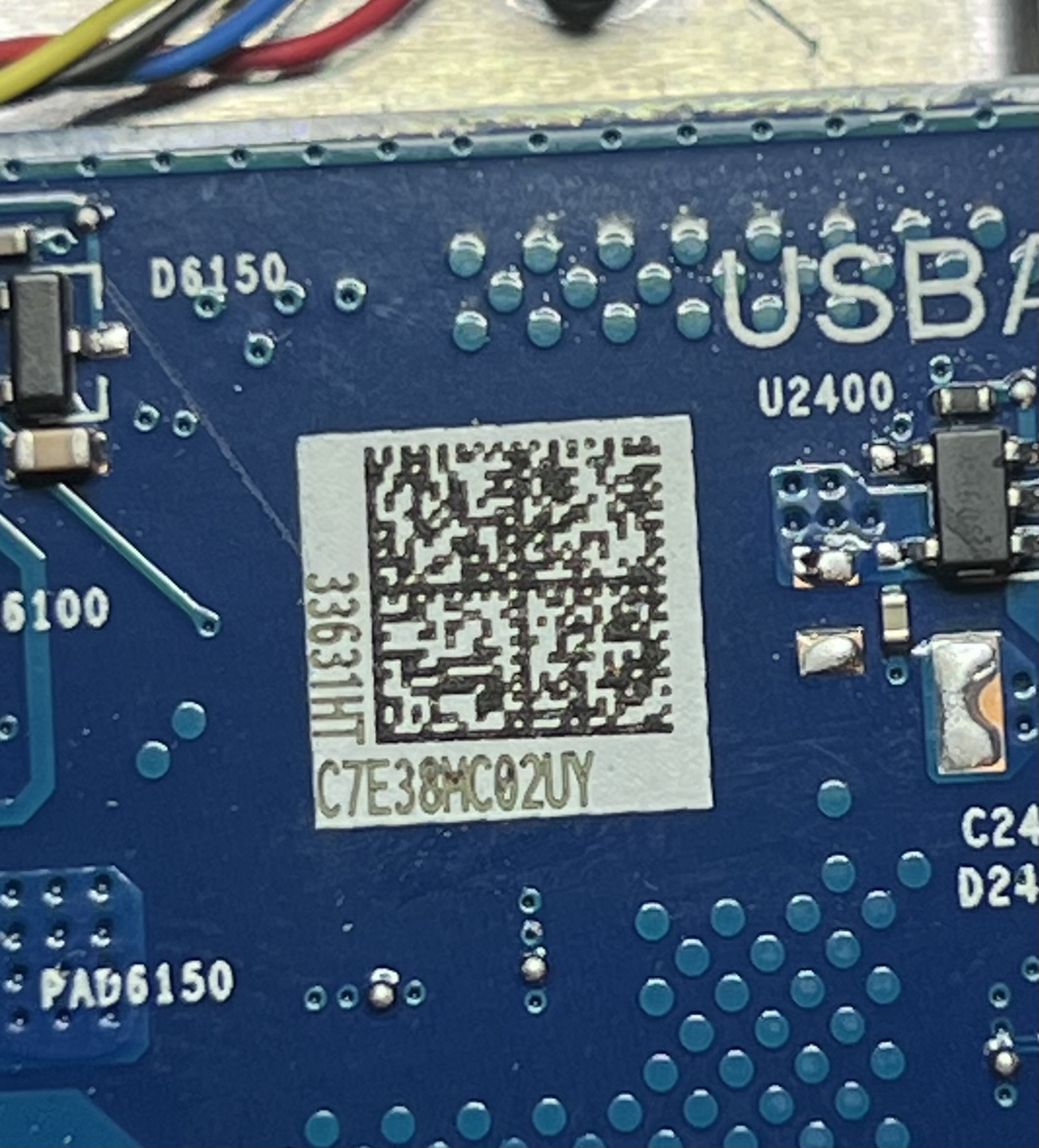

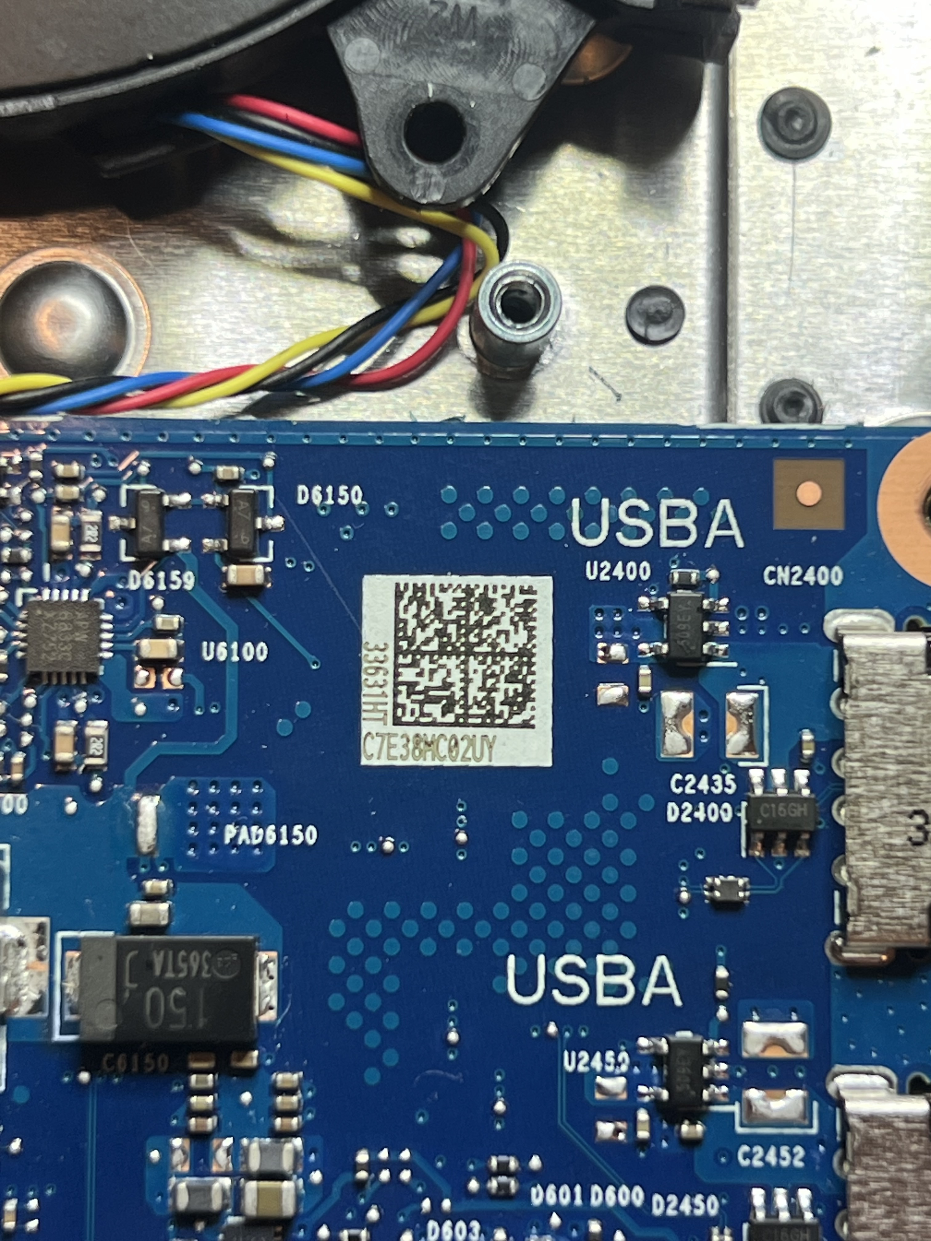

                          • m1ch43lzm
                            • Mar 2019
                            • 932
                            • Peru
                            Post a clear picture of the QR code near the USB ports on the motherboard
                            I'm guessing this motherboard doesn't match a G713PI (2023) but a G513R/G713R (2022) variant
                            • Kim_555
                              PRO.
                              • Jan 2014
                              • 7
                              Click image for larger version  Name:	IMG_6336.jpg Views:	0 Size:	507.3 KB ID:	3718654 Click image for larger version  Name:	IMG_6335.jpg Views:	0 Size:	1.86 MB ID:	3718655
                              Thanks, here are photos
                              Most likely, this is some kind of "transitional" model, although the case indicates that it is 2023. The history of this laptop is also unknown, I suspect that there could be other problems with the processor, but someone tried to flash the BIOS, and did not save the original. I tried to search in the dump - which was sewn to me - the serial number of the laptop was unfortunately not there....
                              but what is known for sure is that the behavior of the motherboard is different for different dumps
                              • m1ch43lzm
                                • Mar 2019
                                • 932
                                • Peru
                                Code:
                                C7E38MC02UY,R835NRKD000VEVMB,G713RC,60NR08F0-MB2060,600,E89C2580228F
                                Try with G713RC BIOS
