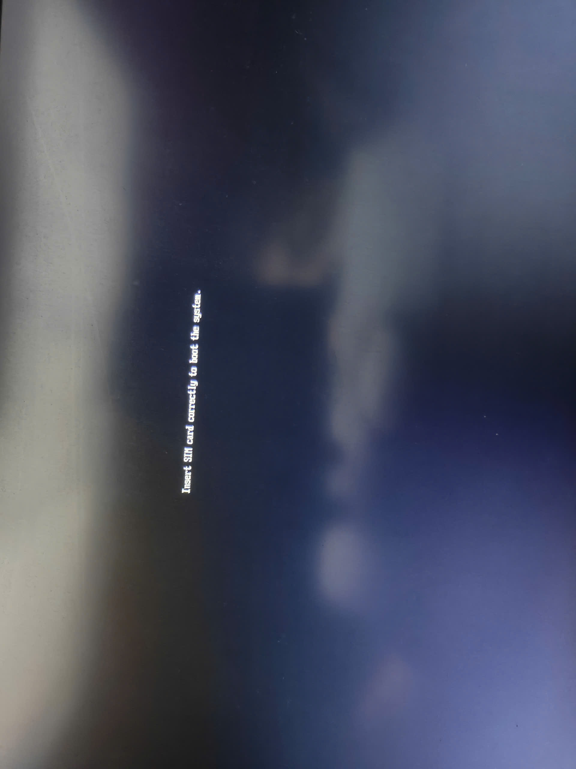

    Dear all, I have a panasonic laptop with message "Insert SIM correctly to boot system". I tried with the SIM but it cannot bot to OS.
    Could you please help me? I attack the bios bellow. Thank alot.

    post the S/N, post the original content of the bios chip, the motherboard model,the full name and model of the laptop,etc.

      I attached the original bios chip, the S/N is 9LKSC45051, motherboard model is Cf-SZ6, model is Panasonic CF-SZ6.

        Send to you, try !!!

          Dear anh Minh,
          I tried but it not work for me, the "Insert simcard...." message still remain.

            Try again !!

                Thank you very much. I also encountered the "Insert simcard...." problem. Could you tell me which field I should modify?

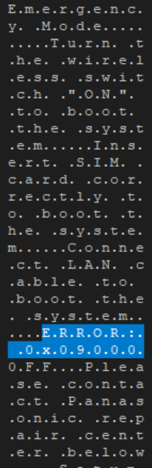

                    Is this message present before removing the password?
                    I don't know this model or this error?
                    a module is interesting and checks the status of the simcard : EmergencyMode
                    InvalidPasswordCount SelfDefenseInvoked Is Stolen
                      Yes, “Insert SIM card correctly to boot system”.

                        Try
                          It works fine.
