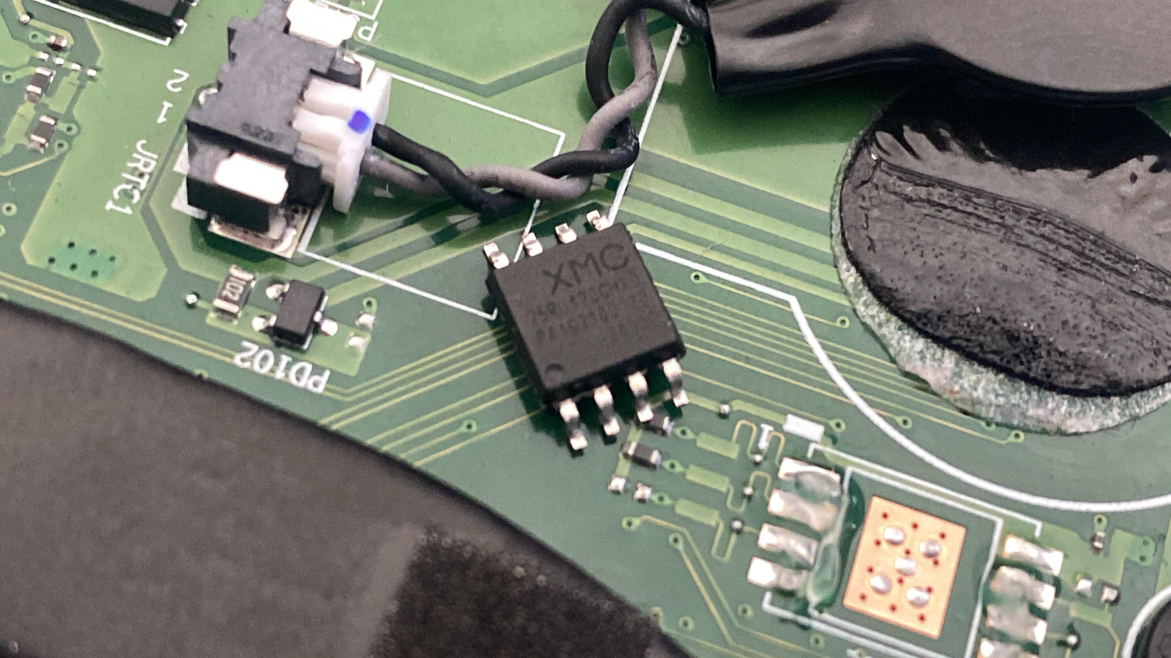

            Hello everyone, it may seem like a novice but I can't find the Rom Bios, the one I unsoldered with the data that is silkscreened on the component does not appear any information on the internet and when unsoldering it and placing it in the CH431A or the EZP2019 + it does not detect it at all not even with the 1.8V volt adapter, could you tell me if I am choosing the correct component, I have looked for the Schematic but I can't find it either, it is a JS471 / JS573 Lenovo 15ALC7 Motherboard
              • 21841
              When the chip isn`t in the support list choose a different one for example W25Q128JW

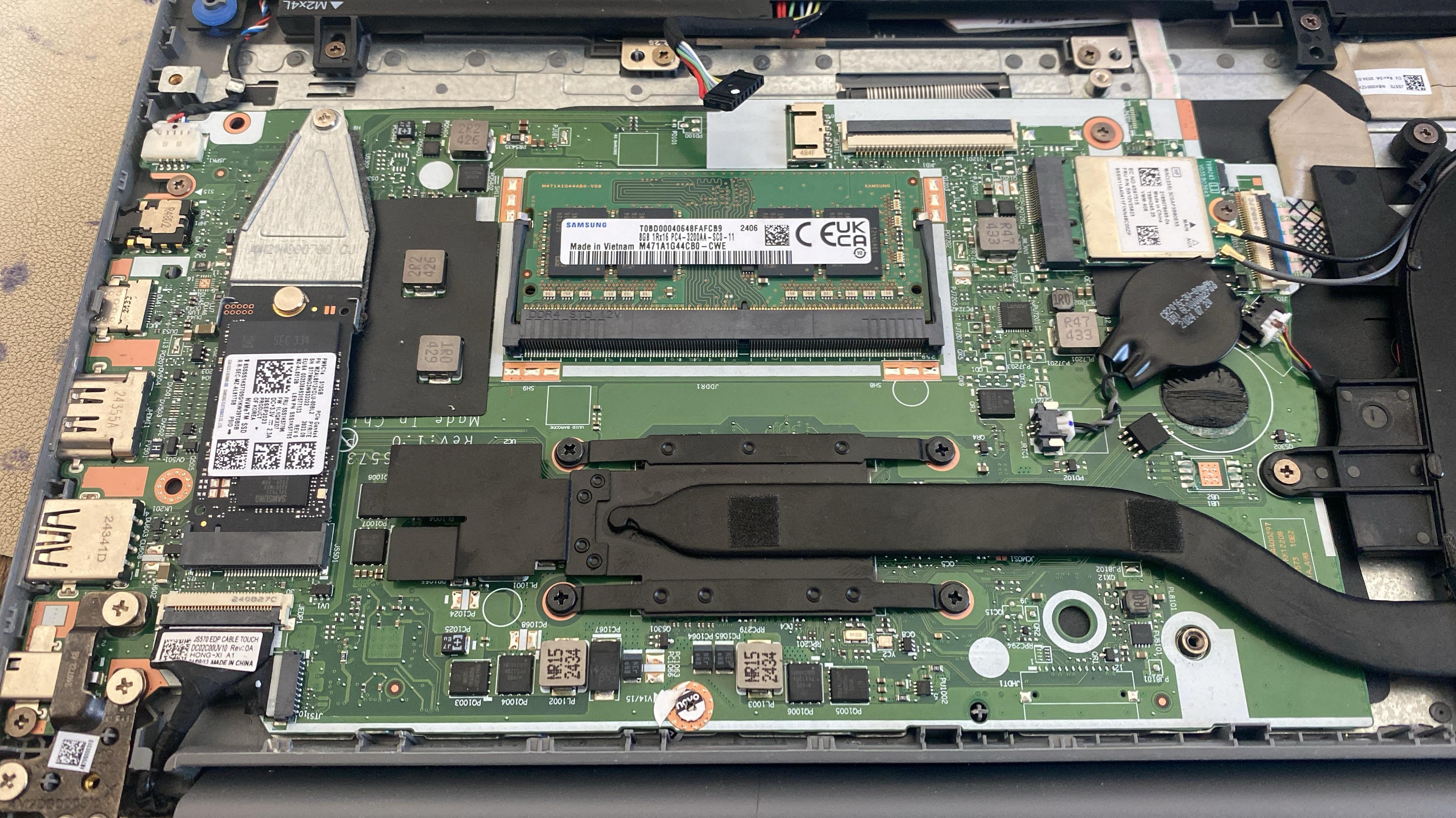

                    Hi everyone!
                    I have Lenovo IdeaPad 1 15ALC7 (NM-E541) with no power, board have only LDO 3V and 5V. No EC_ON_5VALW_R from EC (IT8227VG-256CX). If I erase EC controller firmware then got 1.8V and 5V, after that EC get it's firmware from main BIOS and again "no life" on board. May be anyone can help found out the reason?
                    Main board: NM-E541
                    S/N: PF4RAVW7
                    Device is out of warranty, because was liquid damaged.
                    Need to know what is necessary for EC to bring EC_ON_5VALW_R ON
                    main BIOS dump attached.

                      Thread merged. Read post #2 ,just copy your DMI to the new bios using a hex editor, copy/paste
                  • Artuha
                    • Mar 2018
                    • 30
                    • Latvia
                    Tried this, without success, still no EC_ON_5VALW_R
                      SMDFlea commented
                      Editing a comment
                      probably a bad EC chip

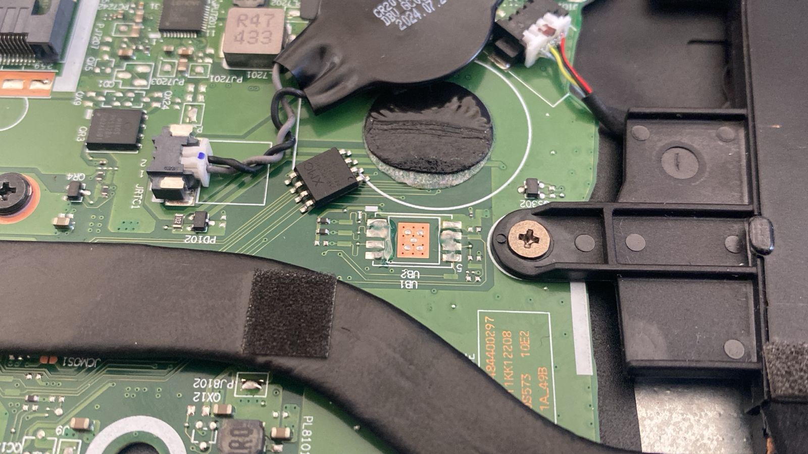

                    I have this laptop with a GD25LR128. Not available on TL866II.
                    someone can help me?? Maybe choosen another ic?? Or I’m wrong and this is not the Bios ic??
                    Thank you
                      Thank you
                      you can manually choose an equivalent chip...
                      • m1ch43lzm
                        • Mar 2019
                        • 895
                        • Peru
                        Thank you
                        Try selecting GD25LQ128C/D/E

                          Originally posted by Artuha
                          Hi everyone!
                          Main board: NM-E541
                          S/N: PF4RAVW7
                          Try EC firmware extracted from your BIOS, cut to 256KB, as far as I know EC can self program only on Intel models (not on AMD)
                          Also attached EC firmware extracted from latest BIOS version JTCN60WW
