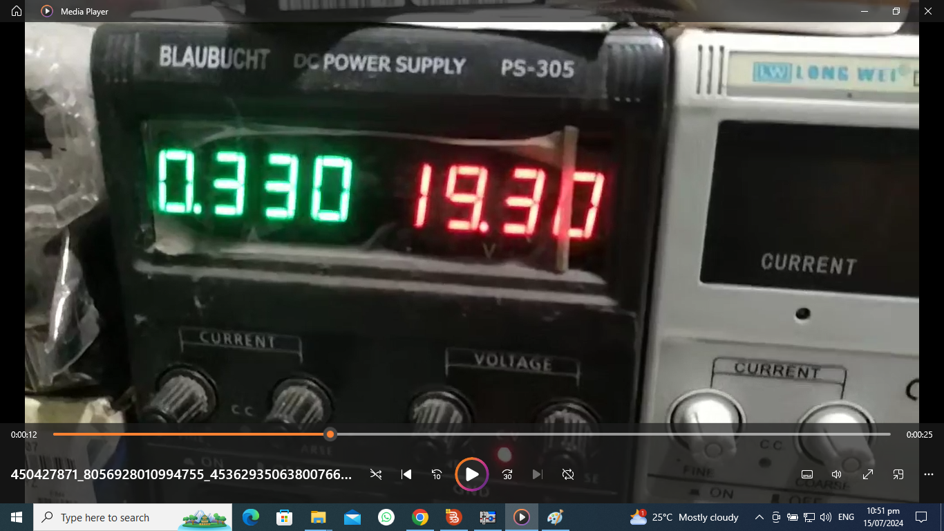

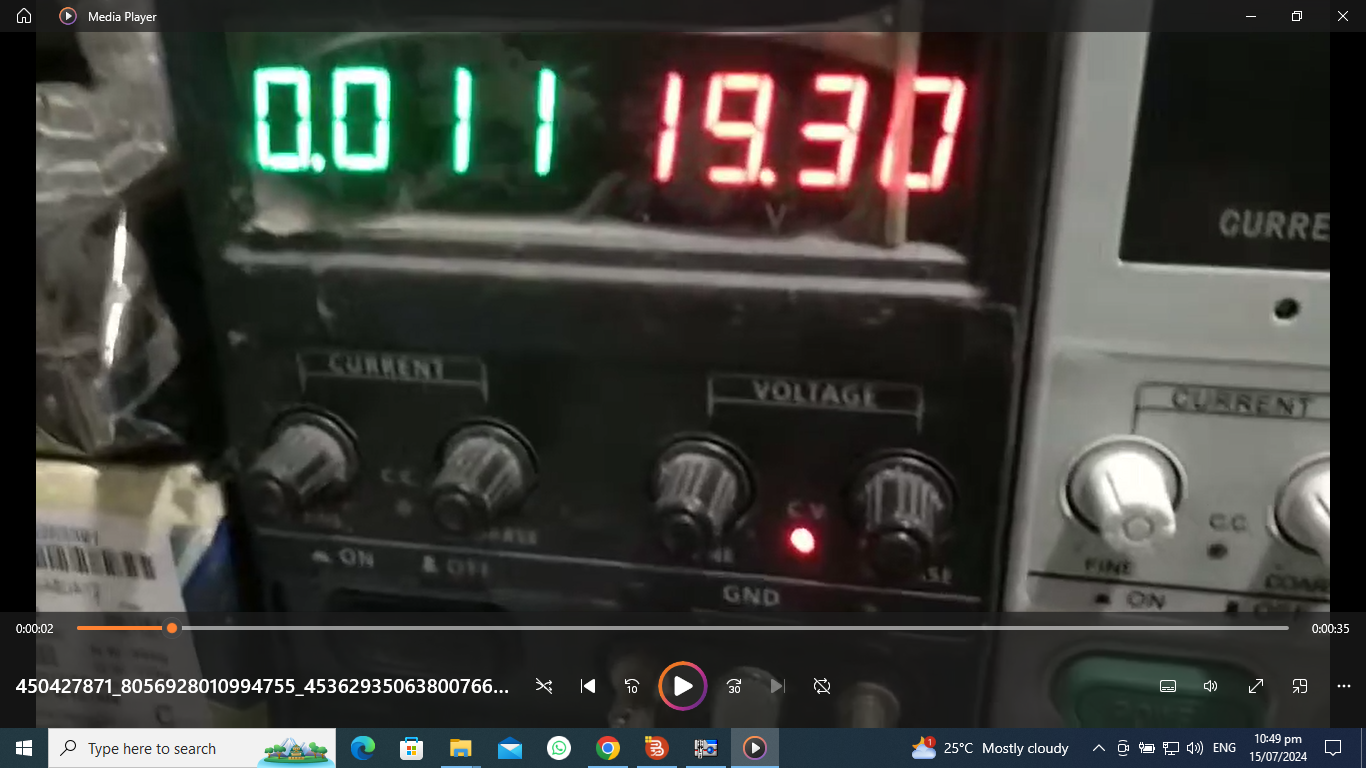

                  Update
                  bad for me its not working there might be a problem with my motherboard, please anybody help me sorting out what is the problem? It has power the fan is spinning but after 40 second it will stop the led on the keyboard lit no no display and i got 367milliamps in the power supply then if the fan stop spinning the amperes goes to 18milliamps. I don't have 3.3volts in the bios but the 5.0volts and 3.3volts is present. I ask apology if I was not at the right forum and sorry for my english.

                      if you don't have 3.3v on the bios chip, there's no way it will work... I don't think it's a bios problem... move the discussion to the main forum...
