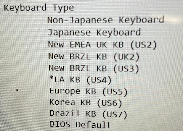

                    The machine boots fine with this image(thanks!), but I'm still getting the pre-boot warning about unlocked mode, and no OEM keyboard selected. I'm afraid to follow the bios configuration steps I linked above. WHat should I do?
                      • 21996
                      You can close MPM with BCU but first,in the config.txt file is there a section for Keyboard Type . Is the keyboard US qwerty, is the OS language set to US english
                      • survivalbloke
                        • Aug 2021
                        • 309
                        Language is set to English. For keyboard, there is no option for US qwerty. See image attached.
                          • 21996
                          Change it to BIOS default ,lock MPM and see what happens.
                          • survivalbloke
                            • Aug 2021
                            • 309
                            That broke it again Upon issuing the /setconfig command, I got a success message in green, indicating that a reboot or shutdown was necessary. Upon restart, The fans engage for about 2 seconds, cpu gets warm, caps lock key is functioning correctly, but screen is black. The power button light is on as well as the charging light. If I press the power button, the power light immediately turns off and the cpu begins to cool. This machine seems to run perfectly fine until I /setconfig.
