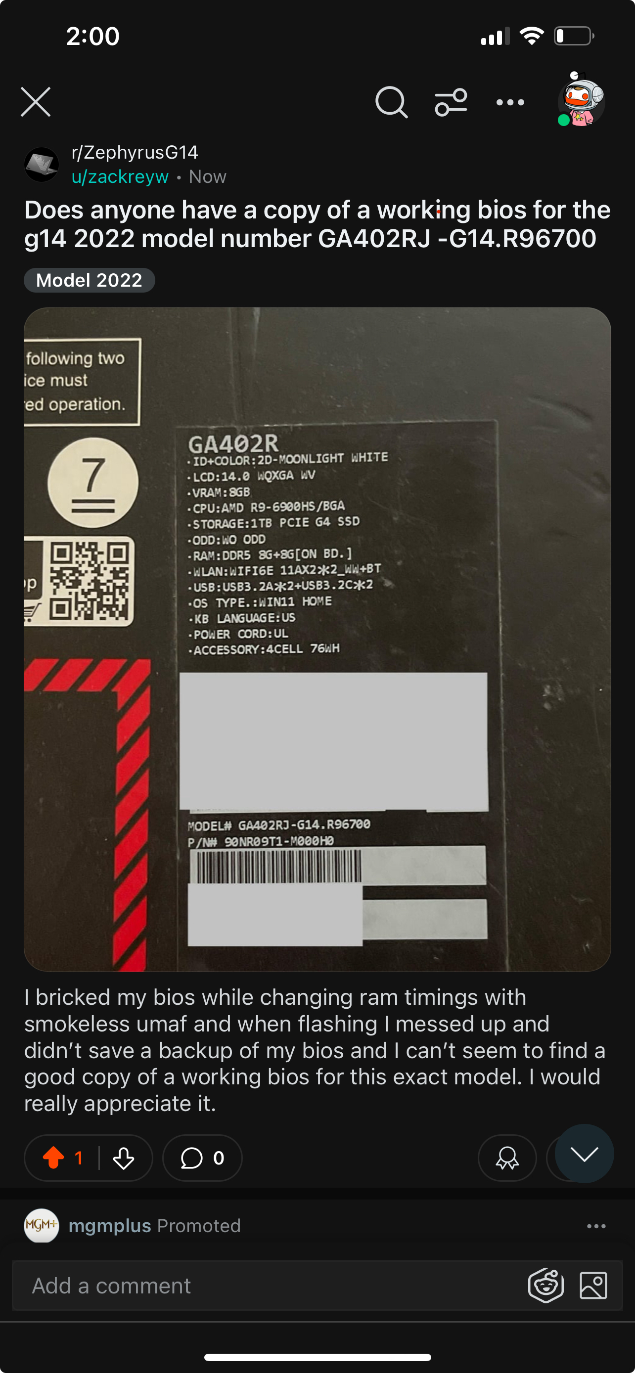

    i bricked my bios using the smokeless umaf tool and trying to tighten ram timings. i purchased a ch341a programmer and made the mistake of not backing up my bios before flashing the stock bios on the chip. i tried injecting my serial and all in the bios and then flashing but now the hdd light just blinks when powering on and nothing else. ill attach the firmware i flashed to the chip and the default i added it to. also the chip is a winbond W74M25JWEIQ. my serial is N2NRKD019645059

    I believe that the CH431A does not read the Winbond W74M25JWEIQ.
    This bios is 1.8v and would need a 1.8v adapter.​

      yes i have the adapter and can read and write. its just after writing the laptop wont power on now, the hdd light just blinks every 5 seconds.

          I flashed the chip with this rom with asprogrammer and it still just blinks every 5 seconds on the hdd light when I plug the cord up to the board. Idk if it makes a difference but even though my model on the box says g14 GA402RJ-g14.r96700 my board says GA402RK

            Any idea what could be causing the hdd light to just blink every 5 seconds? Every bios I’ve flashed to it either causes it to do nothing or causes it to blink when plugged in.

              Tomorrow I'll post your original bios (ASUS_GA402RJ_319_BIOS_Update_2)👍

                Thanks brother I appreciate it. Any idea on what I did wrong? For future reference. I extracted the padding from the backup and injected it into the empty padding in the default bios.

                  Your biggest mistake was losing your backup!

                    Try this file.

                      I finally got around to flashing this but it still just causes the had light to blink when plugging in and trying to power on. I also noticed that pin 1 on the chip has continuity to the ground pin. Could that be causing it to not power on and blink like that?

                        Remove winbond, test in reverse conduction?
                        Values must be universal.
                        It's quite possible that the (ci Winbond) burned down...
                        Take care when handling the (CH431A), especially since it is a (ci Winbond 1.8v)​

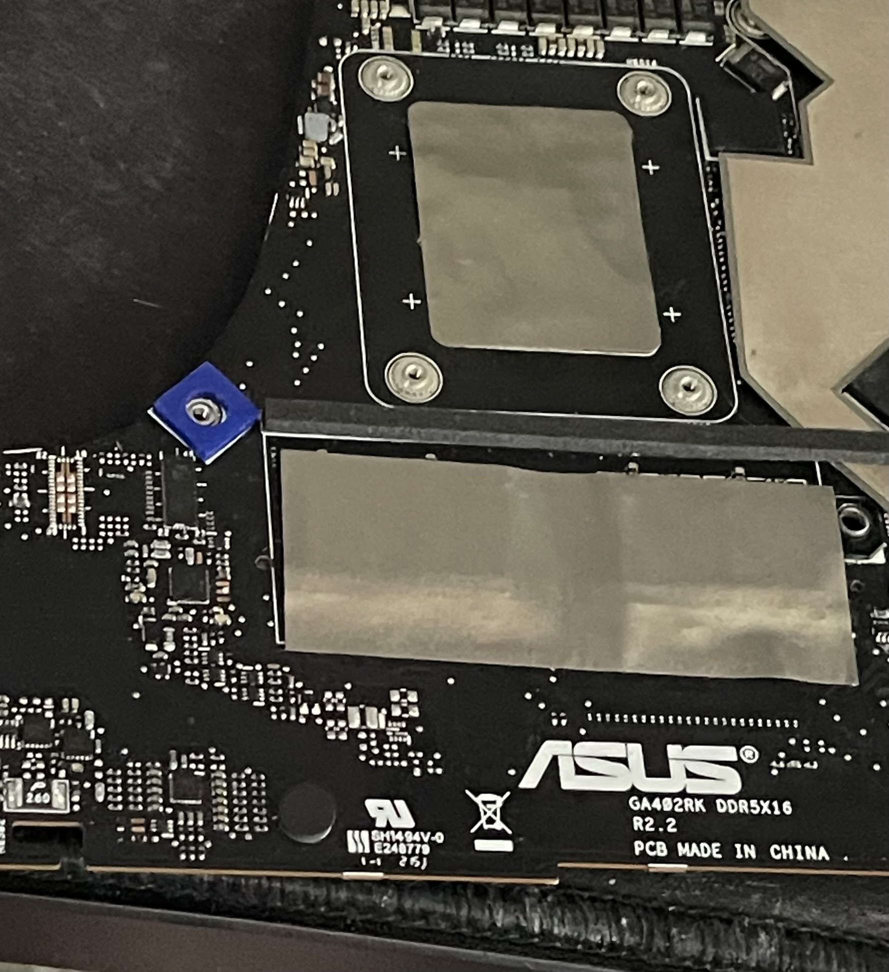

                          hello
                          pleace help, laptop did not post, possible after bios update
                          mb ga402rk ddr5x16 r2.2
                          ga402rj-g14.r96700 on sticker
                          i try flash bios from this topic but no luck
