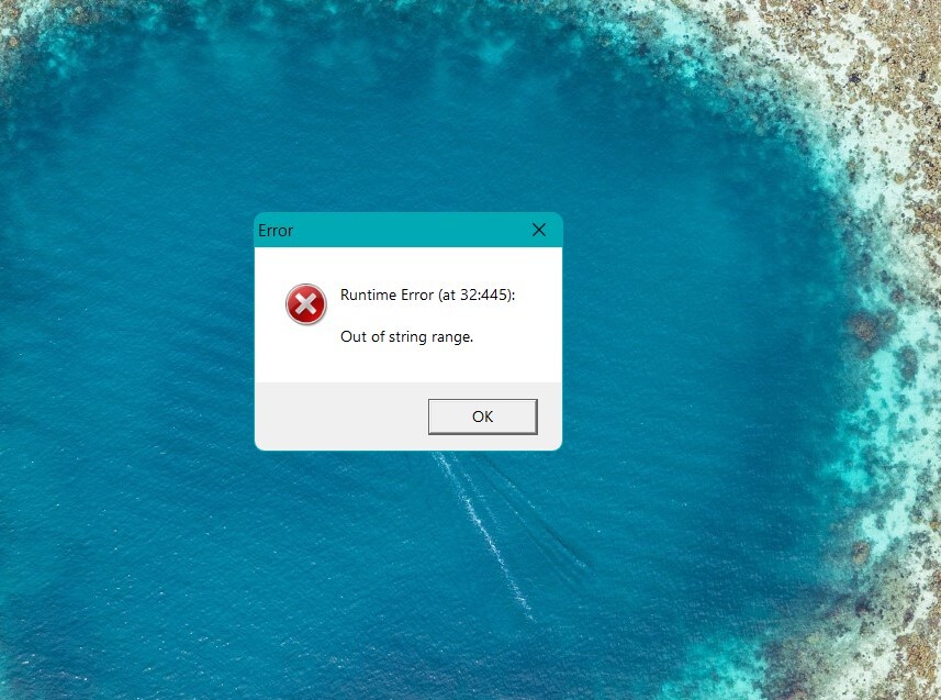

          hi guys can somebody help me is my bios corrupted? i can't update my bios anymore, but my laptop is working and windows working fine. when i try to update my bios there is an error so i attached the screen shot. please help

          why merged? btw i already did a clean install of windows and changed drives, still the same

            If you have an SPI bios programmer make a backup and post it here,along with the laptop serial number. If you don`t have a programmer you could try a bios recovery
            You`re not the only one to have the same problem,its happened to others and with different models
            https://forums.lenovo.com/t5/Lenovo-...ls/m-p/5268365
            https://forums.lenovo.com/t5/Lenovo-...or/m-p/5056951
            https://forums.lenovo.com/t5/Lenovo-...or/m-p/5257101
            https://forums.lenovo.com/t5/Lenovo-...ne/m-p/5195704
            Quote:
            I was able to do a downgrade to version F5CN57WW using the Crisis method described here: https://www.reddit.com/r/Lenovo/comm..._14itl05_bios/
            Here is the F5CN57WW firmware if you need it (https://1drv.ms/u/s!AvPnrDOGjsUMgY0S...b0ZBw?e=YfTxcd), I renamed the BIOS.fd file to F5Crisis.bin and it works like a charm.
            End Quote.
            Attached is the F5Crisis.bin ,extract it from the zip folder and read the instructions at the reddit post

              thanks for the bin. it works, then i updated to the latest firmware and as before i can not access the bios again. because i cannot use the previous bin file i've search for a newer one and recovered again. i think the issue is the sequence, need to install the intel management engine firmware first before updating the bios
