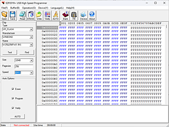

    I had my old motherboard i really want build a HTPC and i want use this mobo but i tried BIOS update in 2024 and the motherboard is cooked it get orange led only tried change cpu ram everything but can't fixit. (I bought the motherabord second hand in 2023.)
    It has a Winbond 25Q256JWEQ (I think this is a 1.8V model so i used the 1.8v adapter aswell.) Bios chip on it i tried reflash with my EZP2019+ programmer but when i manually choose a chip like similar to this i click the read button and only shows 000 and i can erase it when i try write i can't verify it.
    I have a clip and i want use this i can't solder the chip.
    Which chip is similar to this Winbond chip or how can i fix this?
    Can i flash this type of chip with this programmer and how?
    I have a BIOS file from ASUS Website.
    Thanks for the help.

      I tried download the windows version but it says the file was removed. I can't install on linux. I asked the forum you linked me aswell hope i can reprogram this chip i tried 6mhz but the same result.

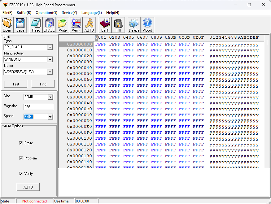

        Add chip support to EZP2019, EZP2019...ro Programmers
        I downloaded the EZP2019+ software from the linked site, I attached them to my post in that thread
        When using a clip, it takes several tries to align it properly, there's a Test button, it should read the Chip ID (EF6019)
        Use the 1.8V adapter, manually select W25Q256FW
          Click image for larger version Name:	ezp2019+.png Views:	0 Size:	54.7 KB ID:	3712639
          Thanks i try again with this. When i click the test button it shows 32 code and cant recognize the chip.

            Make sure to disconnect mobo from PSU, disconnect monitor, take out CPU and CMOS backup battery. All this can disturb reading the chip. If all this does not help only way is to desolder the chip, or ...
            ...use a CH-341 programmer, they are very good for in-circuit programming. In-circuit means often powering 1/3 of the board electronics, so programmer must be capable to deliver significant power on VCC, normal programmers might not be able to deliver so much power. Also CH-341 costs really peanuts, so no cost issue.
            Recently I found an information, that bios vendors offer custom bios chips with undocumented protection functions, so it is not possible to erease or change bios contents without a custom SPI control sequence. I have described such a case I had recently here, I believe the reason I can't erease/modify the bios in my case is just such a custom made SPI chip. And this is also an 1.8V chip.
