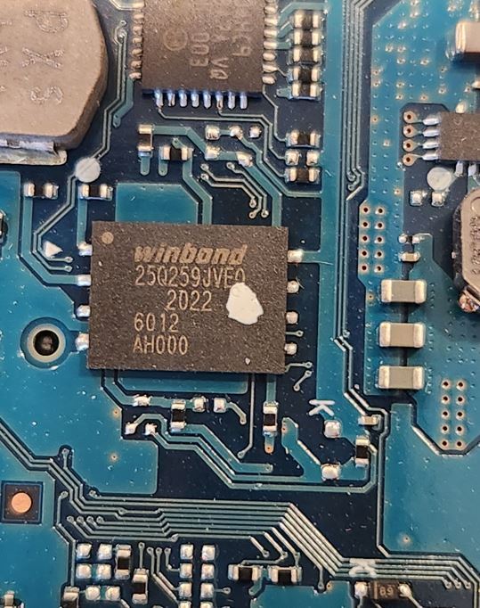

    I can't seem to find much about working on these units yet or information about working on the BIOS. Thought I would start a thread about the FZ-55 Toughbook. I'm in the process of dissecting one currently.
    The Main PCB is model FM182mk1
    I was able to read both the front and back MXIC MX25V8035F chips however I don't have a program in my toolkit that could read the main BIOS chip Winbond 25Q259JVEQ.
    Once I get a good read I'll post all 3 BIOS files here for folks to review.
    Does any one have any recommendations?

      I'm using a CH341 and it works pretty good, repaired a lot of computers with it over the years. Just don't have a program that picks up the Winbond 25Q259JVEQ

        None will pick up the 25Q259JVEQ ,but NeoProgrammer software for the CH341A will program the 25Q256JV
          SMDFlea! Just the man I was hoping for!
          I tried using NeoProgrammer 2.2.0.10 and it wouldn't detect the chip properly. I know it'll read the 25Q256 and that is in the software chip list, but nothing has this newer 25Q259. Wondering per the red highlighted "6" and your winky emoji did you think I typod the chips model number or are you suggesting if I manually set NeoProgrammer to 25Q256 I'll still get a good read from the chip even though 259 is printed on it?
            • 21914
            I`m sure there is no 25Q259 .Choose the chip manually in the support list and see what happens

              Yeah I couldn't find ANYTHING about the chip either. I'll give your idea a try. Click image for larger version

                Found a compliance report at winbond,but no product spec https://www.winbond.com/hq/search/ne...59&__locale=en

                  I got NeoProgrammer to auto detect the Winbond as the 25Q256JV, read and verified twice. Let me know if you guys think it looks like a good read.
                  The MX chips had very little info on them (~1mb). I read and verified them 4 times with 3 different programs to be sure I wasn't getting bad reads.
                  Here's where I need help.
                  1: The BIOS had a password, can anyone read the password
                  2: If not can anyone clear the password on these chips?
                  From what I understand (which isn't much lol) it exists in all 3 locations
                  Thanks to everyone as always!
