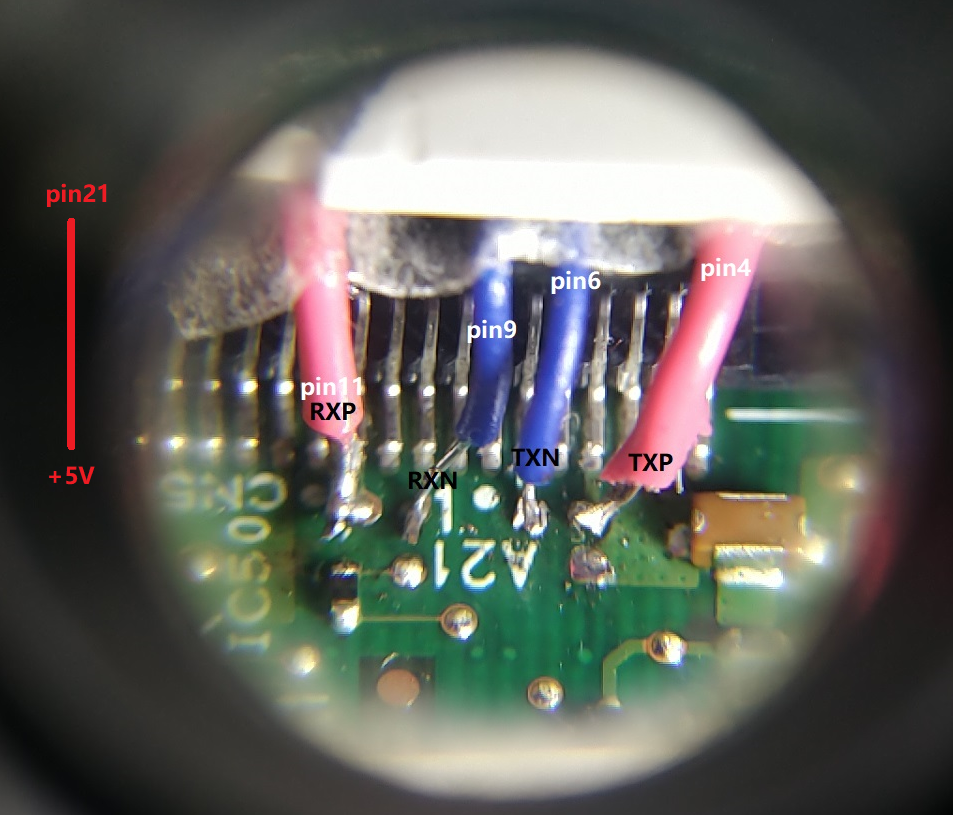

    Panasonic toughbook CF-19 help connect the HDD directly. Need a SATA pinout.
    Hello, dear community. NEED A DIAGRAM of the HDD/SSD connector contacts as an example (a screenshot from the diagram of another laptop on which I have already done this and a photo of the patient's board) Maybe someone can make a screenshot of the diagram with the pinout? Or does someone have a diagram of the motherboard schematic?
    I am asking, because not find the information myself anywhere. I have a PANASONIC CF19 MK2 laptop (Any revision will do, I do not think that the contacts in the connector are located differently) but finding a basket for it at reasonable prices is a problem. I have experience in how to do this (I solder a 5-wire SATA data cable and a +- power wire to the connector) and I need a diagram of the contacts of this connector, in my opinion it is non-standard or how to find it?. I would be very grateful.

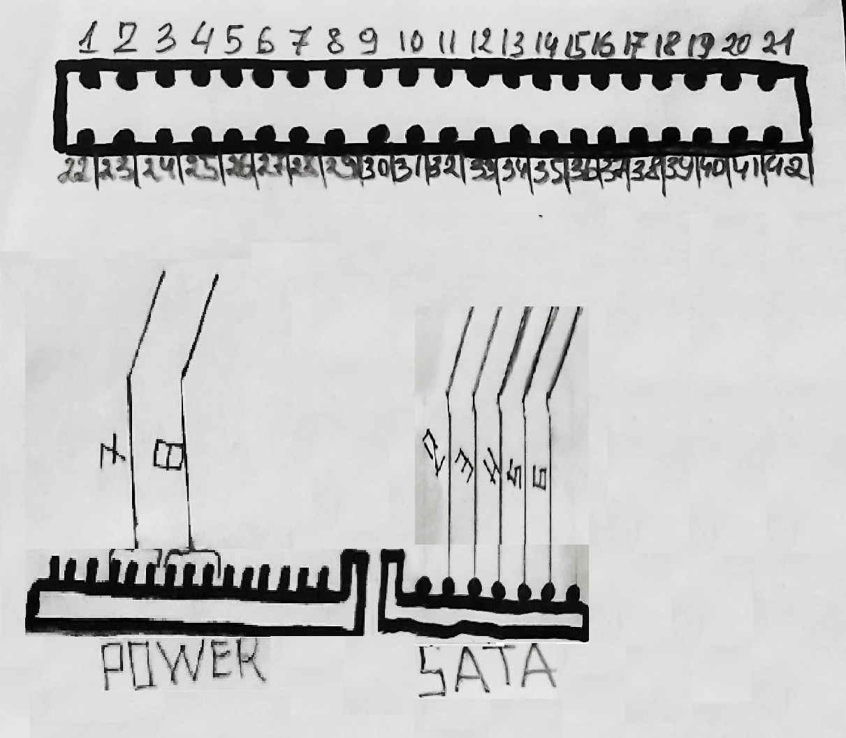

      Who has a Panasonic CF-19, can you help? To directly connect the HDD to the connector in the laptop, you need to pin out the contacts on the CASE\CART for the hard drive, only 7 contacts are of interest. If you have a tester and a desire to help, I will be sincerely grateful, just call them (I attach a picture with numbered contacts, write which number is connected to which) Which contact on the connector is connected to which on the connector that is inserted into the laptop connector.

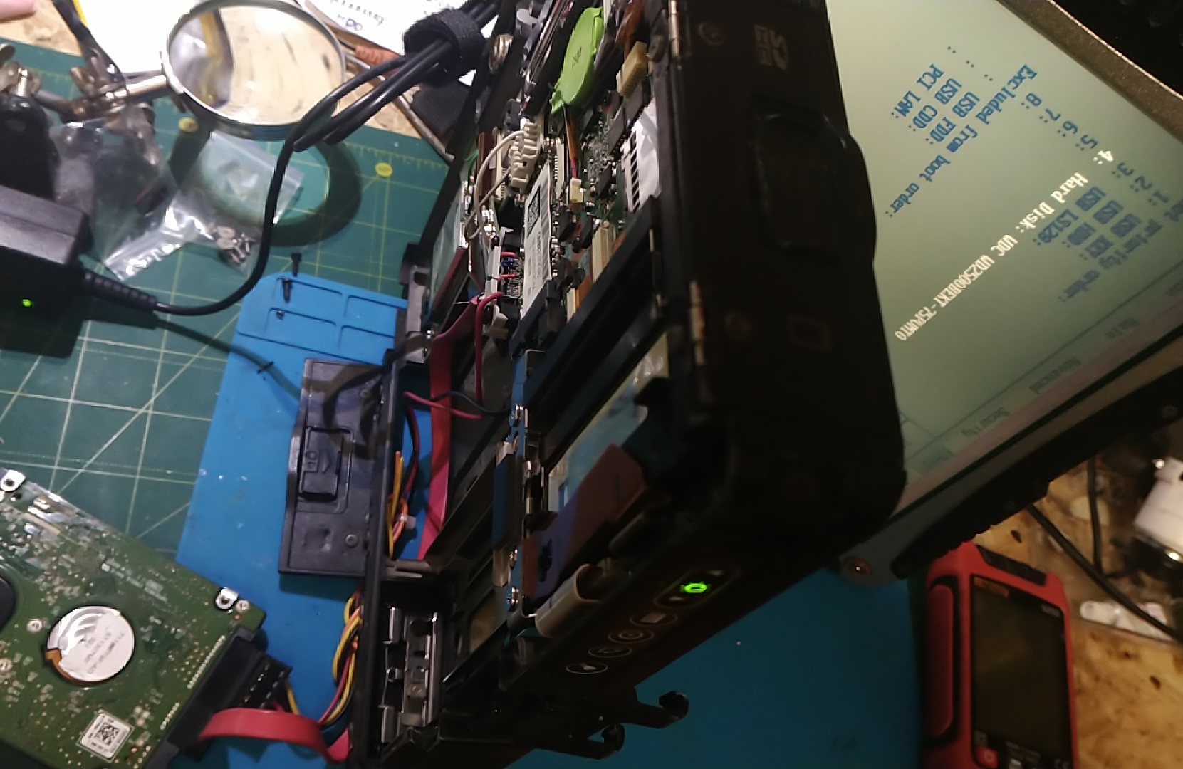

      I will report the result with a photo report.

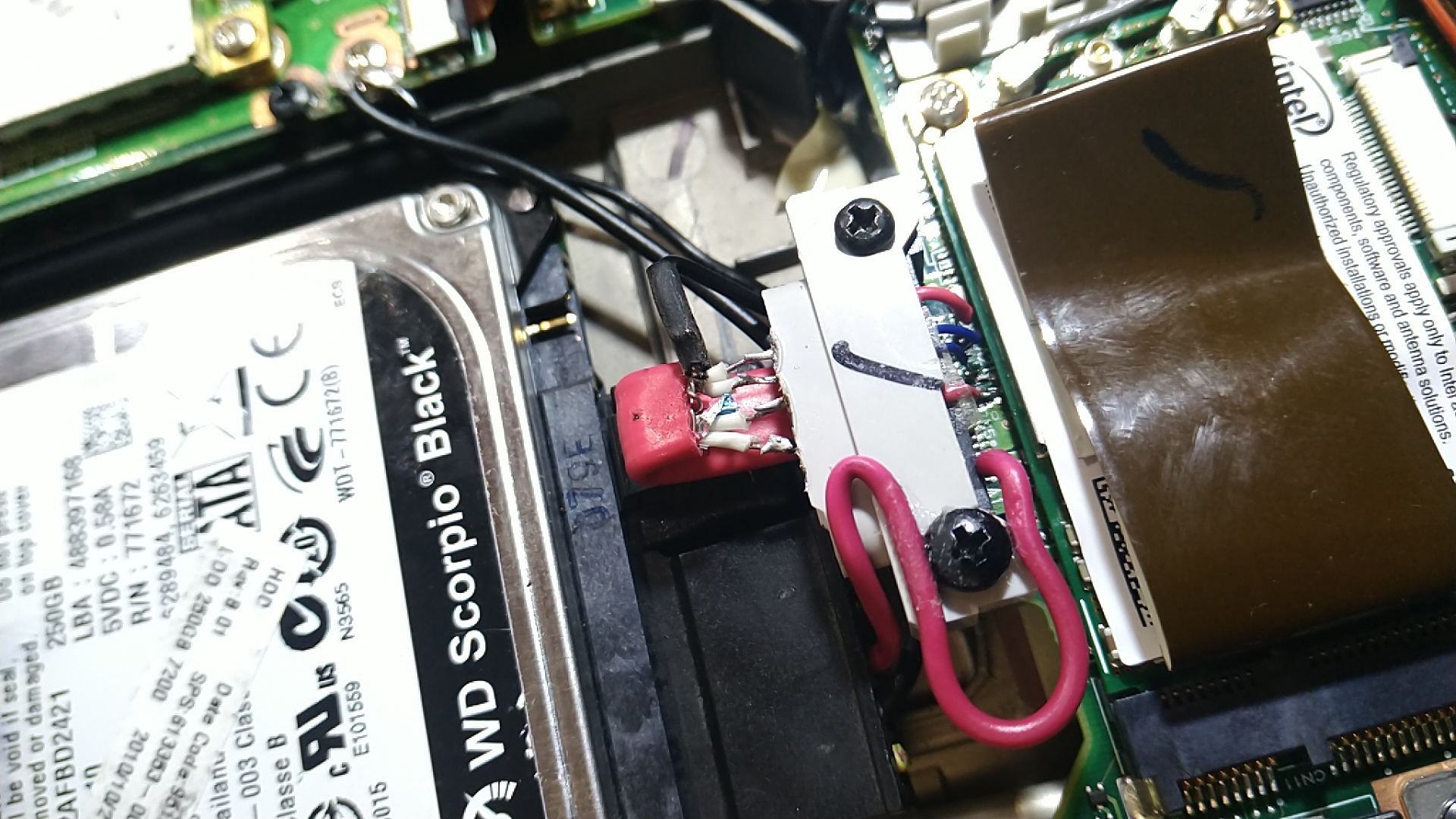

        Here is my solution. Maybe someone will need it. (pinout of the Panasonic CF-19 sata, soldering the sata cable directly to the motherboard) all the information is in the photo. In short: pin4-TXP pin6-TXN pin9-RXN pin11-RXP pin21+5V. negative wires from the sata cable and from the hard drive power supply to ground, all together at one point, take it wherever is convenient.
