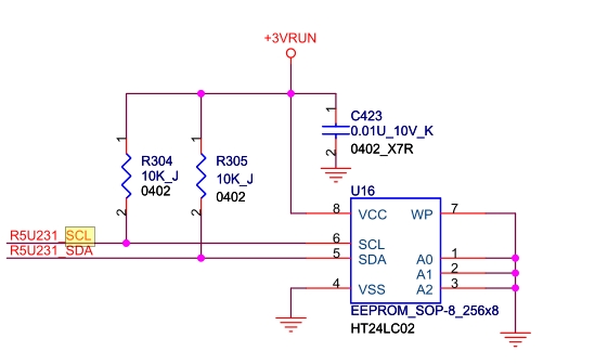

        Could be that none of them store the password, many motherboards has an I2C memory chip that stores serial number, password, etc.
        In this case the schematic is the only help.
        Regards.

          i fix 30-40 laptops in a week. And i didnt see anything like that. Clould you please show me an example ?
            Re: DELL XPS L502X Core I7 Master Bios Password
            Hi spidey, the following screen capture, is from a mbx-223 motherboard, and as you can see it has a memory with the I2C bus. I don´t know if password in this model are stored in this chip, but some other models from Sony, I´m sure it is.
            Also some models from Acer, like de aao have a memory with the I2C bus, and they stores serial number, uuid, etc.
            Regards.
