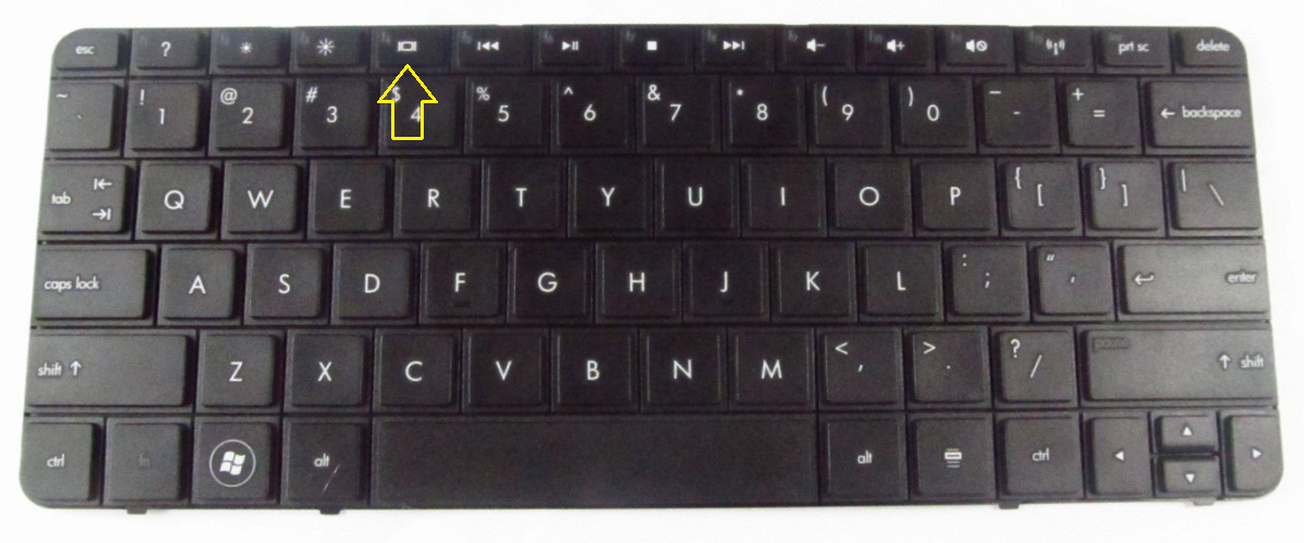

                As for not being able to see anything on the screen during boot:
                That's unfortunately the norm for a lot of laptops and netbooks. They only show stuff on the internal LCD till windows has booted up and loaded the driver.
                Sometimes, you have the ability to switch outputs via hotkeys (Fn+something .. usually a monitor symbol) to get it to output something via the VGA port.
                I'd try turning it on and hammering F2, Del or F10 to try and get into the BIOS (without yet seeing anything). If it doesn't boot windows (HDD LED), you should be good to go, as it's probably displaying the BIOS or the screen to select the boot device.
                Then try those Fn+something key combos to switch to VGA output to be able to see what the heck is going on.
                edit: found a photo of the keyboard. Looks like the key that would normally be labelled "F4" is what you're looking for to switch outputs

                  Originally posted by Scenic
                  Installing Win7 from a USB stick is really easy. Not quite sure why people keep recommending WinToFlash when MS offers their own tool for it. All you need is a Win7 .iso and a USB stick of at least 4GB.
                  Tool:
                  http://images2.store.microsoft.com/p...B-DVD-tool.exe
                  Website for it:
                  http://www.microsoftstore.com/store/...usbdvd_dwnTool
