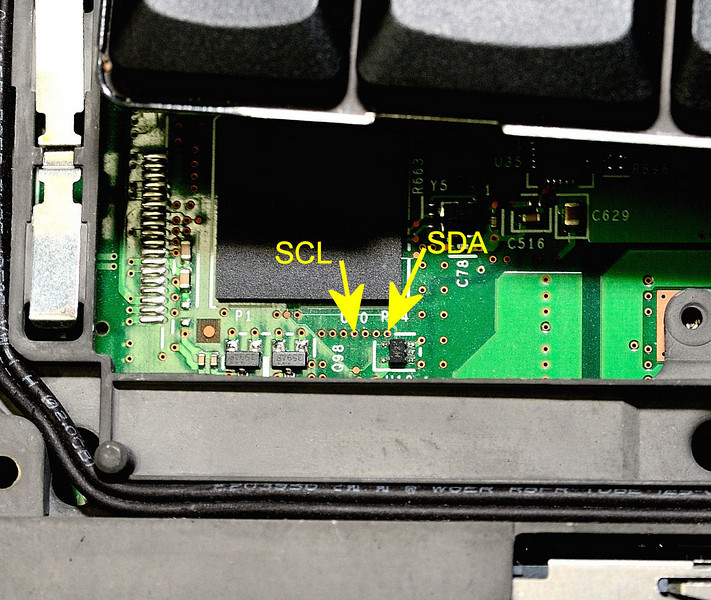

    Hi. I buy 4 this laptops on auktion (as is) and all 4 got locked bios, not possible to do nothing with this, because all stop after show thinkpad logo and no thing happend if I push any button on keyboard, no boot from any device, usb, hdd, cd/dvd
    Is any solution to fix this ?

    Hard drive has a password. Remove it and see if that makes it continue.
    http://www.thinkwiki.org/wiki/Mainte...BIOS_passwords.

      Hi. On start I had the same idea, but even if I start laptop without HDD still requires a password.

              removing of atmel ic also works it acts as A Security chip
                Re: Lenovo Thinkpad T60 locked bios
                PLEASE can someone show me the security chip or the atmel chip on this laptop?

                  http://www.ja.axxs.net/t60_t60p.htm
                  https://www.youtube.com/watch?v=cQzygBhz830
                    Please i am not seeing the Atmel 24RF08 chip on the board.is that chip replace by another one?if yes then what is its name.

                      not i think is atmel chip look near ram slot inside side black cover.
                        short both pins after you press power and press F1 immediately after

                          Bluestone,when i short the pins the T60 doesnt show any display and when i remove the short the display comes.any idea

                            please Dycc,can i use the simple-i2cprog(SIPROG) interface to read the EEPROM of T60?
                              NO.
                              if you try to read a 24RF series the security mode will erase the content.

                                  you have to put it on first make sure u see the ibm logo before shorting the pins and then you press f1 immidiately
