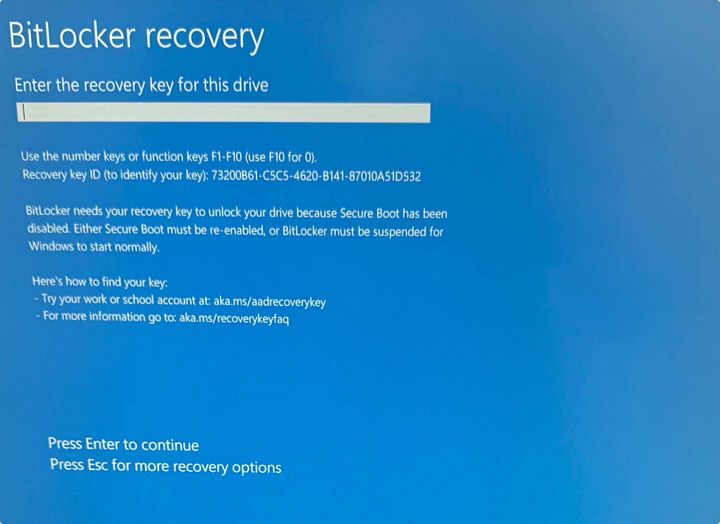

                        Questions I have outside of generously asking for a fixed version of this BIOS are:
                        - Do I need to remove BitLocker first (how to do PROPERLY?)?
                        - Do I need to worry about an "EC"?
                        - How do I flash whatever files I get back?

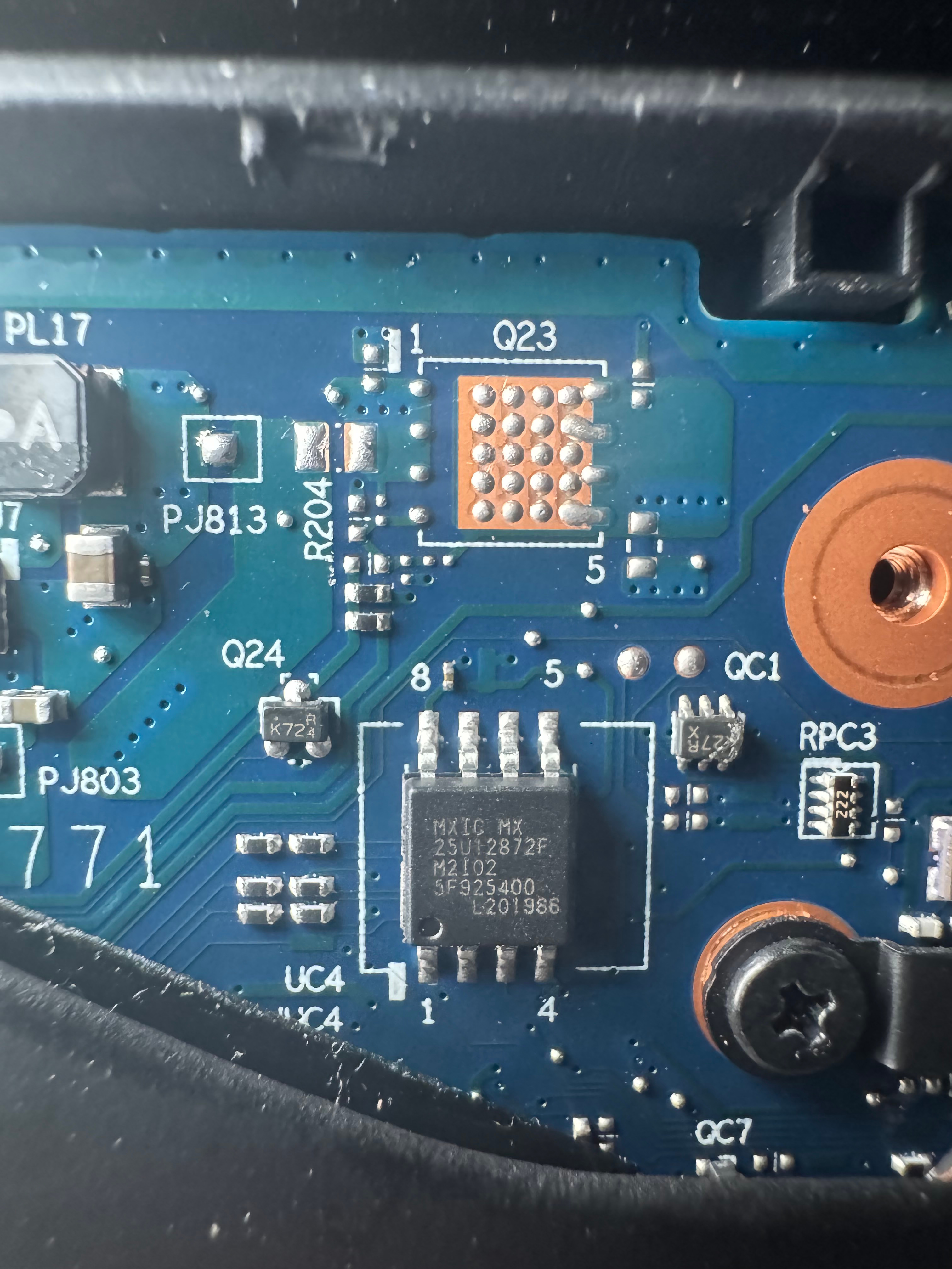

                        I made this dump using the following in Ubuntu Linux: `sudo flashrom -p ch341a_spi -r backup1.bin`
                        Model: E14 Gen 2
                        Type: 20T6-002QS
                        Board: NM-C771
                        Serial: PF-2PF0NR
                        Here is a picture of the chip and the machine has BitLocker activated. I remember reading somewhere that you should "somehow" remove BitLocker first because of the TPM on the board. I have not read anywhere yet how to do that or what my next steps are should I get back a supposedly working BIOS...
                        Picture #1: BitLocker screen
                        Click image for larger version  Name:	IMG_1357.jpg Views:	0 Size:	670.7 KB ID:	3668651
                        Picture #2: BIOS
                        Click image for larger version  Name:	IMG_1360.jpg Views:	0 Size:	1.49 MB ID:	3668652
                          Reinstall Windows with usb key , format disk and new install
