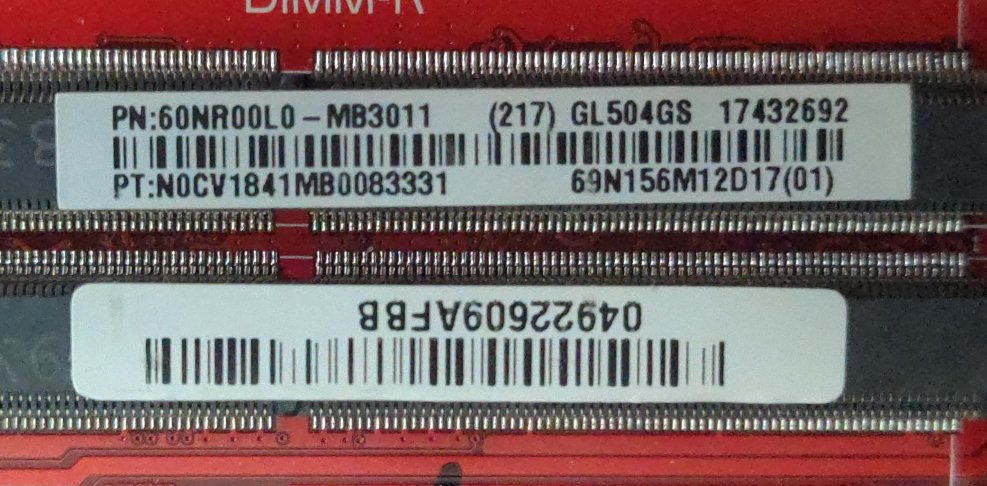

    Hi, I have an Asus GL504GS where, using a modded BIOS, settings were saved that rendered it unbootable (no display output on internal or external etc) - pulling the CMOS battery and all other power (battery, AC), leaving for a day, did not reset them. The BIOS recovery procedure does not work. The chip is WSON8, I can remove and reflash it, but I believe I need a full dump.
    Knowing which areas to clear out to cause a variable reset/reinitialization to defaults would also help, then I wouldn't need to reflash & could just erase that portion on the chip.
    Any help on either end would be greatly appreciated!

    Dump the bios with the programmer and upload the file here, add clear picture of the sticker at the ram slot and the device serial number.

      Re: Asus GL504GS BIOS BIN
      Thank you, I have attached both. I believe the S/N is JANRCV01K981428.

          Engineering dump should solve the problem if it's bios related:
            Can I straight flash the engineering dump without losing device-specific info? Would there be a possible issue with EC firmware mismatch? Asking as WSON8 is a pain to work with and I don't want to physically break anything! This is my own laptop, I have a cheap hot air station & a CH341 programmer I did a 3.3V mod on. The chip itself is precariously held in the SOIC8 clip the programmer came with, which astoundingly worked, but I don't know if I can get a good connection a second time.
            I also looked at the bin provided by Cosmouaz, seems the first ~4.5MB of the bin are identical to the engineering dump. The middle portion doesn't match anything I compared it to.
            I wonder if there is an area of the chip that's designated as NVRAM & whether that alone can be nulled out? Essentially forcing the BIOS to use default values for everything.
            • turbo9000
              • Mar 2016
              • 12
              I got curious and flashed the engineering dump. Haven't done an analysis of the effects so far, but the laptop now boots without issues. I've been lurking on this forum for years (since the cap plague back in the mid 2000s - stacks and stacks of blown P4P800-VM & P5LD2-VM boards), it's time for a donation, which I have now made. Thank you very much for the assistance! Please feel free to delete the photo, serial number, and two dumps I uploaded as I don't think they'll be of much use to others - I would do it myself but I don't think I can edit my old posts!

                  Check the barcode sticker on the ram slot,the same as post #3 If your model number says GL504GS you can use the Asus F1 engineering bios at post #5 .
                  If you want to add your DMI from your backup to the new bios use a hex editor with these offsets 460000 - 46FFFF ,or use the attched script,see the README.txt file for the instructions.
