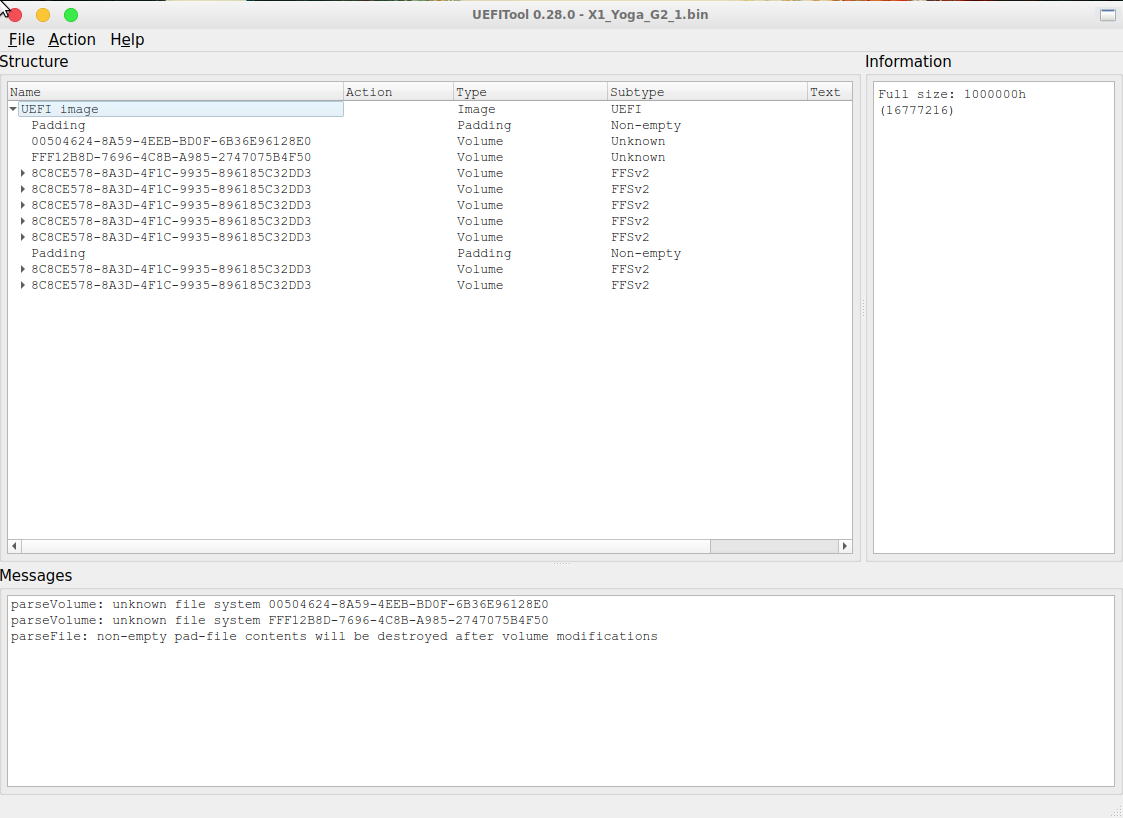

          • Markus1741
            • Sep 2020
            • 873
            • N/A
            Re: X1 Yoga 2nd Generation with a BIOS password
            Originally posted by deggial
            Hello hardware1,
            thank you for directing me to that post. It is luckily the same serial number and CPU! I downloaded that BIOS but now I'm having problems flashing it.
            I found out that the chip on that notebook was not fully supported by flashrom software. I wonder how it worked at the first place. I think I need a different programmer, or I need to replace the chip. I'll write here, if I make any progress.

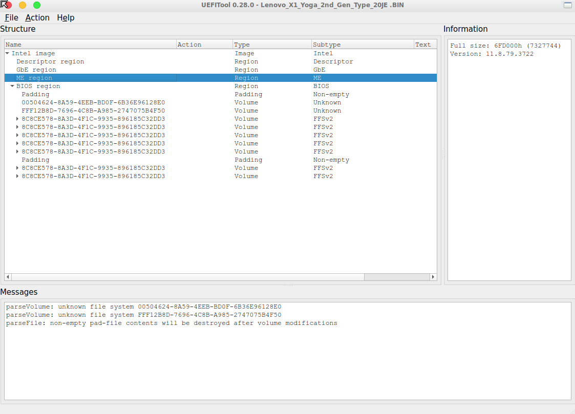

            I apologize if I interfere here but if this is the only backup of your chip you have a huge problem your dump does not contain any Me region and also further parts are missing.
            It won't work with your dump.

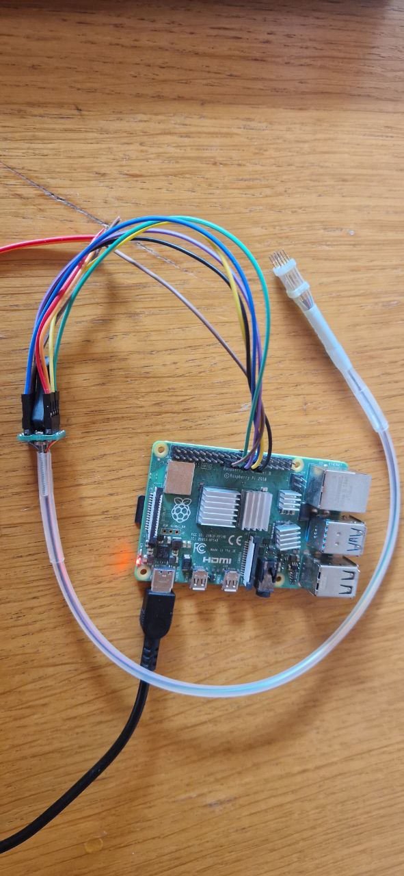

              thank you for your response and providing an additional dump. I am using Raspberry Pi and flashrom, I attached a picture of my setup. I'm connecting to the Raspberry Pi via SSH and run the flashrom command on the Pi itself. I also have a CH431A (black) but I used it only once, it was slow compared to the Pi and I read that it has some flaws about voltage (3V/5V).
              At the moment I cannot read or write to the chip anymore, I think I need to replace it now. The chip model is MX25L12873F, and "flashrom --list-supported" command didn't list that model in my version. I see that the new version of flashrom v1.3 has added the support, but I assume my flashrom is older, I may need to update it. That would explain why the original dump was incomplete.
              I think at this point, I have no other choice than to unsolder the chip and replace it with a new one, since it seems completely gone now.
