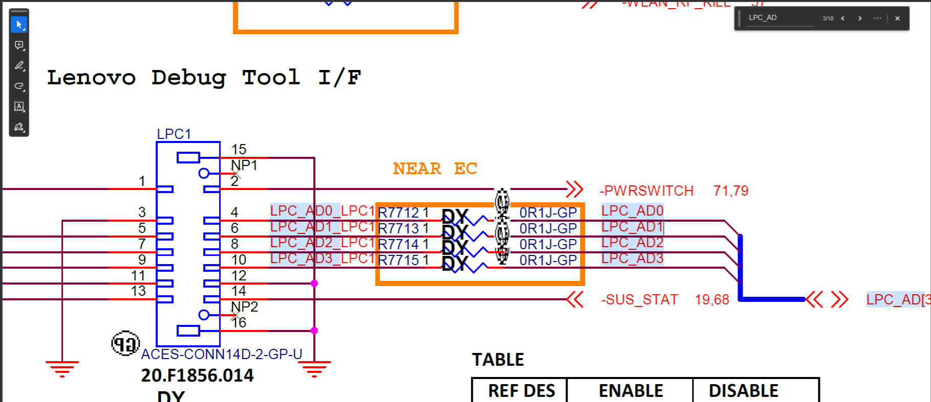

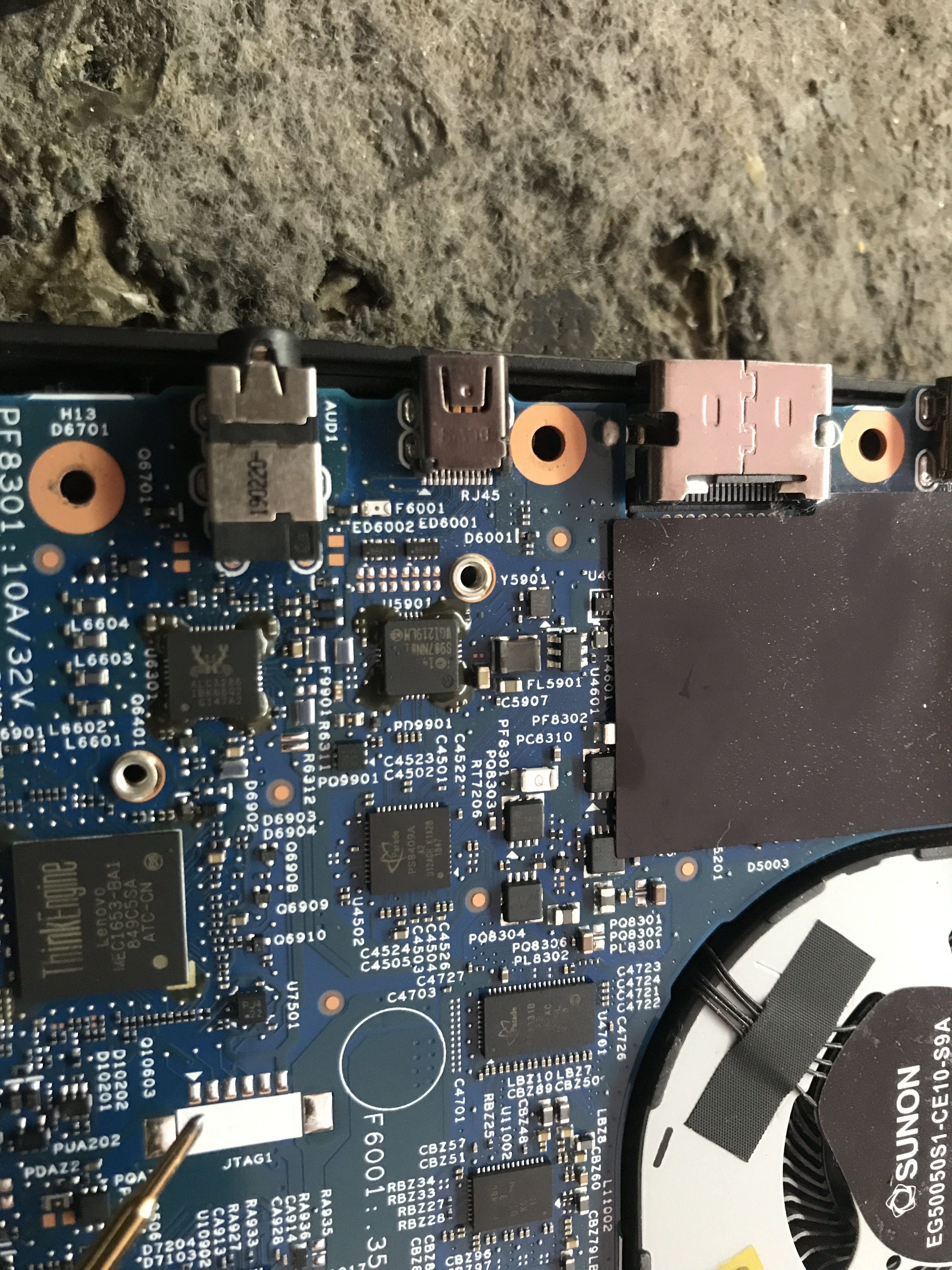

lenovo P1 gen1 17870-1 need 32mb bios dump
read here ,not jtag port ,find lpc port
just need gnd and lad contact
https://www.badcaps.net/forum/troubl...-ec-pwd-bypass
example 1653 bypass
