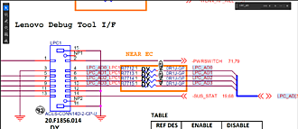

                                      which EC? 1653 always
                                      try bypass with lpc
