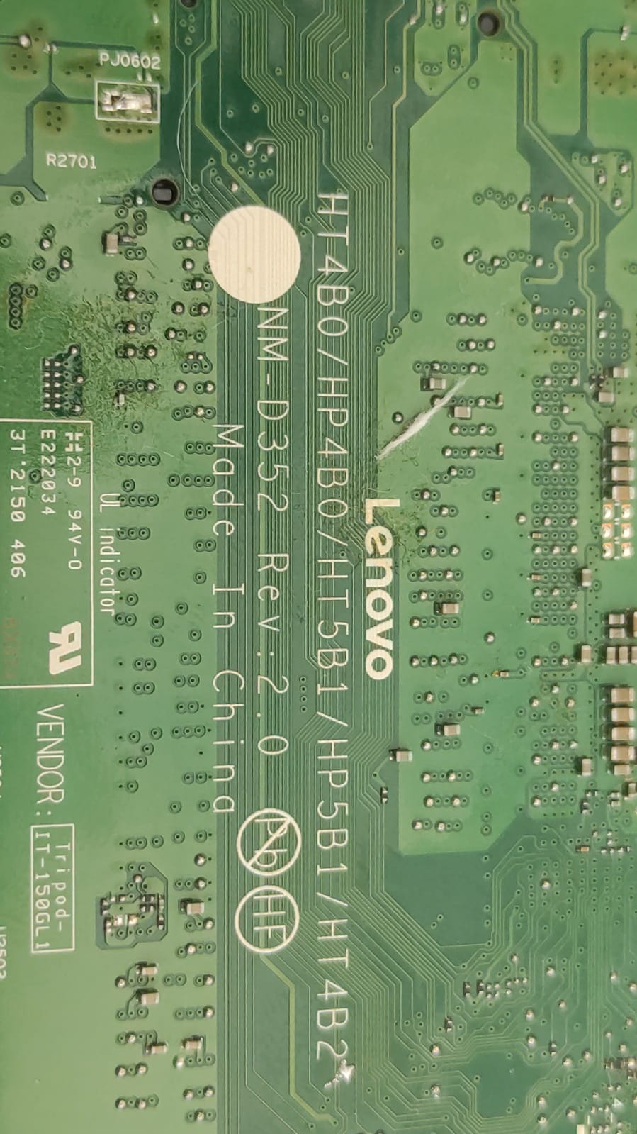

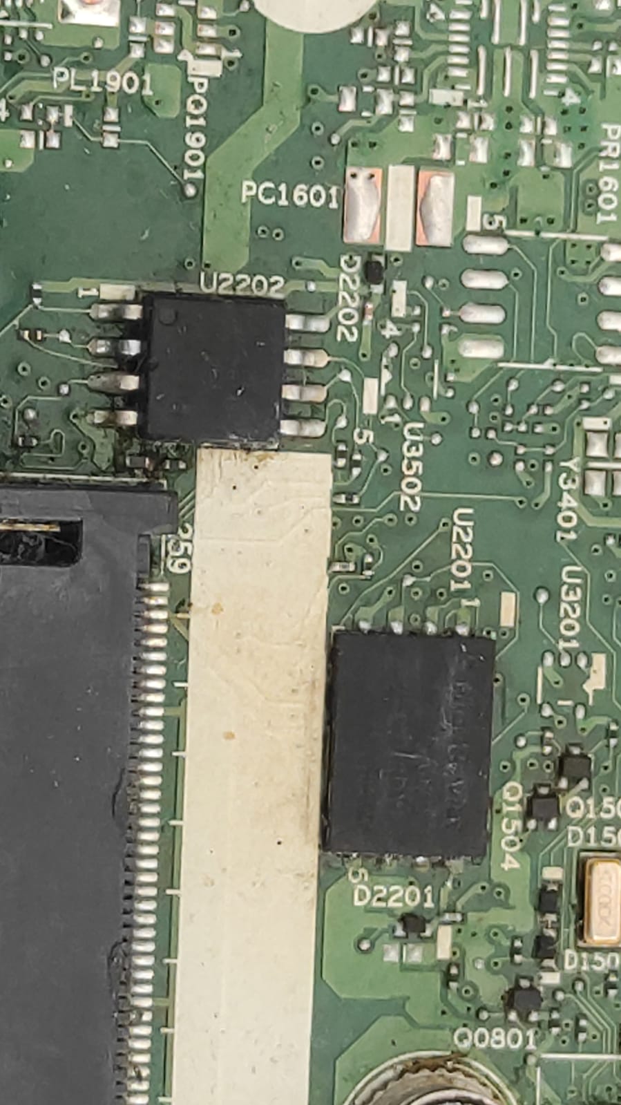

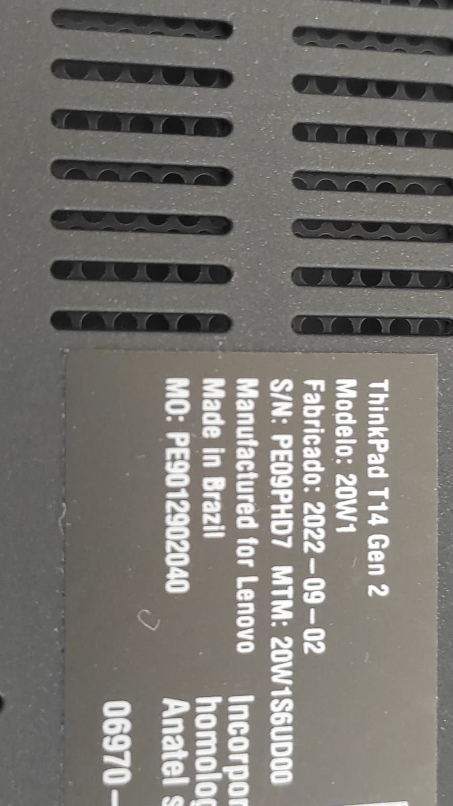

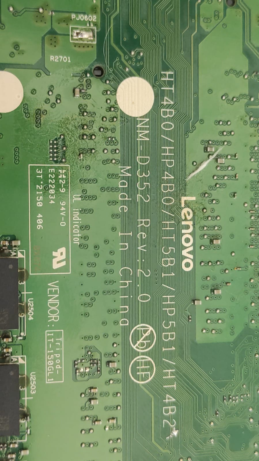

    Good afternoon, I have a lenovo thinkpad t14 gen 2 board model HT4B0/HP4B0/HT5B1/HP5B1/HT4B2
    NM-D352 REV: 2.0
    that has a company logo when I turn it on, I would like to remove it and have it turn on again with the lenovo logo appearing.
    HERE ARE THE BACKUPS OF THE ORIGINAL FILES, IF ANYONE CAN HELP THANK YOU VERY MUCH.

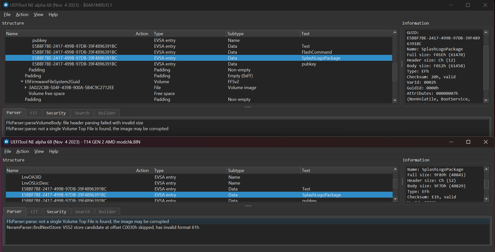

    Have you tried it using the bios update
    How do I remove custom logo from T590? https://www.badcaps.net/forum/showthread.php?t=117918
      not yet, but I'll try and answer you here.

        I tried here and it didn't work

          Re: bios lenovo thinkpad T14 Gen2 logo
          it should work, download bios update for your model and CHECK EXTRACT ONLY, NOT UPDATE BIOS! Go to folder where was extracted, usually C:/DRIVERS/FLASH/name-of-bios-version and launch WINUPTP.EXE. It will pop-up a windows saying you have a custom logo and if you want to remove it or not, read what is written.

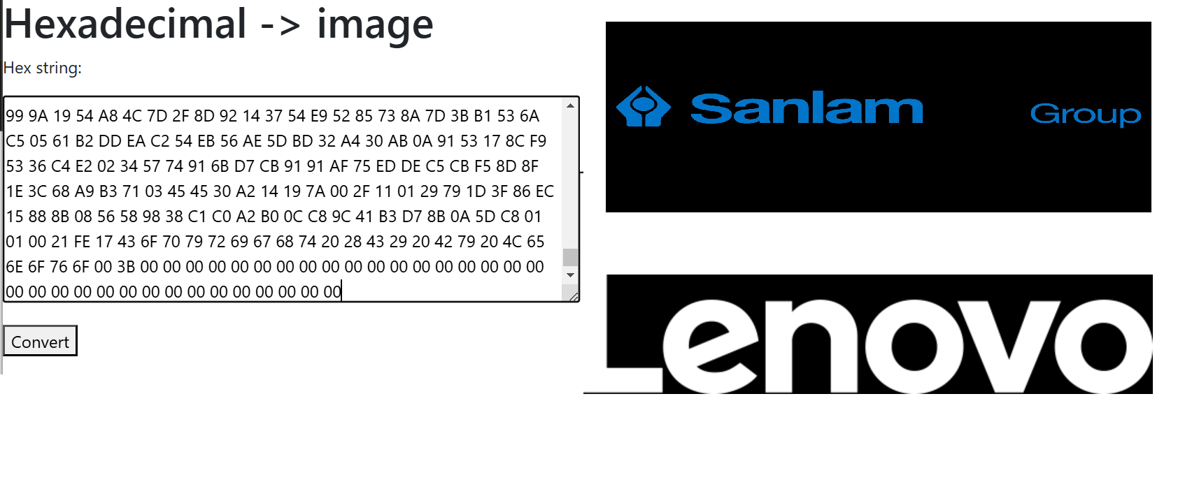

                won't work, don't bother testing. is that your logo??
Name:	Sans titre.jpg
                • Maxpower3
                  Bad Veteran
                  • Feb 2018
                  • 1153
                  • France
                  I tried this
                  Click image for larger version  Name:	image.png Views:	0 Size:	157.8 KB ID:	3575525
                  if not successful with volinakis and SMDFlea solution.
                  I replaced your logo with the original one.
                  Click image for larger version  Name:	replace.png Views:	0 Size:	170.8 KB ID:	3575524
                  to test
                  no certainty that it works
                  @volinakis
                  should it be done with CMD?
                  I saw in another post of yours!
                  https://www.badcaps.net/forum/troubl...om-logo-lenovo

                    yep, I ran it under cmd as Admin. There is also a "BIOS_LOGO.TXT" in bios update package telling how to replace or remove logo.
                    • Maxpower3
                      Bad Veteran
                      • Feb 2018
                      • 1153
                      • France
                      yep,thanks
                      I saw it too
                      I stopped looking for gif which had been replaced by a jpeg with that
