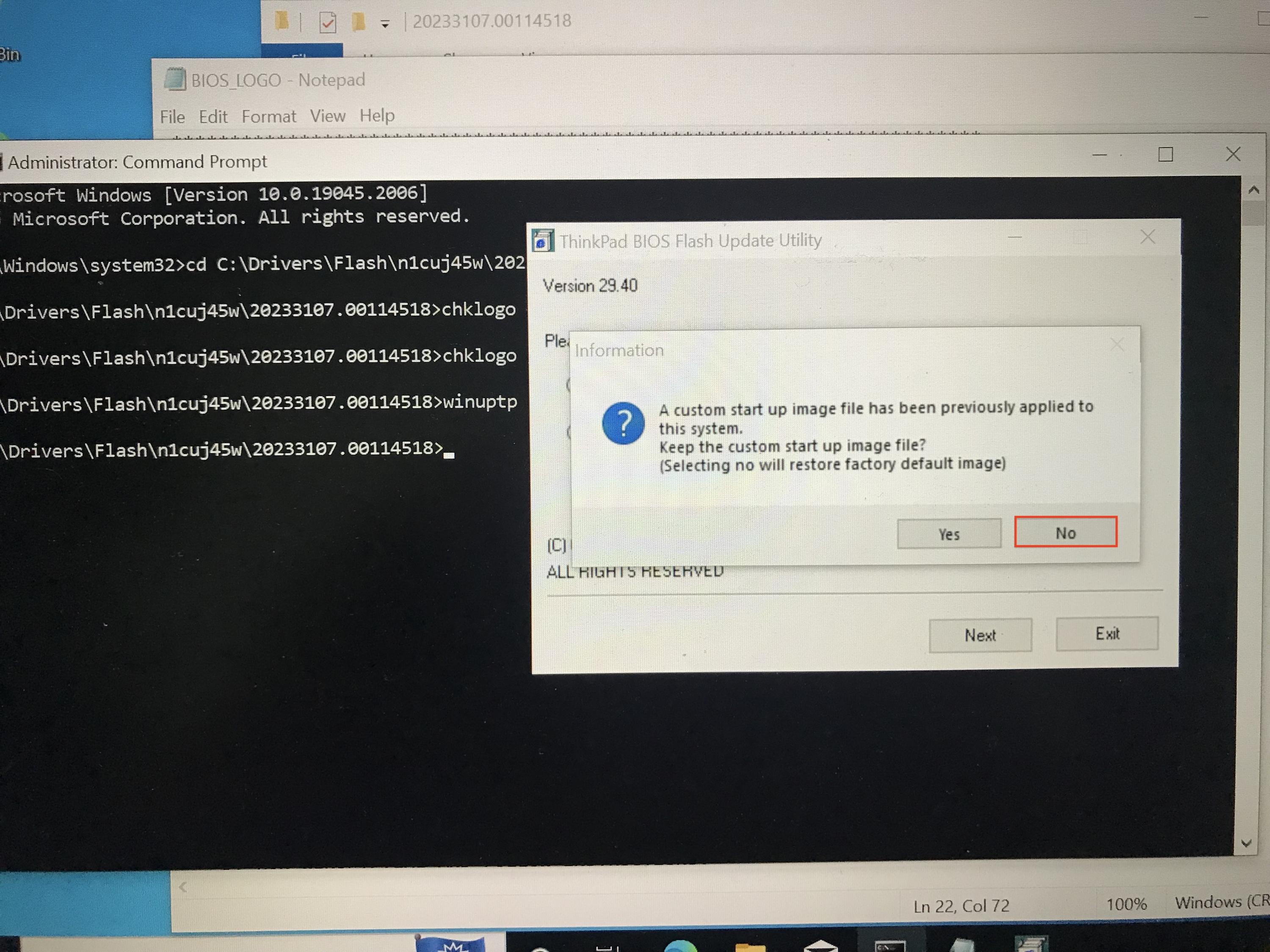

Removing custom logo Lenovo
  • volinakis
    • Jan 2021
    • 2877
    • N/A
    1. Download latest bios update for your laptop model. (xxxxxxxx.exe)
    2. Double click on .exe and choose "Install" and NOT "Update". It will unpack .exe in C: \Drivers\Flash\xxxxxxxx
    3. Go to folder and launch winuptp.exe with cmd.
    4. A window will appear announcing that there is a custom logo installed and if you want to keep it or not. Click "No". It will restore factory default image.
