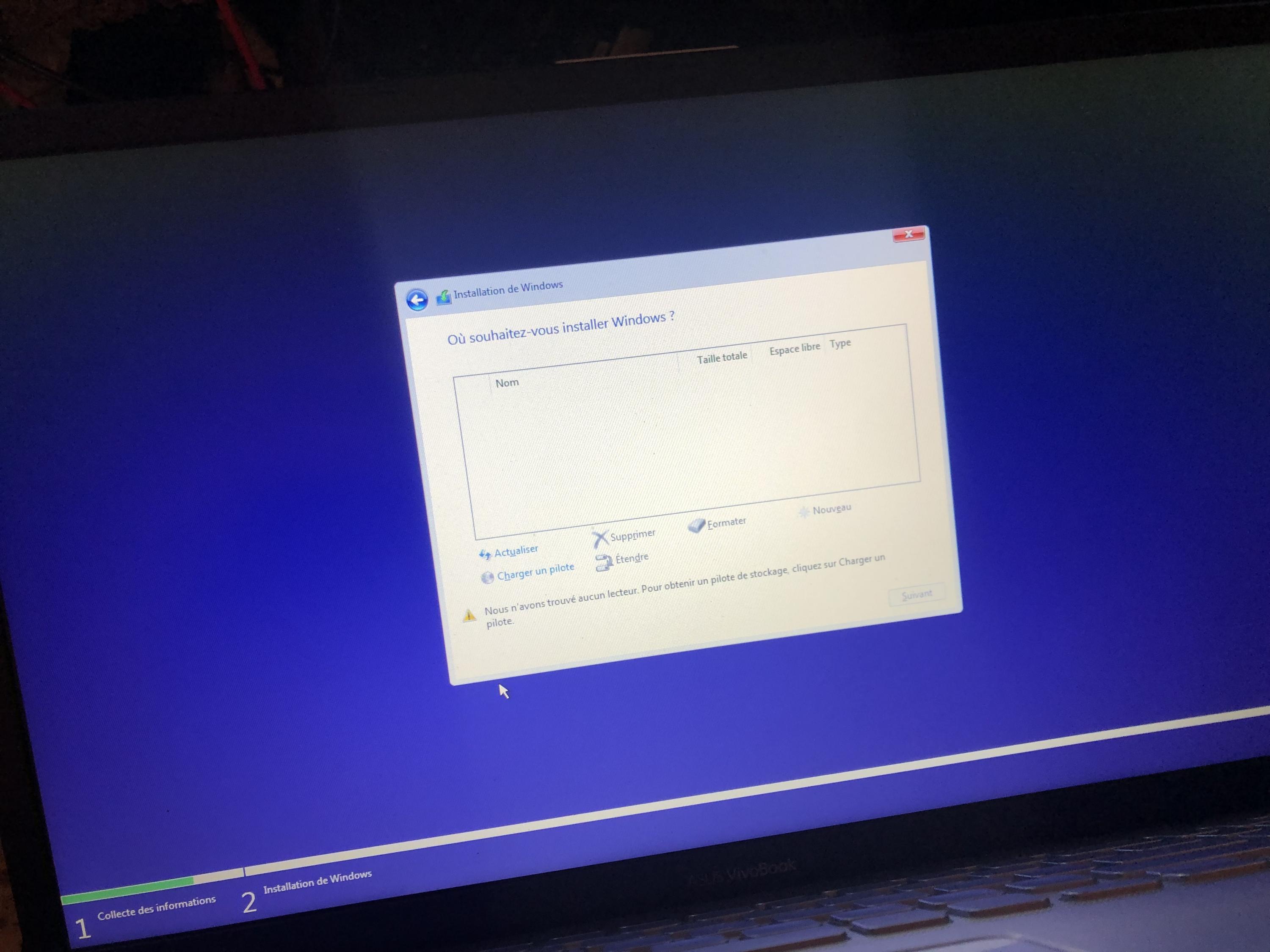

    Hi, I have an asus x712e, motherboard x712ea, the ssd not recognized when I want to format it, I tried several ssd, in the bios it is well recognized, but when I boot with w11 or w10 install key, I do not see the ssd appear to format it.
    I think maybe a problem with the bios,, Can you update my bios with the 307 file please ?

      I reprogrammed with the new bios, but the result is the same, no ssd detected under windows 11 (see photo).
      I would like to know that you have changed what on the original bios, the intel drain? Thanks

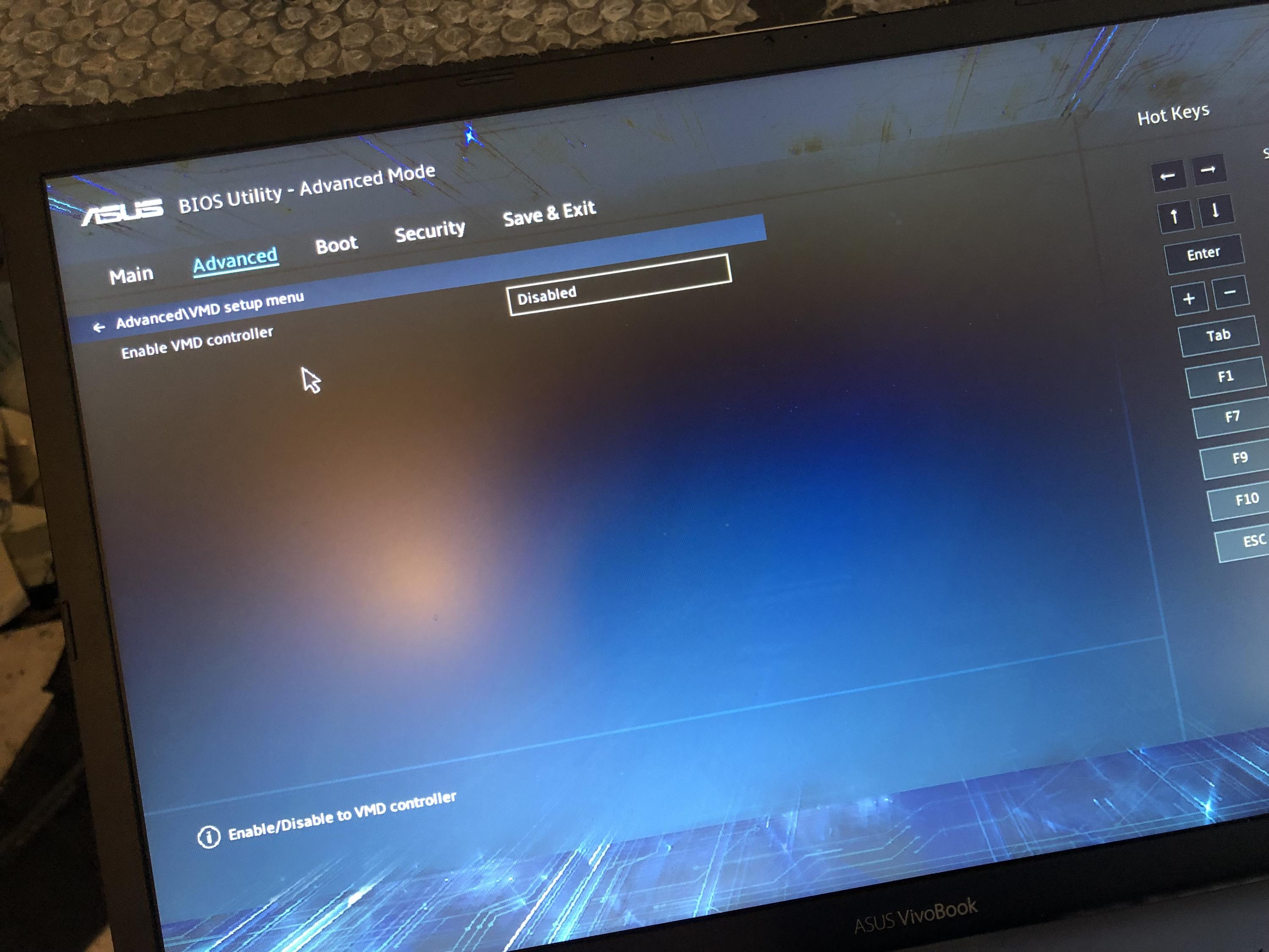

        I think it's a driver issue, I got same error before when I try to reinstall Win 10 on a New device. I can't explain the whole thing to you, but I was install a driver called "Intel RST VMD" on the USB drive and follow some steps.
        Also I worked before on an ASUS with intel 11th gen CPU, in the BIOS Menu I found an option for Intel VMD, disabled it. After that the drive has been shown.

          you are very strong, I disabled the VMD controller option, now it recognizes ssds and I was able to format, thank you very much
