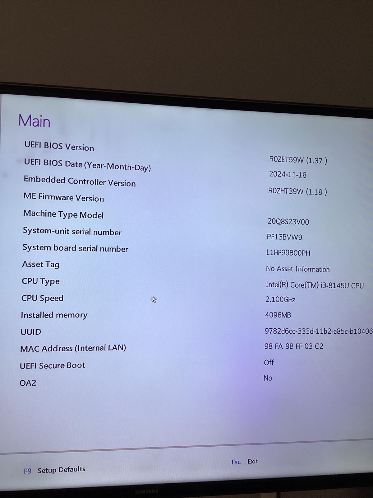

      so good news, enjoy!
      Hello, i just noticed the "OA3 ID" and "Preinstalled OS License" vanished after the bios flash, when installing a fresh copy of windows 11 it asks for a license key (before it didn't). Also the OA2 is now at "No" instead of "Yes". Is there a way to bring it back? I have a photo of the numbers that were under "Preinstalled OS License" and "OA3 ID".
        • 21586
        #43
        Copy it from another bios to yours using a hex editor. 45 56 53 41

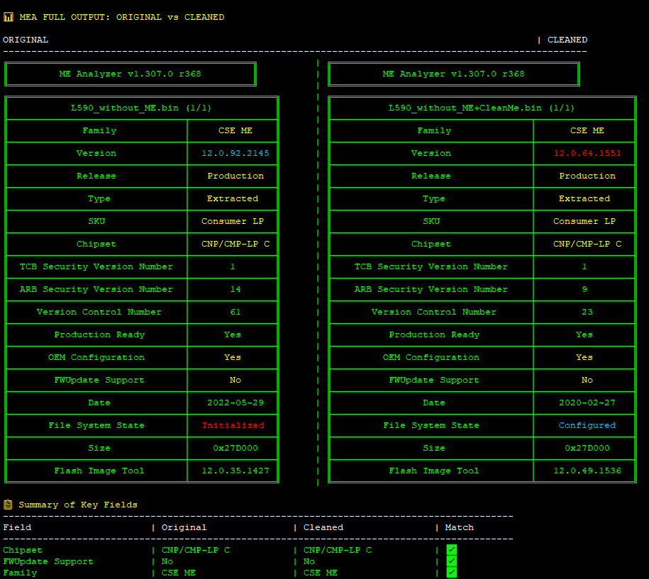

                              Hello, can anyone please repair my bios
                              ME firmware dissapeared
                              here is actual bios without ME

                                #55
Name:	WhatsApp Image 2025-09-27 at 21.30.32.jpg
                                You only need to make a Clean ME :
                                https://winraid.level1techs.com/t/gu...lization/31277
                                Anyway here's a file to try, good luck bro.

                                  #56
                                  Thank u ERRA for response, unfortunately the motherboard not start anymore after flash repaired bios, only power and charing led present, no fan spin , no image
                                  • ERRA
                                    • Sep 2025
                                    • 35
                                    • Morocco
                                    #57
                                    sORRY FOR THAT. tRY THIS ONE, GOOD LUCK
                                    • cornelus1978
                                      • Mar 2025
                                      • 5
                                      • Romania
                                      #58
                                      Same thing, not start anymore, power button led, no spin , no video
