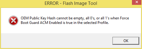

            hmm following the instructions from https://winraid.level1techs.com/t/gu...lization/31277
            and when hitting the "Build Image..." in fitc I get the following error message

                thanks for the link, I get it. As I mentioned, I am following the instructions there to the letter https://winraid.level1techs.com/t/gu...lization/31277
                after replacing the appropriate ME Region, I hit build and it showed that error.
                What allowed me to make it through is to NOT replace the ME region while keeping fitc open, but to instead quit ftic, hit save in an .xml, then replace the ME Region file, restart fitc, open the saved xml file, hit build again. That time it did not complain and effectively generated the outimage.bin.
                The step to restart fitc is mentioned here effectively https://www.badcaps.net/forum/troubl...-guide?t=88533
                I guess the fitc restart is an important step not mentioned in the first guide. Actually it tells you to do the opposite. So I leave this here to document that point :-)
                Let's see if I can now successfully reprogram and resolder that chip !
