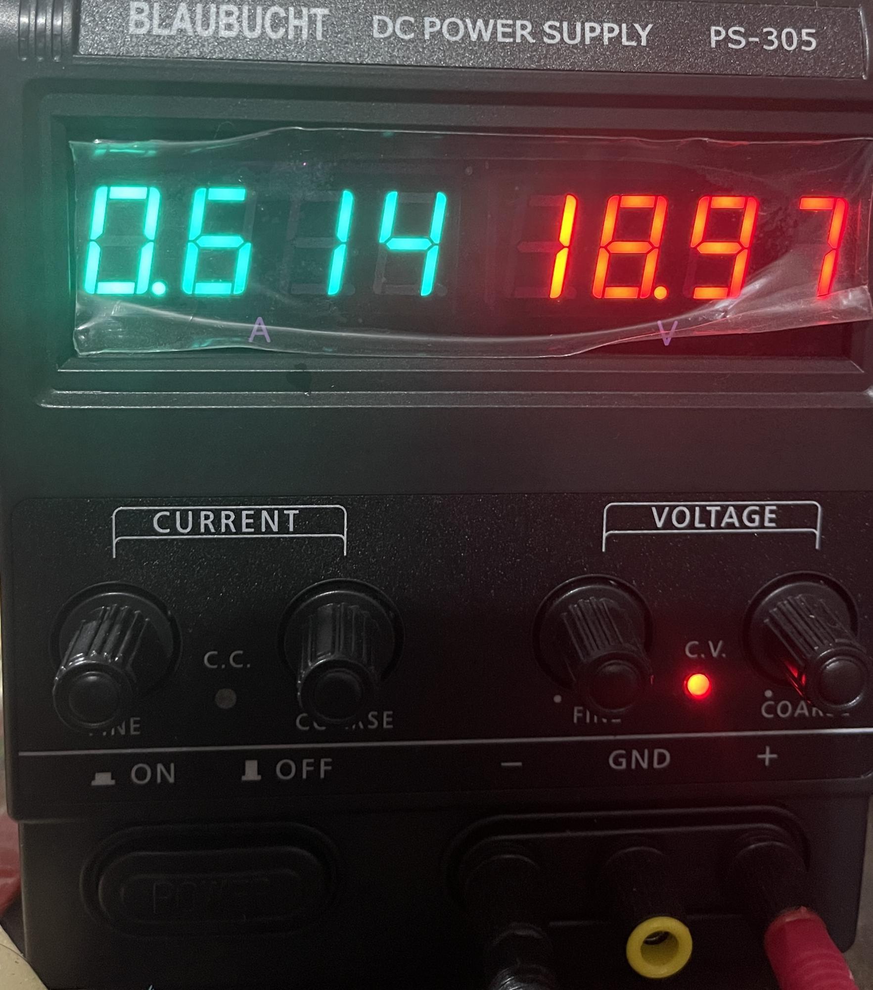

                            Im facing a power cut now. I will share photographs showing the DC unit. It take 0.605A when I power on. also will check voltages at U2301. (as I remember when I test U2301, I saw input voltages are there but enable signals were missing)
                            Unfortunately Still I wasn't able to find Q8 on my board. if you own boardview for this laptop, can you share with me please

                              Re: Dell Inspiron 15 LA-9982p No power help please
                              Are u sure laptop takes 0.6A when turned on while SUSP# is missing?? Seems like impossible to me. Had you checked Q8 is working or not. Measure voltage on U2301, PIn 1-2/13-14/6-7/8-9/3/4.. Voltage on J513(3VALW_PCH) is present??
                              I just repaired LA-9981(with graphics). Was dead. 3/5V PWM ic was corroded. Replaced this regulator. When turned on light glows but consumption moves from 0.010 mA to 0.019mA only. In my case also SUSP# was missing. Replacing U2301 fixed it. Hope this helps you but no case is same-so keep that in mind.
                              PS: No need to rest RTC section for now as it turns on and power light is glowing.
                              Voltages at U2301 after power on.
                              1,2—-> 5v
                              13,14—->0v
                              6,7——>3.3v
                              8,9——->at the beginning 0.27v and after some time it turn into 0.96v
                              3—>0v
                              4—->5v
                              5—-> 0v
                              Voltage at J513 ——-> 3.24v
                              here I attached DC unit photo also when I power on. still Im unable to find Q8
                                Q8 is located near Audio jack(between audio jack and 51225C IC). Its a 2N7002 mosfet. Just replace it with any mosfet marked 702/K72/S72 which you can get plenty from scrap boards.
                                Yes, indeed your consumption indicates a short somewhere.Under normal circumstances, when SUSP# is missing on this mb, consumption wont exceed 100mA (after turning on) as SUSP# is the enable for almost each and every IC.
                                Measure resistance on each and every coil in ohms mode without power.
                                  I replaced Q8 with S72 mosfet. Still nothing changed.
                                  when I test resistance at coils the lowest resistance I was 70ohms at PL301 and another lowest was 90ohms at PL502.
                                  I guess Thats normal. May be I was wrong.
                                  Important thing is CPU is heating. Thats the guy who takes that 0.6A after power sw on. CPU died??? or can we continue ??
