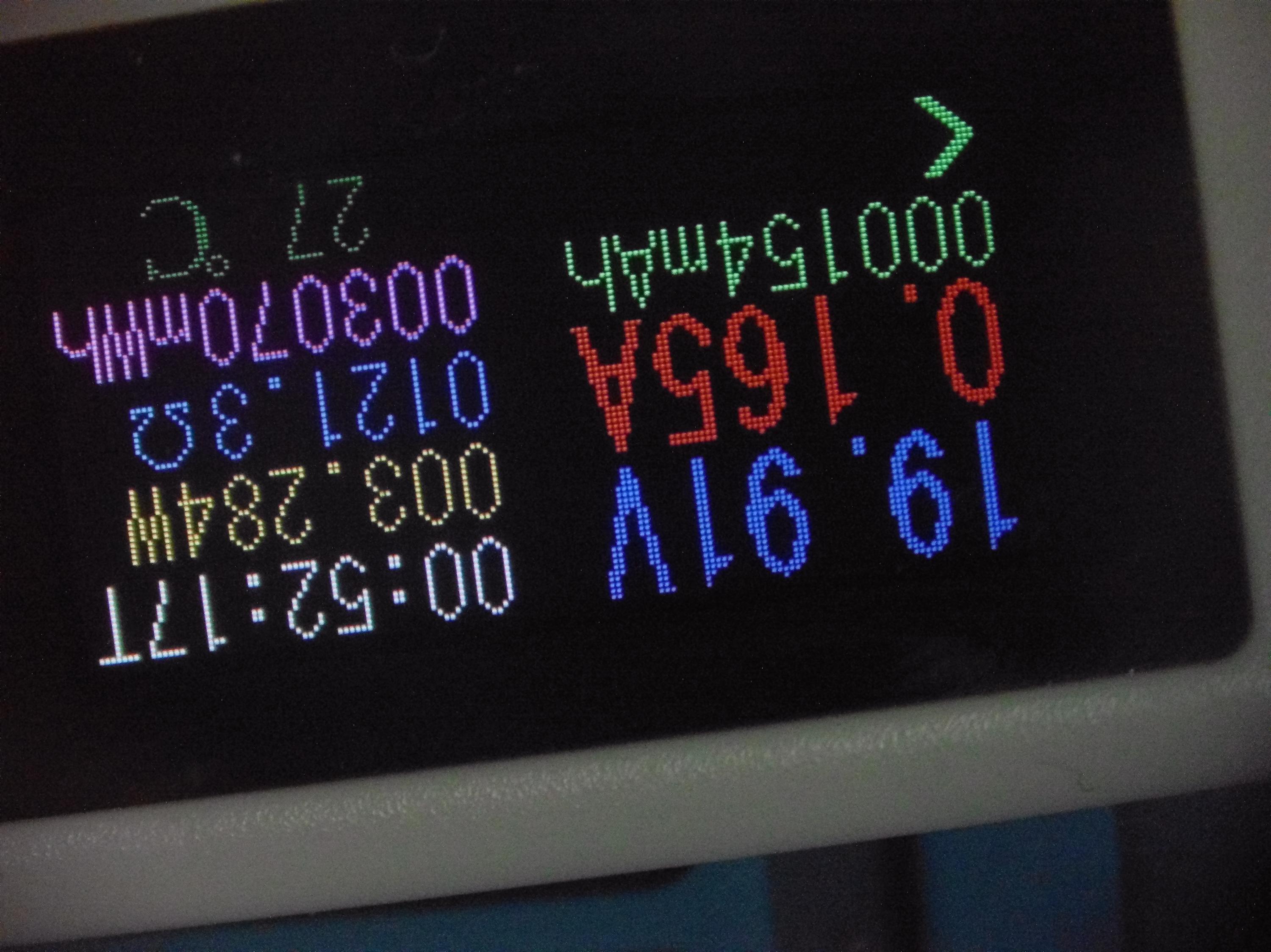

    I have this motherboard that I turn on and the ic L8 = xx heats up
    what are the 3.3v
    I press the power button and it does not heat it turns off and heats
    change the IC twice and the same thing happens
    the USB-C ammeter indicates
    19.9v
    0.080 and 0.180a
    3.3 watts
    I attach images please I need your help
    LINK IC L8=XX

    What is the question? When Inputs and Enable are fine you need to check the load side.
    Resistance to GND at LDO3 and LX?
      thanks for your help
      Resistance to GND at LX =8.7 k
      Resistance to GND at LDO3 = 2K

          Re: help da0x36mbae0 rev e does not turn on
          These are high resistance readings, there is no short on these measured rails.

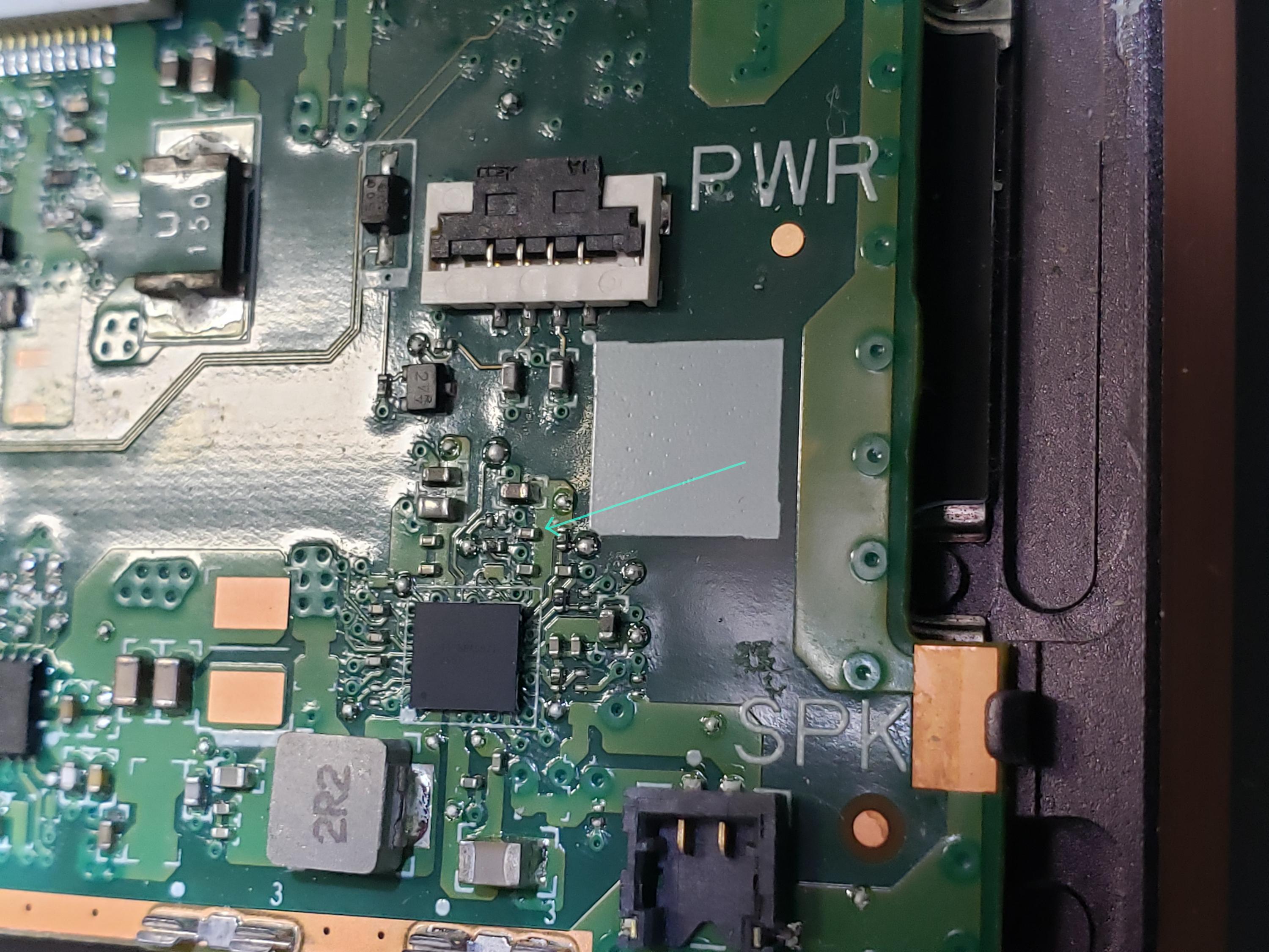

                • IDislikemakingLogins
                  • Feb 2017
                  • 38
                  • moon
                  just had one with the same fault. With the one i got the short was a cap that bridged the 3.3v and the 3.3vldo togther at the tas2557 ti 8ba6971 mono amp by the pwr connector. found by injecting 3.3v at 300ma n the ldo. cheep thermal imager and iso ftw.
                  Last edited by IDislikemakingLogins; 09-29-2022, 05:02 PM. Reason: add picture of cap
