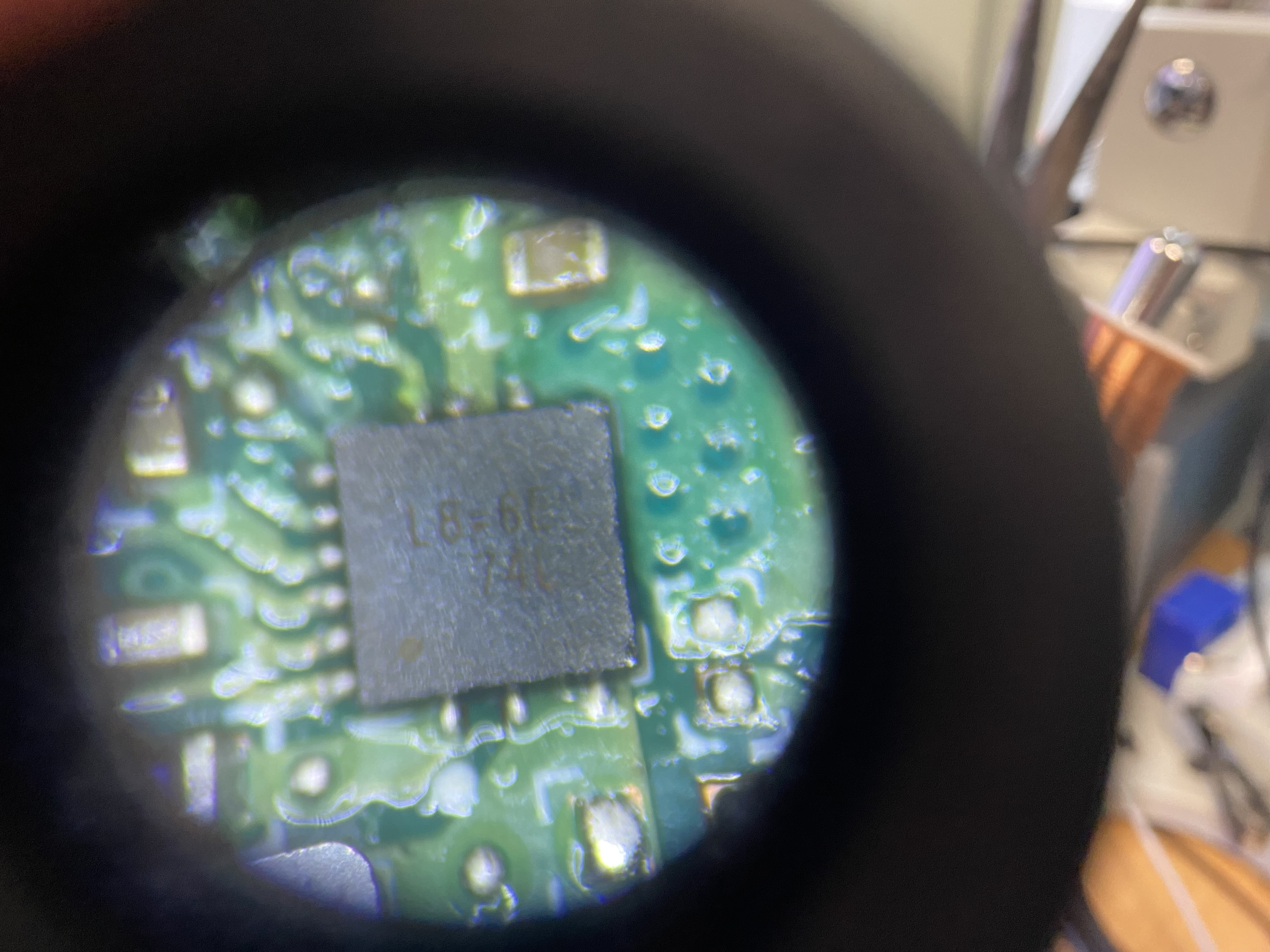

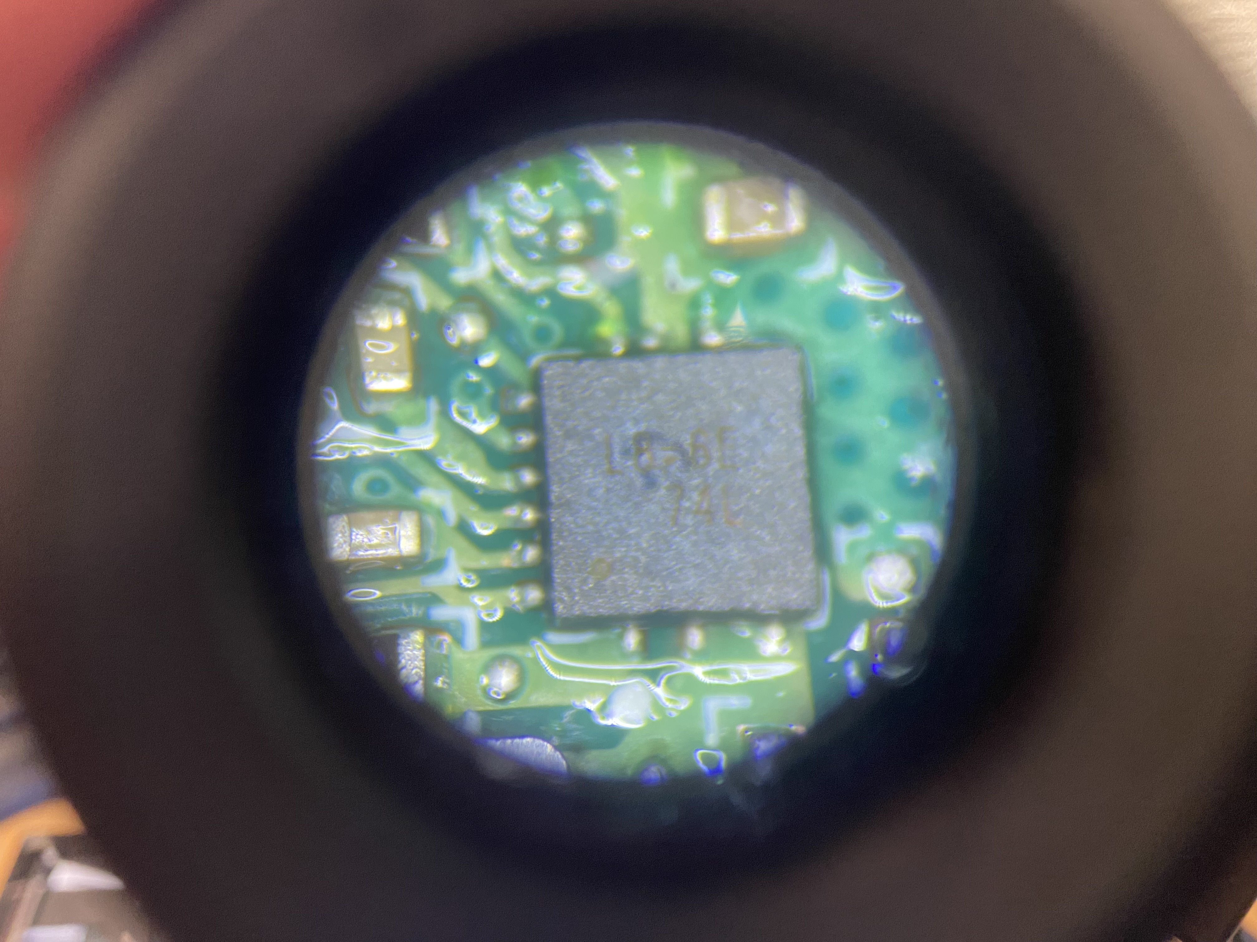

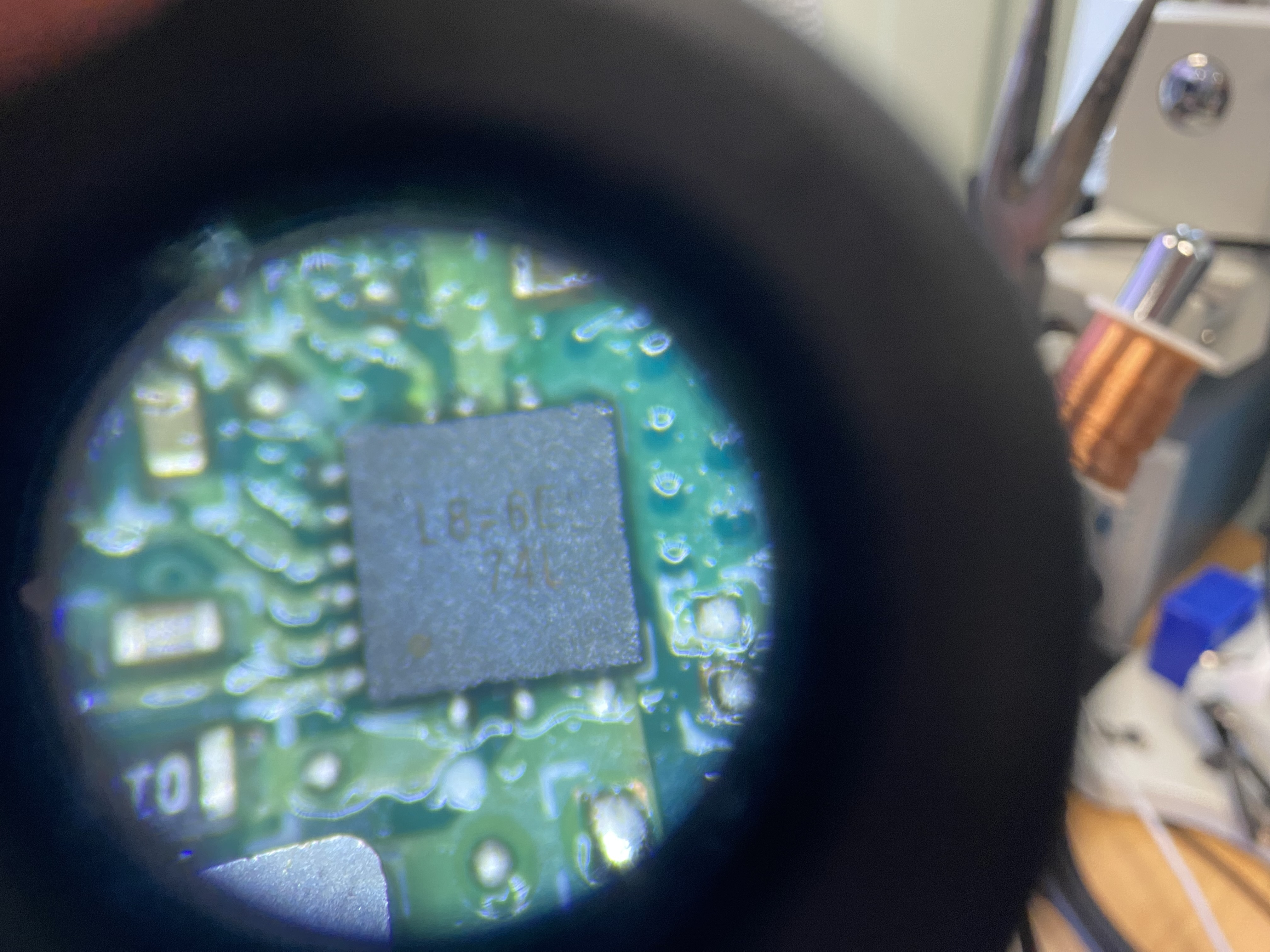

    i all,
    Cab anyone identify this chip? Pics attached. It's marked L8=6E 74L.
    History: laptop came from a e-cycler. Dropped off a few laptops wanting to get rid of them so he asked if we wanted them, apparently he tried swapping the battery on this one and acidentally broke the tip of the battery connector and plugged the battery in upside down.
    All readings on the battery pin seem normal though (comparing to a working same model board).
    Connecting the charger you can see the above mentioned chip pulsing so it looks like its going into protection mode, but checking diode mode readings everything matches the readings I get on my known good board.
    That said that does not mean the chips not faulty, so I wanted to see if anyone could identify it so I can get a replacement. Would rather not ruin a known working board.
    Thanks for your assistance.
  • mon2
    • Dec 2019
    • 14599
    Search for ‘L8= Richtek’ on google.
    Results in RT6256BGQU.

          The last pic of the chip appears to show a crack on the top of this component. This part is damaged.
          • AJ847.63e
            • Aug 2020
            • 171
            • Africa
            That was just crap from my cotton swab, took me a good 15 minutes of ipa and different variations of markers and an angled torch to try fill in the writing to make it legible.

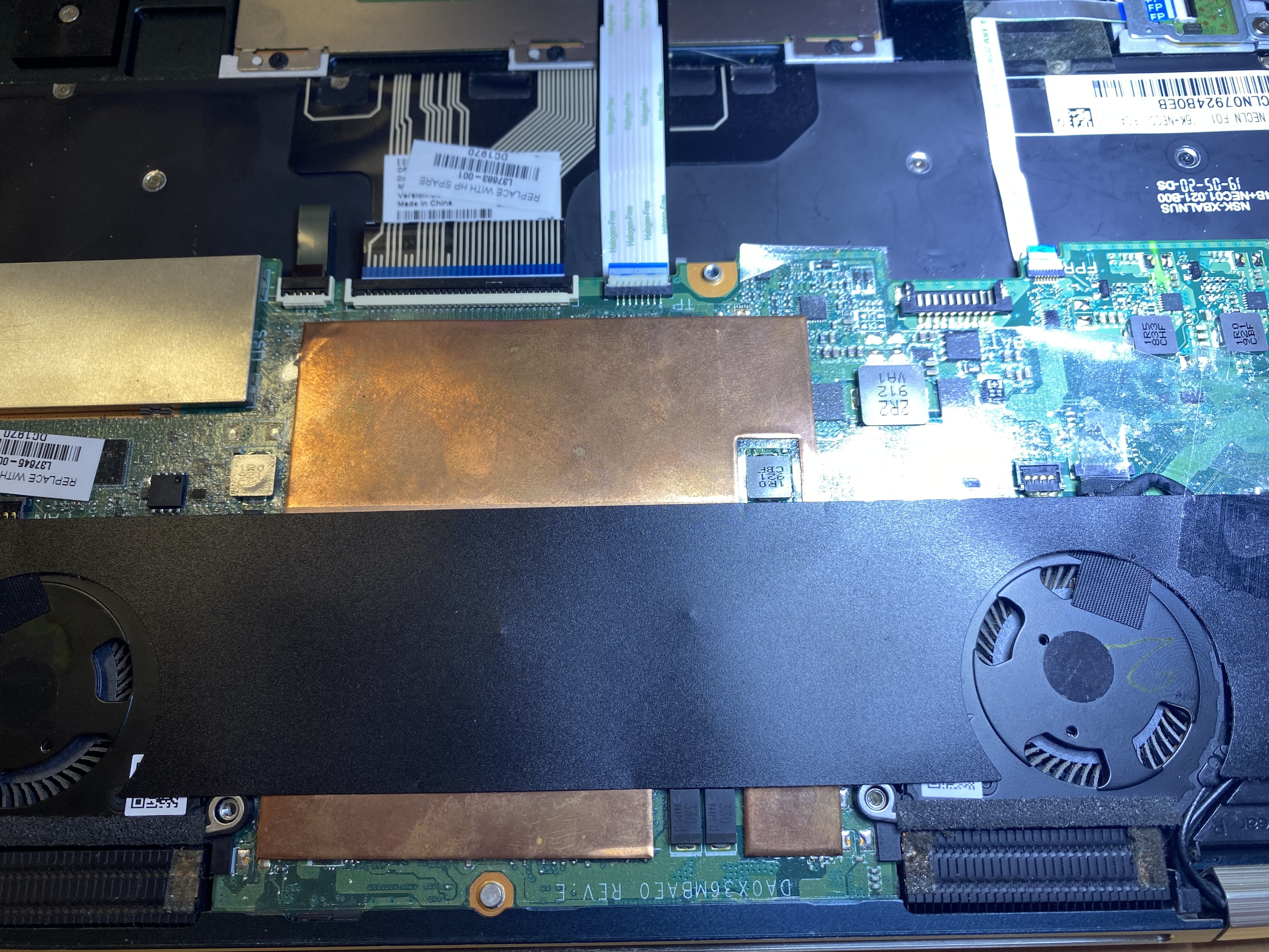

                  Looks like the PCH has been hit, popped it under the thermal cam and removed the heatsink and you can see the tip of it pulsing in sync with the LDO chip.
